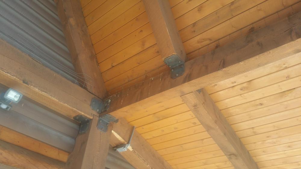

anvil Posted July 9, 2018 Share Posted July 9, 2018 Sorry, I'll stick with the kiss principal. Not meaning to argue, because you should use whatever tools and in any configuration you choose that suits you. Lol, my striker(a rare deal this day and age for any of us, truth be known) will strike how I teach him, and there will be no reason for a cut off plate. And again, no matter what, as soon as you strike your cut off plate, even Indirectly, it will draw out. Now it will no longer lay flat on your anvil face. This means every blow you make, your tool will jump and this Increases the chance of those danged double cut marks on your work. This applies especially if you secure your plate mechanically to your anvil. Here's an example of a simple cut corner. However there were a danged lot of brackets. This was one of my first jobs. I can't seem to upload more than one. This was 30 or so years ago. 3/8"*4" angle and 4"X8" flat plate. Probably 50+ brackets. I can't remember. Note the "beginner" barely champfered edges... Hot oil finish and still no rust. If I had used either a saddled cut off plate, or one that was mechanically fastened,,, I'd still be working on it!! Lol, seriously, actually, after say 3 or 4 brackets or flat plates, I'd be losing time dressing my cutoff plates made as you guys suggest. I used an 8# hammer and my first handled and curved hot cut made from a railroad cold cut. Still got it. 2 hours ago, Meadowgrove said: . I wouldn't want to risk marring my anvil face due beginner's enthusiastic inaccuracy As I said, your cut off plate is to protect your hot/cold cut from losing it's edge, not your anvil, unless you have a pretty poor anvil. Quote Link to comment Share on other sites More sharing options...
