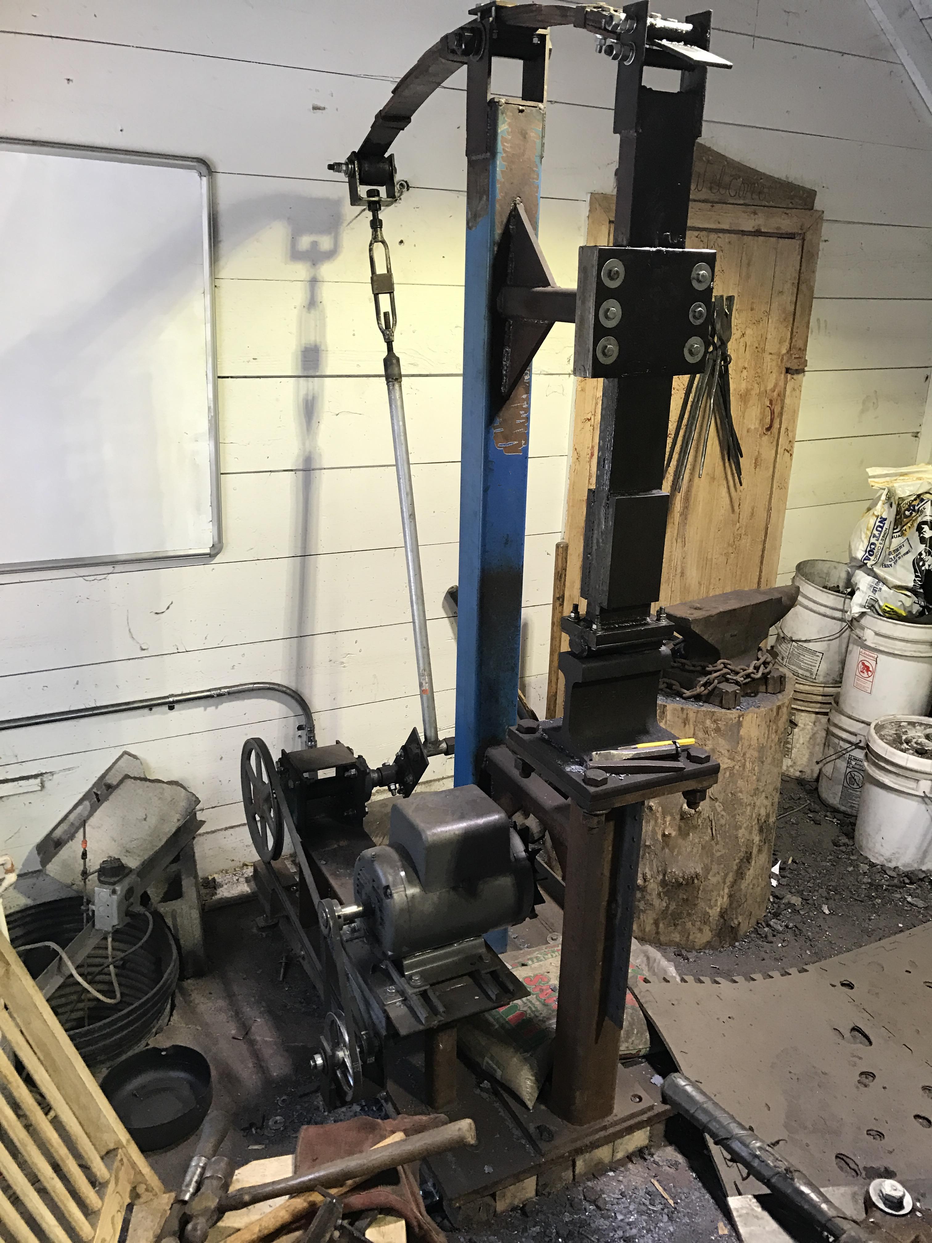

58er Posted March 9, 2017 Share Posted March 9, 2017 I like the power hammer.... Quote Link to comment Share on other sites More sharing options...
bubba682 Posted March 10, 2017 Share Posted March 10, 2017 Thxs built it from a picture we feild ran everything it took some tweeking but it works real good its a 50# head.Its ugly but real effective... Quote Link to comment Share on other sites More sharing options...
58er Posted March 10, 2017 Share Posted March 10, 2017 any more pics? Quote Link to comment Share on other sites More sharing options...

bubba682 Posted March 12, 2017 Share Posted March 12, 2017 Here some more pics of the hammer for Ya 58ER LIKE I said she aint pretty but she works sum good lol... Quote Link to comment Share on other sites More sharing options...
Frosty Posted March 13, 2017 Share Posted March 13, 2017 Kodos Bubba it ain't pretty but it'll work I LIKE it! Well done. Frosty The Lucky. Quote Link to comment Share on other sites More sharing options...
bubba682 Posted March 13, 2017 Share Posted March 13, 2017 Thxs Frosty now im just waiten for the hydrolics to come so i can build my press that will be prettier lol Quote Link to comment Share on other sites More sharing options...

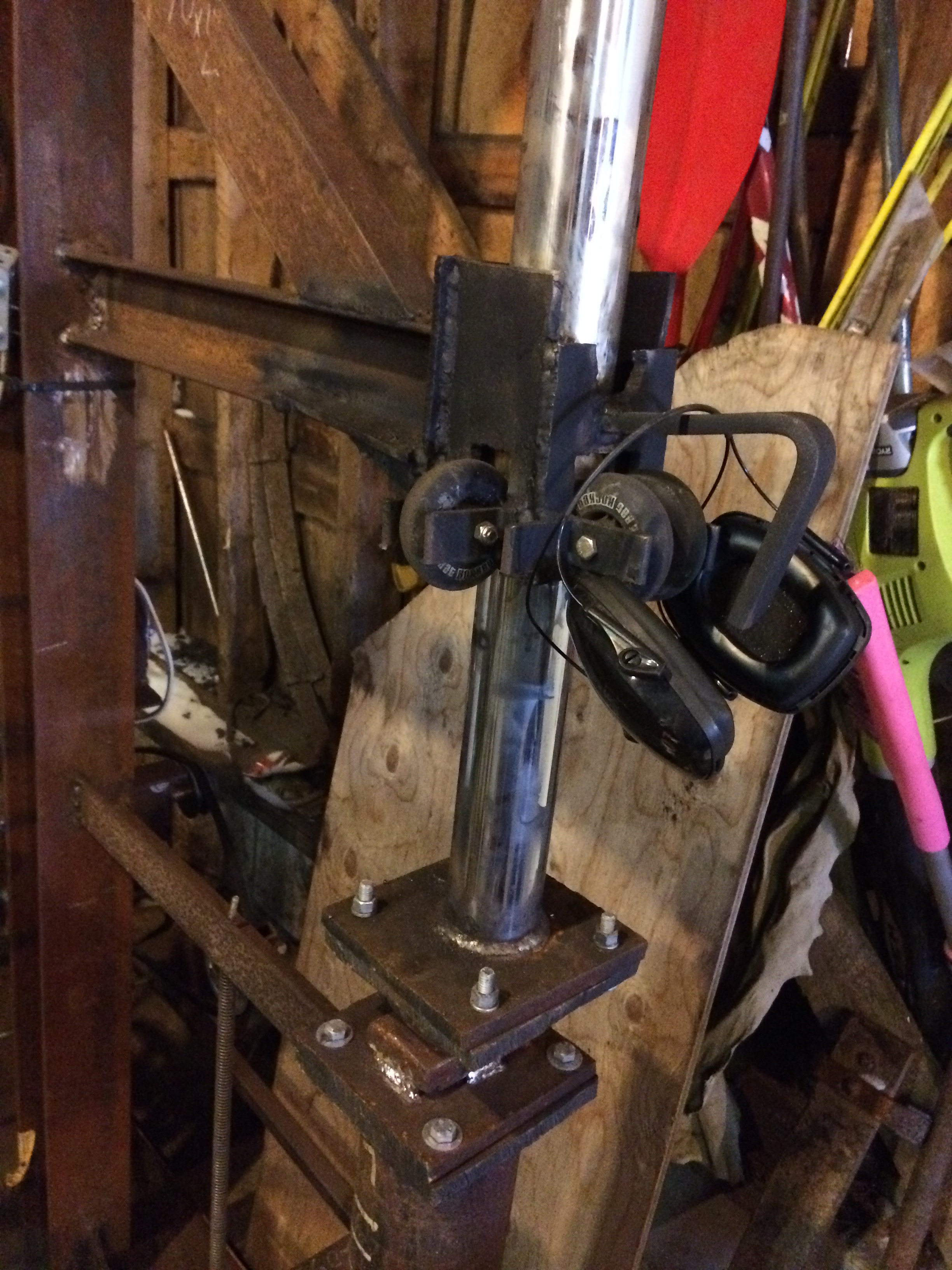

58er Posted March 16, 2017 Share Posted March 16, 2017 It looks like ours could be cousins All hollow parts are filled with sand. Quote Link to comment Share on other sites More sharing options...
Frosty Posted March 17, 2017 Share Posted March 17, 2017 That looks pretty workable, no fancy frills just basic machine. I like it. I don't see your clutch mechanism, I looked for something on the idler pully but can't see it nor a treadle. How do you drive that puppy? Frosty The Lucky. Quote Link to comment Share on other sites More sharing options...

58er Posted March 17, 2017 Share Posted March 17, 2017 Frosty. Thanks I tried the idler pulley thing and found I didn't like it. So I figured out the pulley ratio to where it hits the most consistent and installed and foot pedal and contactor to activate it. Quote Link to comment Share on other sites More sharing options...
Frosty Posted March 17, 2017 Share Posted March 17, 2017 10 hours ago, 58er said: Frosty. Thanks I tried the idler pulley thing and found I didn't like it. So I figured out the pulley ratio to where it hits the most consistent and installed and foot pedal and contactor to activate it. I must be dense I still don't understand. The foot pedal in instead of a treadle. Yes? Are you starting and stopping the motor? That would mean your hammer has one speed, X BPM, period? Frosty The Lucky. Quote Link to comment Share on other sites More sharing options...
bubba682 Posted March 17, 2017 Share Posted March 17, 2017 They are ugly cousins lol. Quote Link to comment Share on other sites More sharing options...
58er Posted March 17, 2017 Share Posted March 17, 2017 Yes. One speed. I found it worked this way the best. Quote Link to comment Share on other sites More sharing options...
Frosty Posted March 18, 2017 Share Posted March 18, 2017 20 hours ago, 58er said: Yes. One speed. I found it worked this way the best. One speed isn't uncommon. Do you just turn the motor on and off? That isn't so good for motor life you know. Frosty The Lucky. Quote Link to comment Share on other sites More sharing options...
58er Posted March 18, 2017 Share Posted March 18, 2017 motor is operated via foot pedal which in-turns operates the coil of a motor starter. Quote Link to comment Share on other sites More sharing options...
wpearson Posted March 19, 2017 Share Posted March 19, 2017 Frosty bottom right of picture Quote Link to comment Share on other sites More sharing options...
Frosty Posted March 19, 2017 Share Posted March 19, 2017 4 hours ago, 58er said: motor is operated via foot pedal which in-turns operates the coil of a motor starter. How long is a motor going to last starting and stopping under a load like that? I don't know all that much about electric motors but have always heard their life span is counted in starts not hours of running. Is there an electrician who knows the answer who could chime in please? There are a number of things I could do if starting and stopping doesn't wear them out too quickly. Frosty The Lucky. Quote Link to comment Share on other sites More sharing options...
58er Posted March 19, 2017 Share Posted March 19, 2017 I've been an industrial electrician for my entire life. As long as the duty rating and the load of a Motor are matched to its task it will be fine. If this motor had a continuous duty rating and it were substantially undersized your statement may be true. But even then I have seen motors way undersized for their tasks/duty cycles last for years. Quote Link to comment Share on other sites More sharing options...
Frosty Posted March 19, 2017 Share Posted March 19, 2017 I'll add the info to my limited knowledge base. I'm automatically skeptical of what I see, read, etc. online and seek pro opinions. ESP ECIALLY for those, "everybody KNOWS" things, those are always suspect and "what I've heard" falls in the everybody knows category. Thanks. Frosty The Lucky. Quote Link to comment Share on other sites More sharing options...
