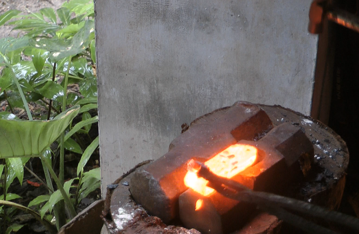

Work With Nature Posted September 14, 2017 Share Posted September 14, 2017 Just thought to post the wood fire I did today, here on this thread if you guys don't mind. I let it burn without any air from the hairdryer for 15 min and build up a lot of embers that way. See first picture. Just to say though that I did pile some new wood on top and it may be difficult to see from the pic that there is a 10 inch by ten inch blob of embers in the middle of the fire. The next couple of pics after that are the hairdryer on and some heat I got for a weld I was trying out. Quote Link to comment Share on other sites More sharing options...
ThomasPowers Posted September 14, 2017 Share Posted September 14, 2017 I like that anvil! (though vertically would be a bit more efficient.) How did the weld go? Slag; we could get into a discussion of making brass through a cementation type process; Biringuccio mentions it in Pirotechnia (1540) under the section on "coloring copper". (Smelting of zinc is difficult as it reduces above the vaporization/burning temp, in India they came up with a neat way to do it: the ore was reduced in alembics and the zinc vapor was piped into a cooler chamber kept with a reducing atmosphere so the gas cooled off and became a very fine zinc dust that could then be melted using standard techniques. "Metal Technology in Medieval India", Jafar.) Quote Link to comment Share on other sites More sharing options...
Work With Nature Posted September 14, 2017 Share Posted September 14, 2017 14 hours ago, ThomasPowers said: How did the weld go? Did a small update on the thread where we talked about it. I think I actually pulled it off. Mostly anyways Quote Link to comment Share on other sites More sharing options...
ThomasPowers Posted September 14, 2017 Share Posted September 14, 2017 cutting off a bad end is fairly common starting out... Quote Link to comment Share on other sites More sharing options...
Work With Nature Posted September 14, 2017 Share Posted September 14, 2017 Ah good to know Quote Link to comment Share on other sites More sharing options...
ThomasPowers Posted September 14, 2017 Share Posted September 14, 2017 Remember being an expert smith doesn't mean you don't make any mistakes as much as it means you know how to recover from making them or hide them! Quote Link to comment Share on other sites More sharing options...
