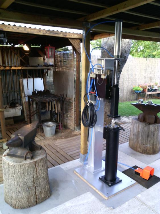

Hans Richter Posted September 27, 2017 Share Posted September 27, 2017 Hi Gents, Also try to made some rail road anvils just for fun and a good friend of my. After all, quit satisfied with the result. Not really suited for de heavy work but still useful for noble blacksmith work like trinket, arrow points, pendants and maybe knives. Some words about the suitability of rail road tracks for small anvils. The manganese steel of the rail profile top get chock quenched and the rest of the heat annealed the body of the rail. This made the running surface of the rail hard and durable to prevent to worn out, and the body of the profile ductile to absorb the beats of the train (hammer?). However the same as your professional anvil have to do (please, is there someone to explain me the rebound question ) Your feedback is very welcome. Cheers, Hans Quote Link to comment Share on other sites More sharing options...
Charles R. Stevens Posted September 27, 2017 Share Posted September 27, 2017 I would suggest adding an upright section of rail about the same size or an upright round or square drop to provide an anvil for heavier forging. Quote Link to comment Share on other sites More sharing options...
Hans Richter Posted October 17, 2017 Share Posted October 17, 2017 Hi Charles, thanks for feedback and sorry for my delayed reaction. Of course if you have no other option, an upright part make sense. In my case I take advantage of this 3 beauty’s for heavier forging. B.t.w. after my information a rail road rail is hard on the surface and ductile (soft) in his foot section. How do you deal with that without beating deep dents in it (hardening!?) Quote Link to comment Share on other sites More sharing options...
Charles R. Stevens Posted October 17, 2017 Share Posted October 17, 2017 Now your just trying to make me envious! Lol. Induction hardening isn't neir the issue as if work harnpdening. But in either case, even the as forged state of a rail it's 9 point carbon and a lot harder than hot steel That said, beutiful machine work.all the labor is expensive, why not invest in having an anvil cut from 4" of 4060 of some such, and then machine and heat treat? The material costs are nedligible compared to the labor costs. I bet you could come up with a beutiful run of anvils. And after having a whole plate cut up the material costs per anivil would be very low. Quote Link to comment Share on other sites More sharing options...
