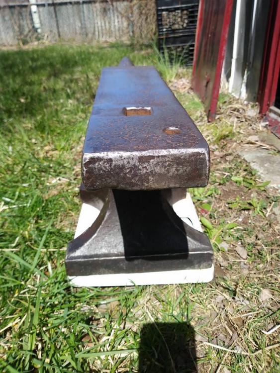

JustAnotherViking Posted April 16, 2018 Share Posted April 16, 2018 52 minutes ago, Two4mirth said: there's a serious depression in the top as you can see in the picture Where? I can see a small bit of sway, but for a PW, that's virtually nothing. Link to comment Share on other sites More sharing options...
Two4mirth Posted April 16, 2018 Share Posted April 16, 2018 Thanks... I'll bring a bearing with me and test it before I decide. I felt the price was fair, I just was unsure about the depression. I understand that a anvil that age will show wear. Just how much is acceptable is my concern. 20 minutes ago, JustAnotherViking said: Where? I can see a small bit of sway, but for a PW, that's virtually nothing. That's what I wanted to hear! Thanks Link to comment Share on other sites More sharing options...
ThomasPowers Posted April 16, 2018 Share Posted April 16, 2018 Old English anvils sometimes had the face welded on in segments: I see a horizontal line that may be one of these welds as they often wear differently from the rest of the face (perhaps from decarb of the thinner weld scarf making a slightly softer "line") Looks to be a good usable anvil and having some sway can be very handy for bladesmithing as it helps in straightening if you are used to it. Anyone tells you it would be improved by milling or grinding or welding the face flat: Drop the anvil on them!..........beep beep! Link to comment Share on other sites More sharing options...
Two4mirth Posted April 16, 2018 Share Posted April 16, 2018 I did have concern with that horizontal line. I have been researching, and understand not to grind or weld the face. I would prefer something with character anyway. I just needed the opinions of folks with experience in these matters. I can only research so much, but without experience, i have little to base my decision on. Thank you again everyone. I hope it is still there tomorrow. Link to comment Share on other sites More sharing options...

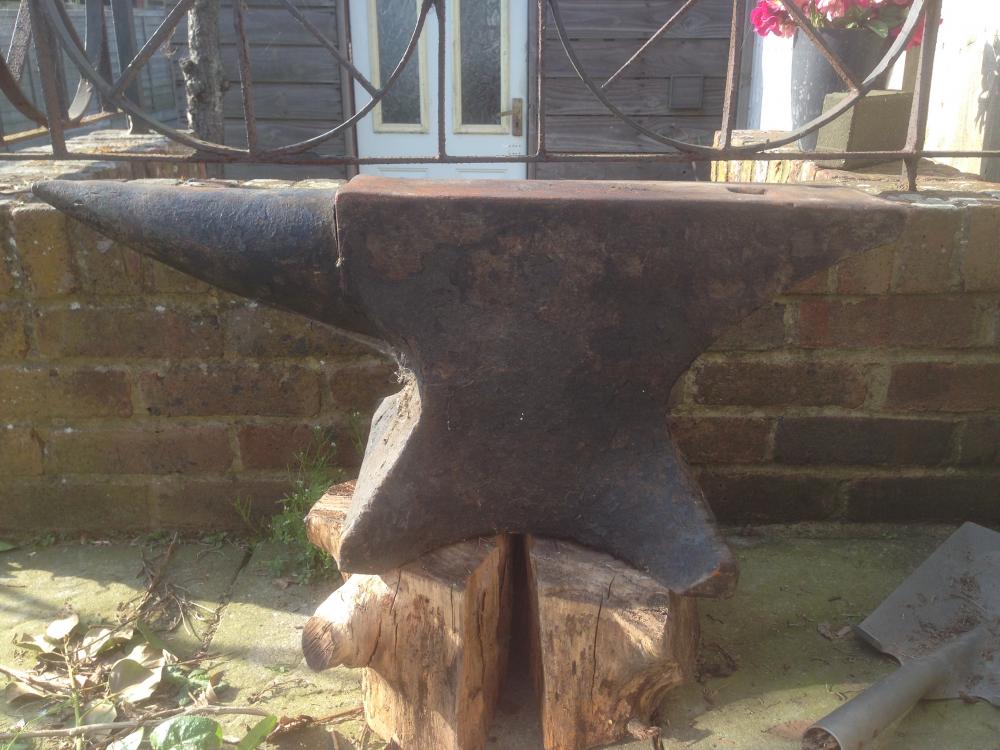

JRich Posted April 21, 2018 Share Posted April 21, 2018 My anvil. No idea what make it is or where it originally came from. They had it at my work to bend sheet steel on occasionally but it was in the way and heading for the scrap, so it disappeared one day and turned up in my garden! Link to comment Share on other sites More sharing options...
Daswulf Posted April 21, 2018 Share Posted April 21, 2018 It's in excellent shape J. What the rebound on it? Link to comment Share on other sites More sharing options...
JHCC Posted April 21, 2018 Share Posted April 21, 2018 Very nice. Note that the absence of a cutting step makes this a “Birmingham pattern” rather than a “London pattern” anvil. Link to comment Share on other sites More sharing options...
JRich Posted April 21, 2018 Share Posted April 21, 2018 Didn’t know it wasn’t a London pattern! Not sure what you mean by rebound yet, still learning all this stuff! It rings nice and even. Link to comment Share on other sites More sharing options...
