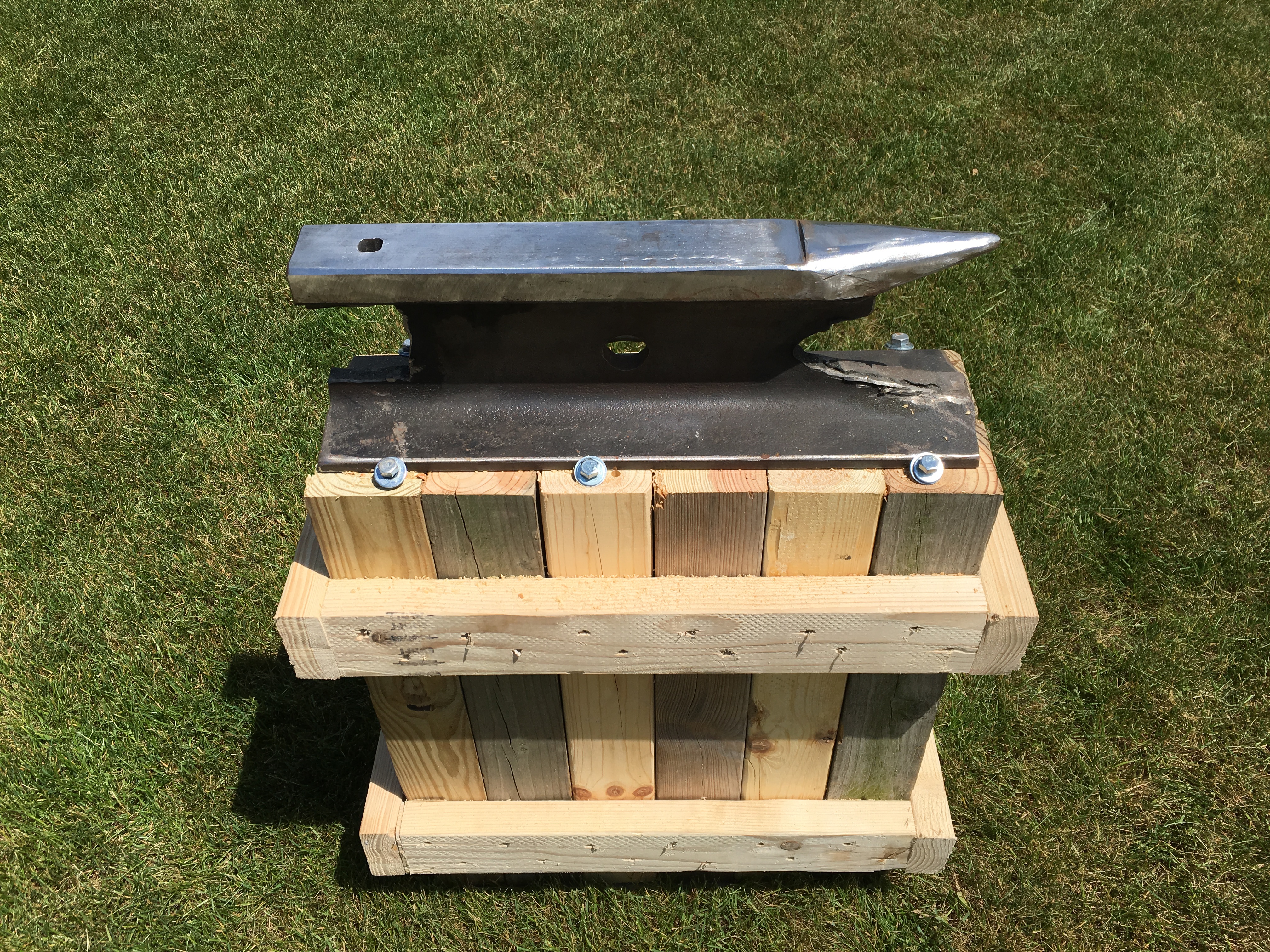

Nice looking little anvil. You can drill the flange as well and screw it directly to the stand, it'll be a little more secure. You were able to drill the hole to pilot the hardy because whoever ground the contact surface to make a flat face ground through the induction and work hardened surface. I don't know of a way to reliably harden and temper the rail without running some risk. "The Complete Modern Blacksmith" by Alexander Weygers has a prety complete section on using rail for anvils and includes good instructions for heat treating it.
I was worried about losing the hardness too but honestly in the month I've been working with it, it's been absolutely solid. I was prepared to harden it but so far I haven't found a reason to. I don't know if it came out of the fact of its heavy use or what but the machinist that ground down the face said he came to the conclusion that the two hardest substances he knew of was carbide and whatever the hell this was. I have TCMB it's a great book and I recommend it to anyone looking to start.

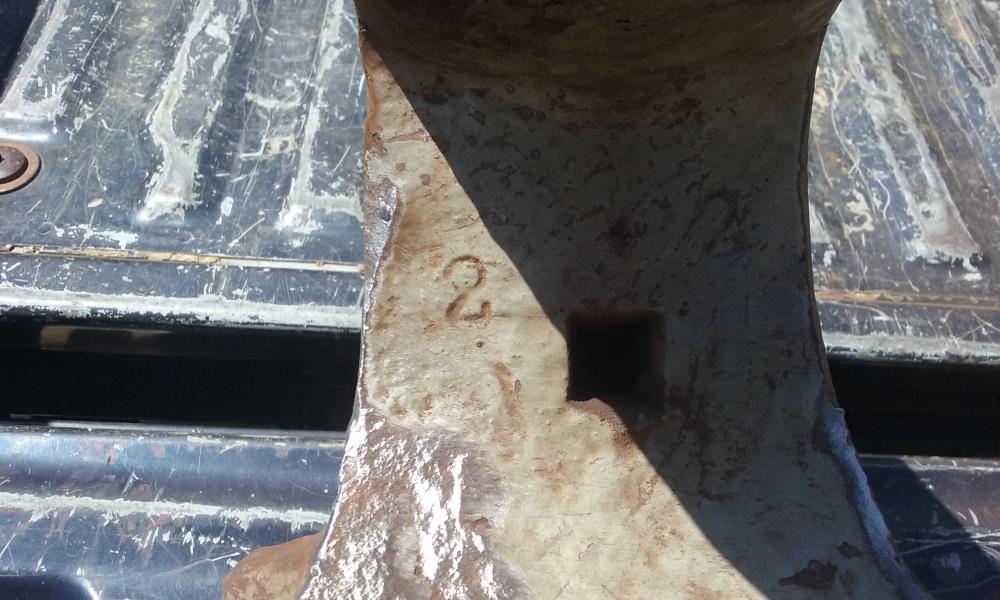

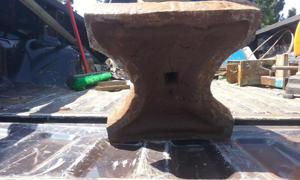

I signed up here several years ago and haven't been involved much, but now I'm back. I got this at an auction yesterday. It is covered in several layers of paint that I'll be working to remove over the next few days. I have no idea what it is, yet. I have found a couple 2's stamped by the tong holes under the horn. These are the auction listing photos, I'll post more up as I get it cleaned up.
A bit of history on this. This was the mechanic's anvil when I hired onto the fire department 23 years ago, I have no idea how long it has been here. I'd always hoped I'd get the chance to own it, now I do. It has been sitting in storage for several years and I never saw it get used much before that.
