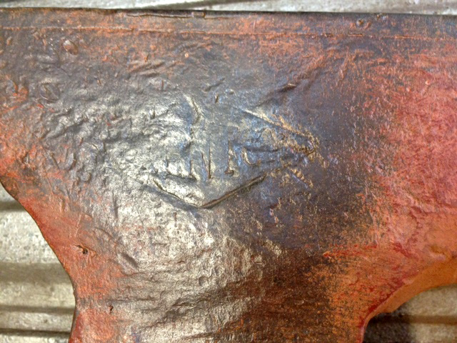

I just acquired my Grampa's old anvil from my Dad. Looks like it's a Trenton. The numbers across the front foot are - Z80  A81974. I thought the * after the A was a 3 at first, so I thought it was made in 1902, but when i looked real close, I could just see the imprint going around the circle. So it being an 8, I don't know when it was made. Maybe 1908 or 10?
11 hours ago, ThomasPowers said:
Is that a sticker on the side with the name?    The Fisher Museum guy here probably can narrow down when it was made...
It is... well half a sticker. It was njanvilman's Fisher thread that got me to my late 50's 60's estimate... but beyond that, I don't know that there's any year to year identifier. It probably doesn't matter much for a relatively modern, mass produced anvil. I do like the way it works though.
John In Oly,
Can you take a closeup of the side logo stamp of your red Trenton anvil?  I'm cataloging a database of the different Trenton logo stamps vs. the serial number ranges, would love to add yours to the list!  Thanks!
