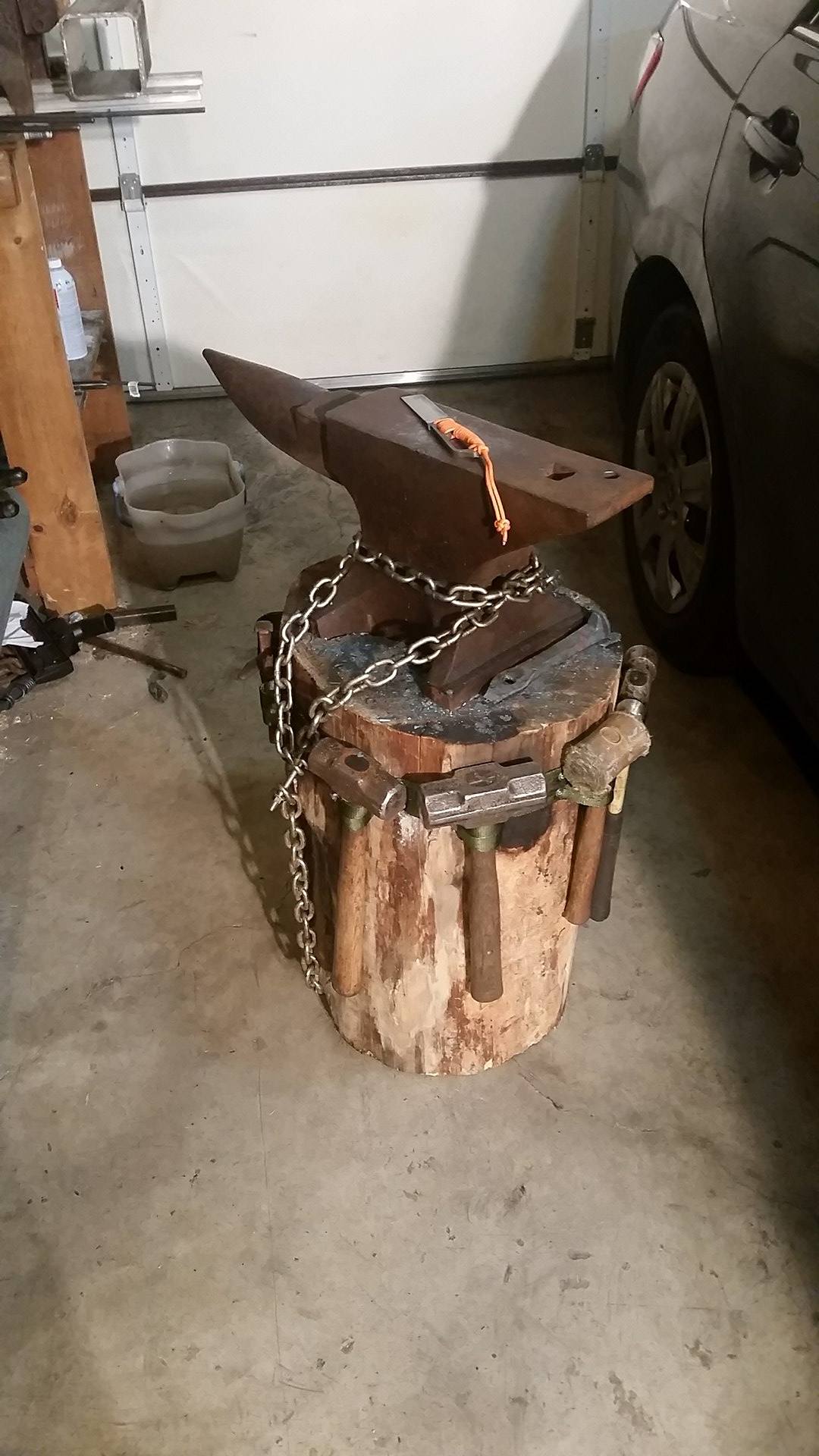

CoyoteGear Posted March 10, 2016 Share Posted March 10, 2016 128# Peter Wright, I leveled the bottom of the stump with a router and then also put a 1/4-1/2" footprint into the top of it to hold the anvil, I noticed that after I tightened the chains down that it went from being a high ping to being a very solid whack, the rebound is excellent and for being from the late 1800's I'd say it is in excellent shape! oh and the webbing is 2" nylon webbing to keep hammers close at hand. Still on the lookout for a little larger anvil, but this one has been great to learn on and continues to serve me well Blade on top was my first attempt at a tonto blade. Quote Link to comment Share on other sites More sharing options...
Glenn Posted March 10, 2016 Author Share Posted March 10, 2016 1 hour ago, CoyoteGear said: 128# Peter Wright, Still on the lookout for a little larger anvil, but this one has been great to learn on and continues to serve me well What has this anvil NOT been able to do? Quote Link to comment Share on other sites More sharing options...
swedefiddle Posted March 10, 2016 Share Posted March 10, 2016 Good Morning, Coyote, It looks like it hasn't been able to go to School and Learn to be a Big Anvil. Chains and Leg-Irons. Just kidding........ That Beauty will do all the work you ever ask of it. It is a mind War, needing a bigger Anvil There is a normal size for a WorkShop, Too Small. There is a normal size for a Sail Boat, Needs to be 2 feet longer. Neil Quote Link to comment Share on other sites More sharing options...
ThomasPowers Posted March 10, 2016 Share Posted March 10, 2016 Anvil Envy: an expensive neurosis prevalent amongst blacksmiths wherein they believe that no matter how large their anvil is; bigger would be better. At 128# I consider that around the top size for a travel anvil and with it's good sized sweet spot it will do a heck of a lot of work! My 93# Arm and Hammer is mounted right by my 515# Fisher in my shop as bigger is not always better just as dead flat is not always better---the swale on my A&H is far better for straightening blades than the dead flat Fisher. OTOH the Fisher excels at working high alloy steels with heavy hand hammers! Quote Link to comment Share on other sites More sharing options...
CoyoteGear Posted March 10, 2016 Share Posted March 10, 2016 17 hours ago, Glenn said: What has this anvil NOT been able to do? Nothing yet, I just need one more than I have.... as I always will I keep a wad of cash in my wallet and a ball bearing in every car just in case I come across a good deal.... or any deal really.@swedefiddle, do you ever come down into the states? I see that you are not that far away. Quote Link to comment Share on other sites More sharing options...
