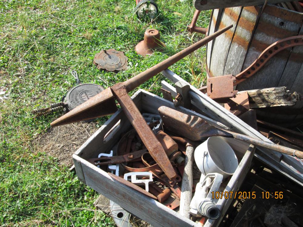

Randy Bill Posted October 18, 2015 Share Posted October 18, 2015 Pexto 925 Blow horn stake anvil in situ. Now home with me; hand wire brushing and steel wool are revealing traces of original(?) green paint. Never in my wildest dreams did I envision finding this in the middle of the prairie. I'd appreciate any input from those familiar with these, thanks. Link to comment Share on other sites More sharing options...
Glenn Posted October 18, 2015 Author Share Posted October 18, 2015 Great for thin tin, not so much for heavier material. It will still work, but you must be careful how heavy handed you are. Link to comment Share on other sites More sharing options...
JHCC Posted October 18, 2015 Share Posted October 18, 2015 (edited) Pexto 925 Blow horn stake anvil in situ. Now home with me; hand wire brushing and steel wool are revealing traces of original(?) green paint. Never in my wildest dreams did I envision finding this in the middle of the prairie. Good find on the Griswold waffle iron, too -- collectors love those. Edited October 18, 2015 by JHCC Link to comment Share on other sites More sharing options...
BIGGUNDOCTOR Posted October 18, 2015 Share Posted October 18, 2015 JHCC, I see I'm not the only one who spotted the waffle iron. The Griswold, and Wagner items I inherited from Mom get used all the time.On the PEXTO stake, never put it in an anvil hardy hole. The taper can break the heel of the anvil like a splitting wedge. Link to comment Share on other sites More sharing options...
Randy Bill Posted October 18, 2015 Share Posted October 18, 2015 Thanks gents. Sorry, I didn't grab the cast iron stuff; it's still there (over a year now), a half-dozen of them and other like cast cooking irons on and around that particular pallet. Sheep are slowly rubbing this several acre site and it's treasures into the sod. A plumb 1425 shrinking hammer shows in the box and came home also, next trip i'll grab the coal scoop. An observation on the stake: it's consistently as dead as a doornail when checked with a 1" bearing ball whether hand-held, rested on an anvil, or clamped in a vise. I'd guess rebound at 15 to 20 percent, weight of stake is 17#. Imagine hardness isn't the same requirement here as we're used to with forging anvils? Indeed, I won't be tempted to use it for iron; just some informal tapping revealed the strangest feeling of working on a spring! Am working on a dedicated stand w/stake pocket and will be doing some head-scratching trying to figure out height... Link to comment Share on other sites More sharing options...

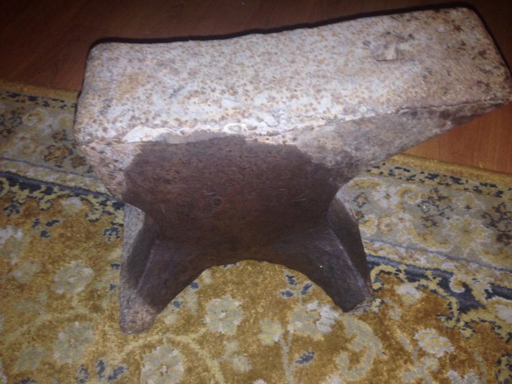

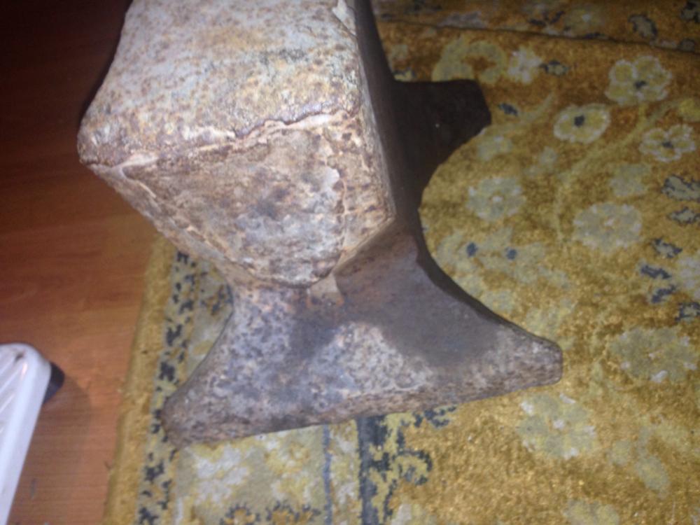

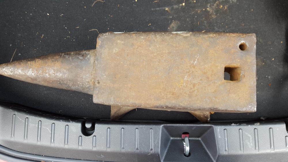

Frozenthunderbolt Posted October 18, 2015 Share Posted October 18, 2015 (edited) Edited October 18, 2015 by Frozenthunderbolt Either forged or cast with a welded hard face - 60ish KG Link to comment Share on other sites More sharing options...
Frosty Posted October 19, 2015 Share Posted October 19, 2015 (edited) That stake isn't an anvil, it's a tin knockers tool intended to form sheet metal. It should be polished shiny and used with primarily, mallets: wood, leather, lead or plastic. This is the sort of tool the traveling tinsmith would use to make your great grandmother a funnel.Other stakes in the tinker's wagon would be: creasers, snarling irons, seamer, dapping block ball or mushroom stake, etc. They were called tinkers because that's the sound their work made, tink tink tink.Nice score.Frosty The Lucky. Edited October 19, 2015 by Frosty Link to comment Share on other sites More sharing options...

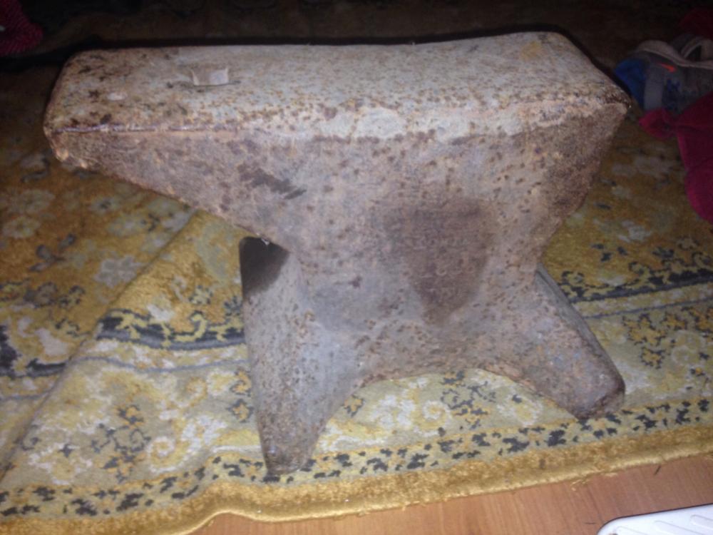

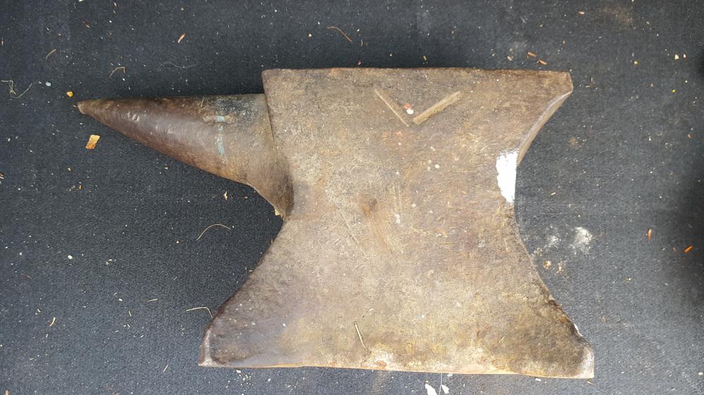

falsevacuum Posted October 24, 2015 Share Posted October 24, 2015 (edited) Bought this anvil this morning. 113# per a scale, $300.I don't see any marks aside from the V shape on the side. It looks old though!Now I just need to whip up a stand! I plan to use this anvil for striking, since I already have an anvil I use for 1 person forging. Edited October 24, 2015 by falsevacuum Link to comment Share on other sites More sharing options...
ThomasPowers Posted October 24, 2015 Share Posted October 24, 2015 "V" looks like it was added later; does look old. Does the pritchel look drilled rather than punched? I'm thinking it might be a retrofit and that's a pre-1820's anvil Link to comment Share on other sites More sharing options...
falsevacuum Posted October 26, 2015 Share Posted October 26, 2015 "V" looks like it was added later; does look old. Does the pritchel look drilled rather than punched? I'm thinking it might be a retrofit and that's a pre-1820's anvil The pritchel hole is SO much cleaner than the hardy hole. The hardy hole is an uneven mess inside, the pritchel hole is quite straight and clean. So my guess is: yeah, it was drilled. Link to comment Share on other sites More sharing options...
VaughnT Posted October 26, 2015 Share Posted October 26, 2015 I'd be hesitant to use that ol' gal as a striking anvil. The top is in rather pristine condition and it wouldn't take but one slip with a sledge to take a sizable chunk off of it. Link to comment Share on other sites More sharing options...
ThomasPowers Posted October 26, 2015 Share Posted October 26, 2015 Lovely pre 1820's anvil---good conformation for a heavy work anvil---thick waist; little overhang. It's yours and you can use it as you like. Link to comment Share on other sites More sharing options...
falsevacuum Posted October 26, 2015 Share Posted October 26, 2015 I'd be hesitant to use that ol' gal as a striking anvil. The top is in rather pristine condition and it wouldn't take but one slip with a sledge to take a sizable chunk off of it. I won't be using more than an 8lb sledge, and probably not too agressively either (swinging from the side, not over the head). If I end up going heavier, I'd go find myself a steel block to use. Hopefully nothing bad happens!Lovely pre 1820's anvil---good conformation for a heavy work anvil---thick waist; little overhang. It's yours and you can use it as you like.Thanks for the info! That's pretty exciting and I'll do my best to take care of and put to work this piece of history. Yes, that was one of my first reactions seeing that: little need to worry about taking off the heel! I think I should still be careful around the horn though. Link to comment Share on other sites More sharing options...

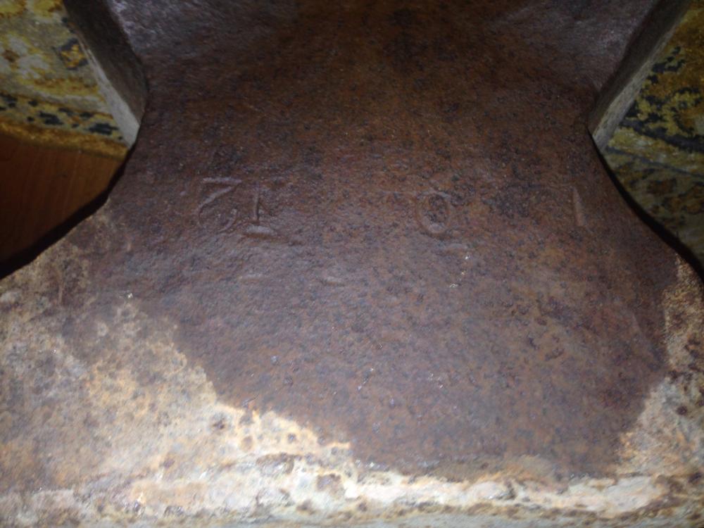

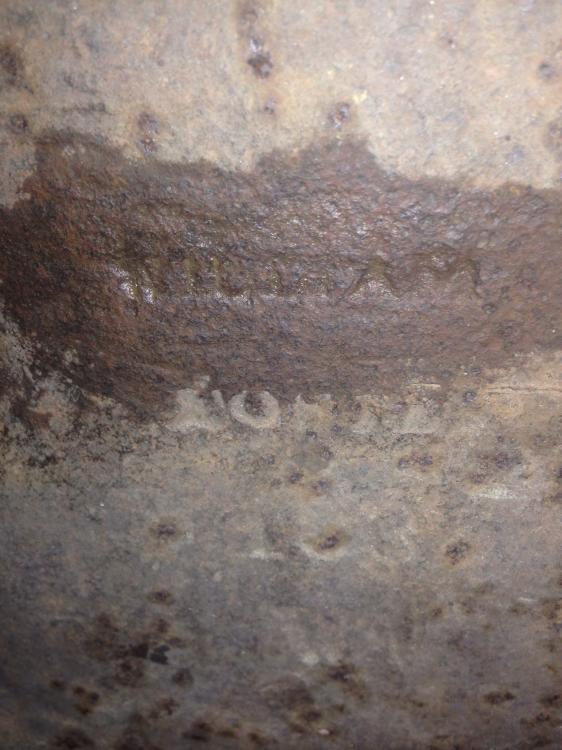

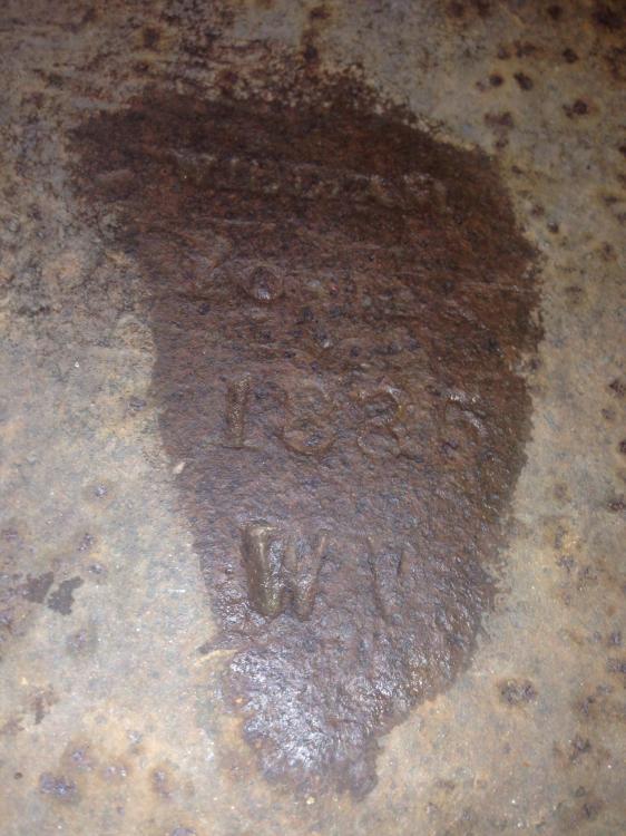

Tim Kenney Posted November 3, 2015 Share Posted November 3, 2015 Just found this. The horn is broken. The only thing I can make out for sure is 1835 WV. Maybe the name william? It's right at 110lbs without the horn. Link to comment Share on other sites More sharing options...
