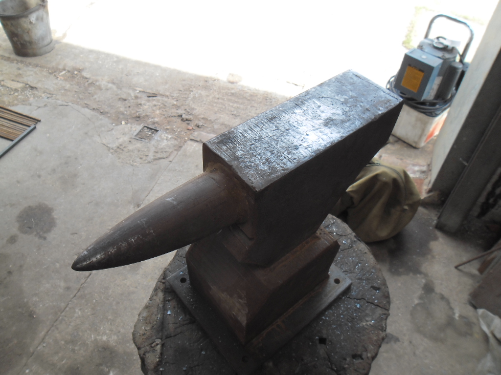

First the disclaimer.  I was not the one who welded on this girl, but I did cut the angle iron legs off and mount it the way it is now. One thing I can be sure of is that I did not overpay for it.  It only cost me a little effort to get it off the truck.  In all the pics I've seen here or elsewhere I've still not seen another like this.  It appears to have been manufactured without a base.  Anyone know why?
