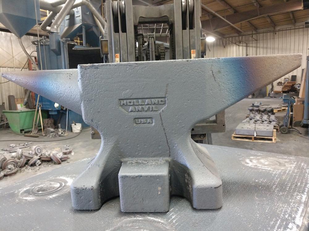

foundryguy Posted April 23, 2018 Share Posted April 23, 2018 Thank you, it's been fun but alot of work and expense making them. Quote Link to comment Share on other sites More sharing options...
jlpservicesinc Posted April 23, 2018 Share Posted April 23, 2018 More expensive than previously anticipated? Quote Link to comment Share on other sites More sharing options...
foundryguy Posted April 23, 2018 Share Posted April 23, 2018 The heat treat bills are killers and there is no way around them to do it right! Mill, drill and polish is a bit time consuming as well. 8640 would save me a bunch of cash at heat treat but I am going to stick with my H13 program. Quote Link to comment Share on other sites More sharing options...
jlpservicesinc Posted April 23, 2018 Share Posted April 23, 2018 Good idea.. Anvils should last many lifetimes and if it's a good design the little bit softer face isn't a big deal for a skilled smith.. I've worked on mild steel with no ill effects as long as there are no bad hammer blows but this is the same as a 60RC anvil face it just means instead of having a dent you have shrapnel and a mini explosion in the face of the anvil instead.. When do we get to see the 2X horn model? Quote Link to comment Share on other sites More sharing options...
foundryguy Posted April 23, 2018 Share Posted April 23, 2018 Pattern is done so I should be able to pour one late this week or early next. I will get a photo out once I have a casting. Lots of interest in it and doing one in that shape in the 225 lb range. 400 lbs is not a big casting for us so it should work fine. Quote Link to comment Share on other sites More sharing options...
jlpservicesinc Posted April 23, 2018 Share Posted April 23, 2018 I am interested in seeing what you come up with.. If you are still accepting patterns to pour I might go that way.. Looking forwards to both models.. I'm not a fan of a completely flat face.. Do you need to have it machined before heat treat? Or could the face be left as cast? Quote Link to comment Share on other sites More sharing options...

foundryguy Posted April 24, 2018 Share Posted April 24, 2018 Frosty, thank you for the kind words. My lady is good with a camera and the sound is super cool for sure. Cheers 12 hours ago, jlpservicesinc said: I am interested in seeing what you come up with.. If you are still accepting patterns to pour I might go that way.. Looking forwards to both models.. I'm not a fan of a completely flat face.. Do you need to have it machined before heat treat? Or could the face be left as cast? The as cast face is drafted from the center line outward, it is drafted for molding. It is also a cast, rough finish. I would like to help you out but not sure it would be an ideal set up. I can shoot you a pic if you care to see it. Quote Link to comment Share on other sites More sharing options...

foundryguy Posted May 4, 2018 Share Posted May 4, 2018 Here is our newest creation. Poured yesterday. H13 tool steel, 450 lb casting. Quote Link to comment Share on other sites More sharing options...
JHCC Posted May 4, 2018 Share Posted May 4, 2018 Impressive! Has it been ground & heat treated yet? Quote Link to comment Share on other sites More sharing options...
