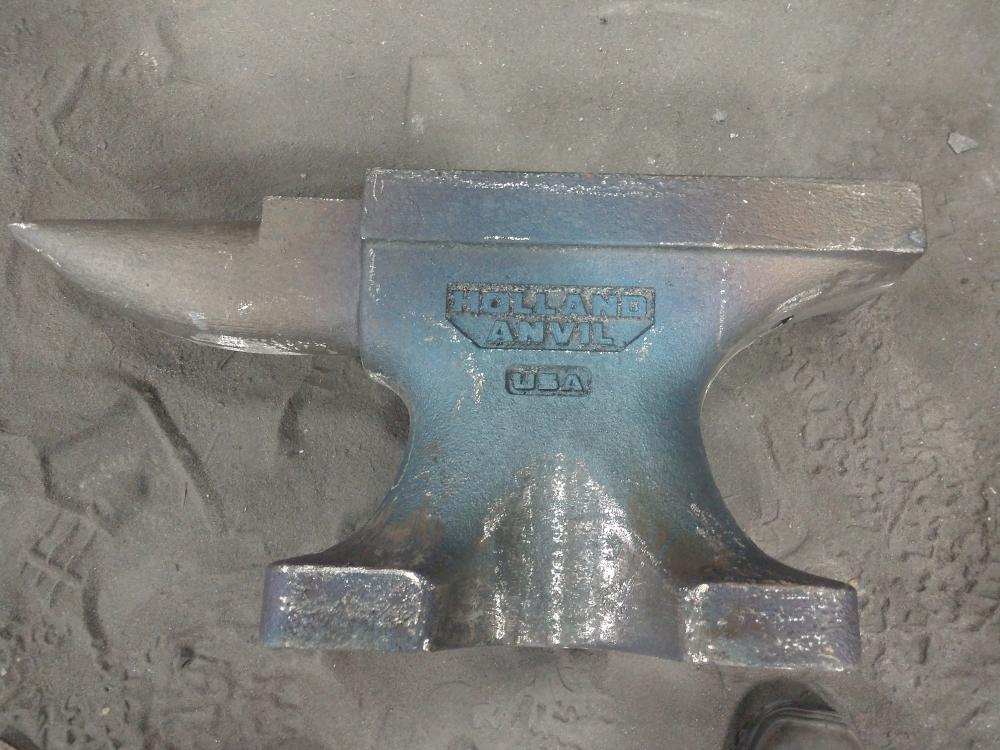

My first 200 lb H13 anvil casting. 198 lbs before machining. Anxious to get this tool completed
A great accomplishment!  I'm really happy to see her come into the world and looking forward to seeing what you come up with next.

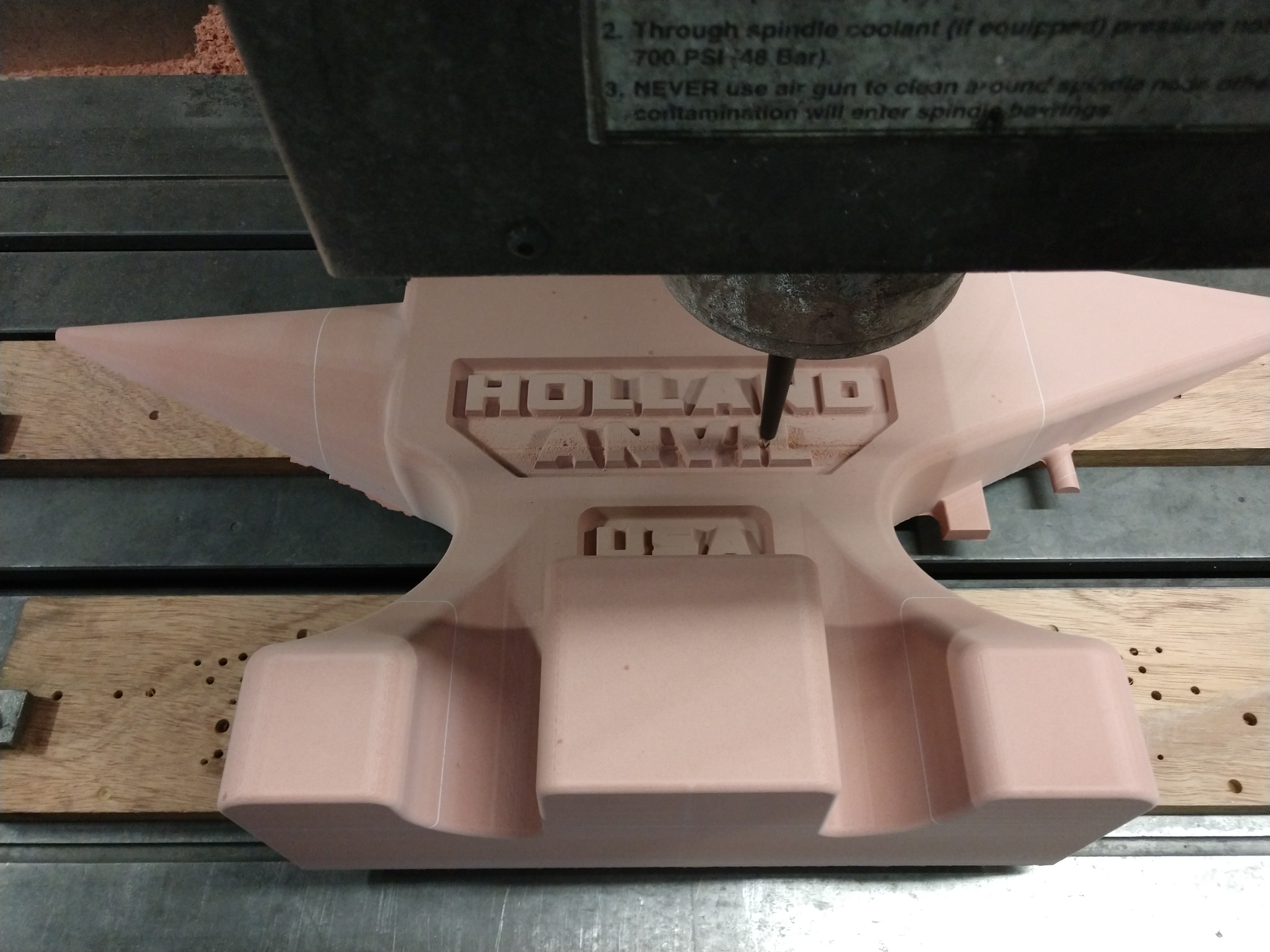

My 400 double horn is taking shape. CAD says it will come in at 420 raw weight so finish weight should be in the 405 range. Shelf is on the opposite side of the step seen here.
Today I am going to reduce the size of the badge. My design guy got carried away as you can see on the photo. The casting photo is my 200 and I plan on making the same badge size and depth. I think we scaled it up on the computer and it is overwhelming in my opinion.
The hardy and hole will be on the same end as seen by the core prints. Hoping to cast the hole like the hardy as drilling through this much H13 is not fun.

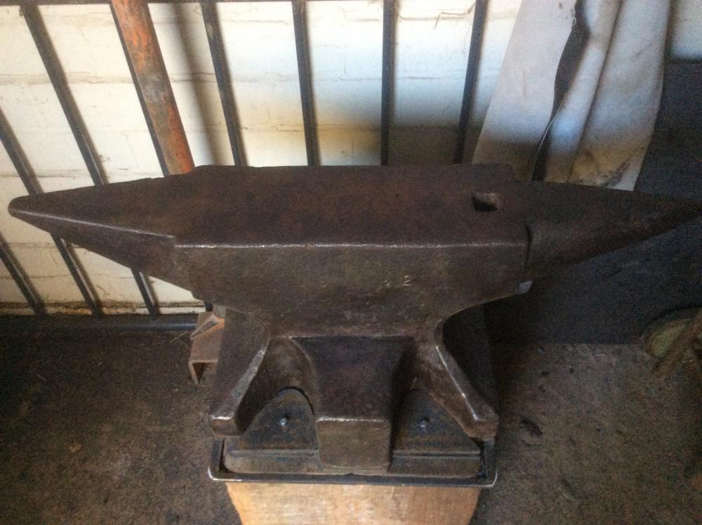

Foundryguy,  It looks great..     Personally I want an anvil that doesn't have a demarcation between the body of the anvil and the horn..    This demarcation limits the use of a hammer as you get closer to the horn while using the horn..   Also 2 hardie holes vs 1.. With anvils in this size range the pritchel hole becomes over sized and making an insert or using a punch block becomes more productive..  and No factory chamfer of the hardie holes..
I've been using the Peddinghaus 275 for awhile now and found it lacking in the areas stated above..  The other major down fall with the Peddinghaus is the fact that both the pritchel and Hardie hole comes out over the feet.. This keeps longer stock from being able to pass the feet.. You can see in the Refflinghaus that both holes are moved away from the feet thus allowing for the bars to pass by easily..
 was going to draw pictures but why when there are pictures all ready..  Adding in your own spin is great.. an upsetting block on both sides would be nice also..
Last pic is the 275P..
Along those same lines, I don't want the top overhanging the sides, as it is in the smaller Holland. It looks like it's been taken care of in the 400, which is good. A continuous side at right angles to the top is extremely useful, especially for making right-angle bends.

I can not rework the tooling at this point other than the reduction of my badge or it will be 2019 before I can make a casting. Too many opinions led me in too many directions on this site and others. Ask 100 Smiths and I get 199 different answers. A perfect anvil to one person will have a dozen flaws or errors to the next person. Its kind of like comparing a Chevy to a BMW. Neither is perfect that is why I own both! :D
On the little 85 lber, i found the pattern and only added the name and hardy. I plan on changing the name to Holland Anvil instead of my company name.
What is ASO? I did not follow that? My anvils are cast solid and hardened throughout, not a surface hardening. I added the name in a recess so it can not be easily removed by someone.
Also, in the last photo JLP posted it looks like the hardy does not go through the anvil at all and if it did it a long shaft would hit the base? Maybe its a camera angle?
I also had several people direct me to put the upsetting block and the shelf on opposite sides unlike the photo above. They called it a knuckle buster? It is a bit more difficult to cast but we did make that change.

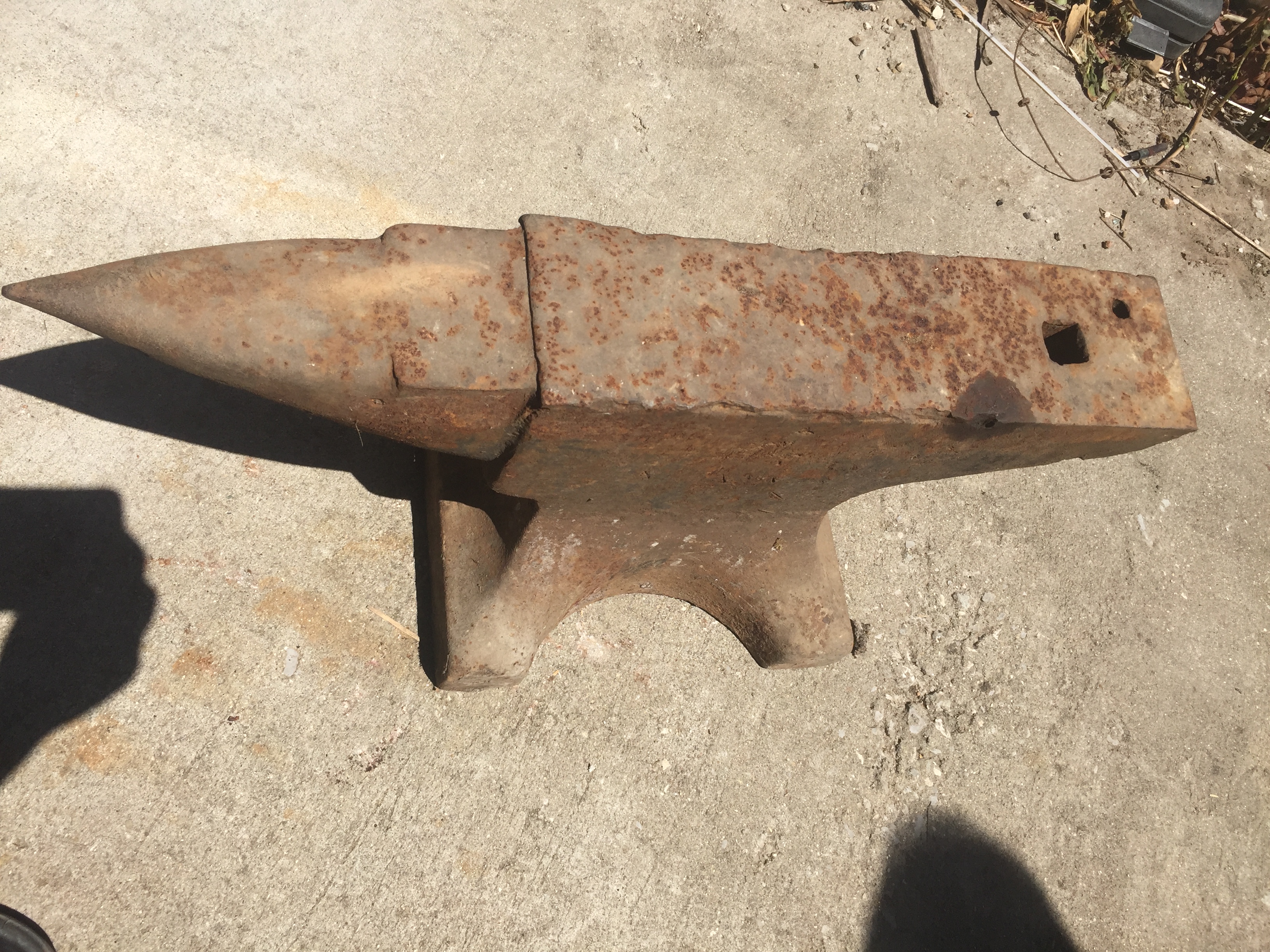

I'm just about to purchase this Peter Wright.   I'm 49 years old, and I have been interested in blacksmithing my whole life. When I was eight I used to walk to my mothers hair salon after school and next-door was a Blacksmith hammering  away in a 10 x 10' shed.   It's only now in life that I have an opportunity to explore this. I found this Peter right in a  fleamarket. He's asking $400.  it's about 150 pounds. I love the anvil, but there's a serious depression in the top as you can see in the picture. There is some level area still. Any thoughts?
Welcome to the forum. Depending on where the anvil is located $2.60 U.S. per pound is not a bad price as long as the ring & rebound are good. If you get it please do not do any milling or grinding on the face which will basically ruin a usable anvil.
I always suggest reading this thread to get the best out of IFI.
https://www.iforgeiron.com/topic/53873-read-this-first/
Check the ring and rebound over the whole face of the anvil. If it's pretty dead in that area might have more issues then just the depression. If it still rings around that area has good rebound it'll make a fine usable anvil.
