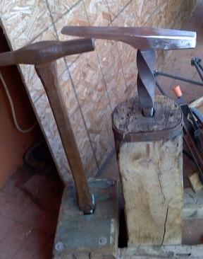

ThomasPowers Posted April 21, 2020 Share Posted April 21, 2020 In my smithy we would call that a reversed incised twist. If you do a lot that length you can make a hardy block to work them on. Making incised twists is one of the reasons I have a chain hold down as I noticed that with someone holding I could generally do one side in one heat; but with it free floating I took several heats as a lot of time was wasted chasing the piece. My chain hold down has a piece of 1/2" sq stock on the "free" end so I can step on it with my foot mainly on the ground to have a stable stance for working rather than a stirrup. The sq stock is 22" long so it will accommodate a bunch of different thickness work pieces before I need to adjust the chain length. Lovely tentacle! I could see it displayed wrapped around a Barbie doll wearing a bikini... Quote Link to comment Share on other sites More sharing options...

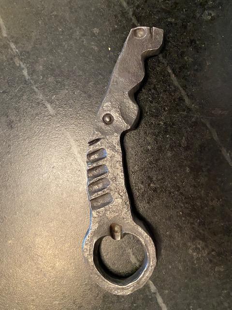

Momatt Posted May 15, 2020 Share Posted May 15, 2020 Friend gave me the springs and sway bar from his high school car, a 1983 cutlass. I cut the end of the sway bar off and tried to leave it recognizable as possible. A heavy duty opener for sure. He will be delighted. Quote Link to comment Share on other sites More sharing options...

ThomasPowers Posted May 28, 2020 Share Posted May 28, 2020 $20 as a starter and more for ornamented ones! I've find wrenches pretty often at the scrapyard. Particularly after a move or estate "clean out the garage". I keep the unplated ones for stock and hang the plated ones up on a garden rack mounted to a set of shelves. Top english, bottom metric, no whitworth! I'm ready for the Grandkids to visit and start losing my tools! (My good ones are hidden away in a drawer...) I bend the times up a bit more using the stake anvil on the left. Cheap rakes cold, good rakes hot. Quote Link to comment Share on other sites More sharing options...

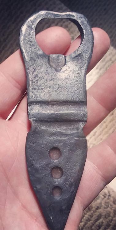

bluerooster Posted June 7, 2020 Share Posted June 7, 2020 Here's my first attempt , and of course I go about it the hardest way possible, From starting with a 3/4" bolt, and flattening the head..... I'll do it differently next time. It came out all wonky, and I don't have a bottle to try it on. (time for a store run) Quote Link to comment Share on other sites More sharing options...

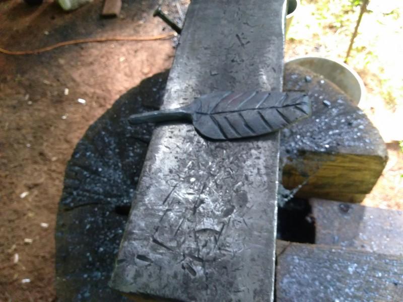

bluerooster Posted June 23, 2020 Share Posted June 23, 2020 Tried a leaf shaped one. Made from a chunk of re-bar. Now I need to go get a bottle, to open. Quote Link to comment Share on other sites More sharing options...
