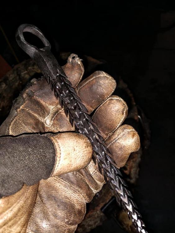

Here's another variation on the 'cobropener'. I wanted to get a scale pattern … this done with a cutting wheel, nicks on each edge and twisted tightly. Mouth takes  bit of tweaking but it works!

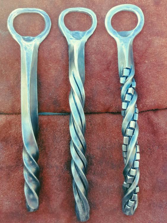

Did you get the "stairway" twist by only cutting it on two sides like half of a cube twist?  Nearly forgot to mention how nice and clean they both look. Was the copper done with a brush at heat?
Pnut
Edited by pnut
Yes, the stairway twist (others might have a different name) has a light line cut down each face and then cuts made to meet those lines on two opposite corners only. The cube twist is done cutting in from all four corners. And yes, the gold is just a bit of burnishing with a fine brass brush (copper is a bit dark) while the steel is hot. Black heat only - red will vaporise brass.
ausfire, nice, especially the bottom one. I  like the way the top edge of the diamond splits, almost evenly, and moves around the top of the opener. That's a very subtle detail that really catches the eye. A small teardrop punch would clean that up nice. The devil's in the details.
I'm a big fan of being "on the diamond". It's a simple detail that separates forged from fab work. That "trick" even puts a simple "s" hooks into a category far above cheap imports turned "on the flat".
