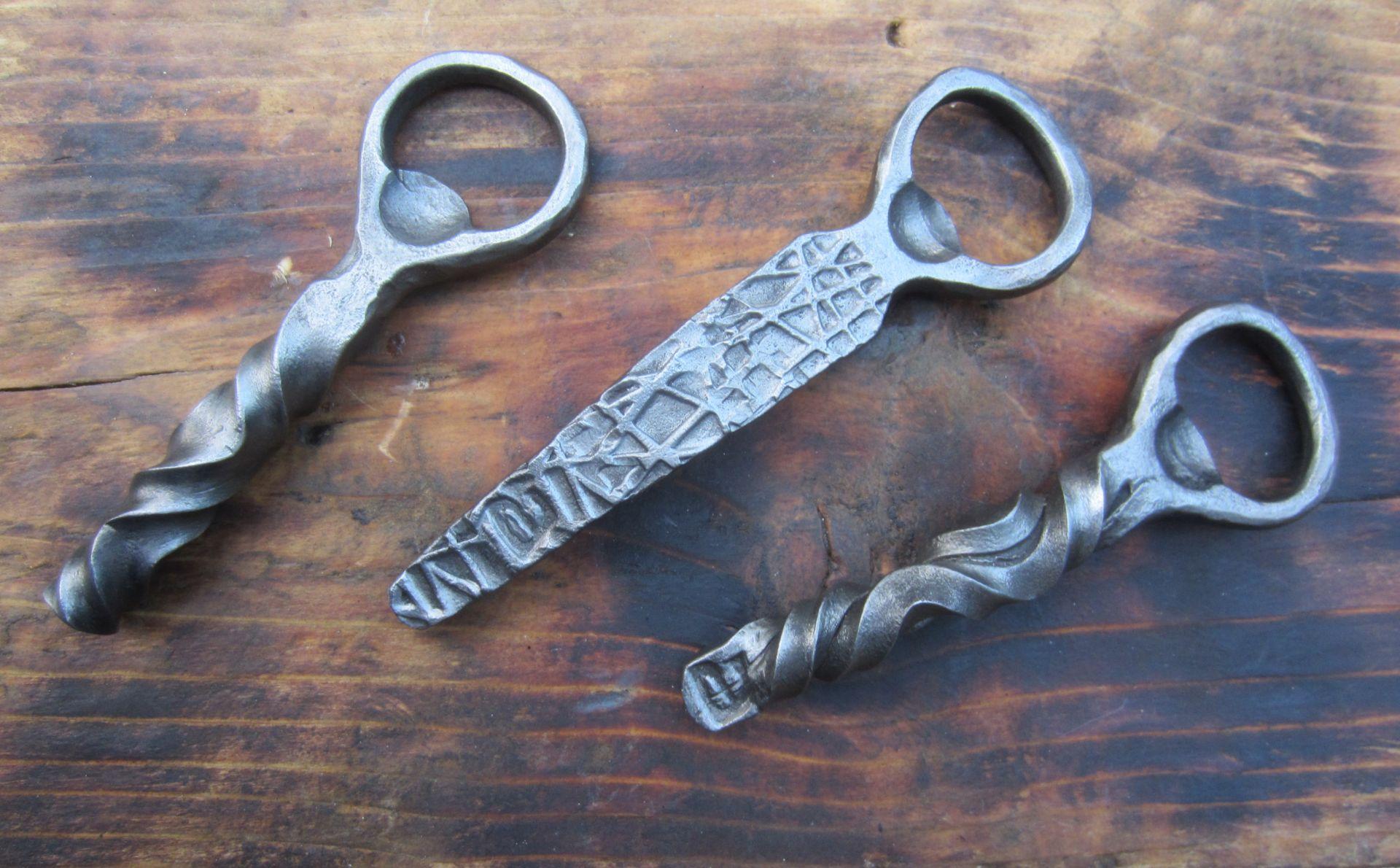

Just forged my first ever! Actually, it's two of the first things I have forged at all.
They were forged from 14x14 mm bar and finished with boiled linseed oil. They turned out quite small but the "hole" was a bit too large. On top of that, only the one to the right worked (even if I burned it a bit) since the left one couldn't grip onto the cap with its tiny scroll. It also bent since the whole thing was too thin for an "open" loop.
Anything to keep in mind when forging bottle openers? I could use a bit of help as you can see...
Each time you make one, make a mental note of what you'd like to improve/what didn't work/what worked well... next one, apply your observations.
No magical formula, just practice, practice, and more practice.
Don't forget about the most important step once you have finished forging for the day: Quality control... be sure to crack open a cold beer or six, just to make sure the opener works ;)
Don't be afraid to file, sand, or grind your opener (or any other project) before applying a finish. The rough texture around your opener on the right could have been smoothed out to present a nicer look without detracting from its hand-hammered appearance.
Punches will serve as a drift to open up your hole until you can get a purpose-made drift, just be sure to cool them after drifting. If you have an anvil with a horn, the point of the horn/bick can be used to round out the loop. I will usually flatten the top of the loop by hitting down on the bottom of the opener. In your case, you'd need to finish the loop before doing the leaf.
