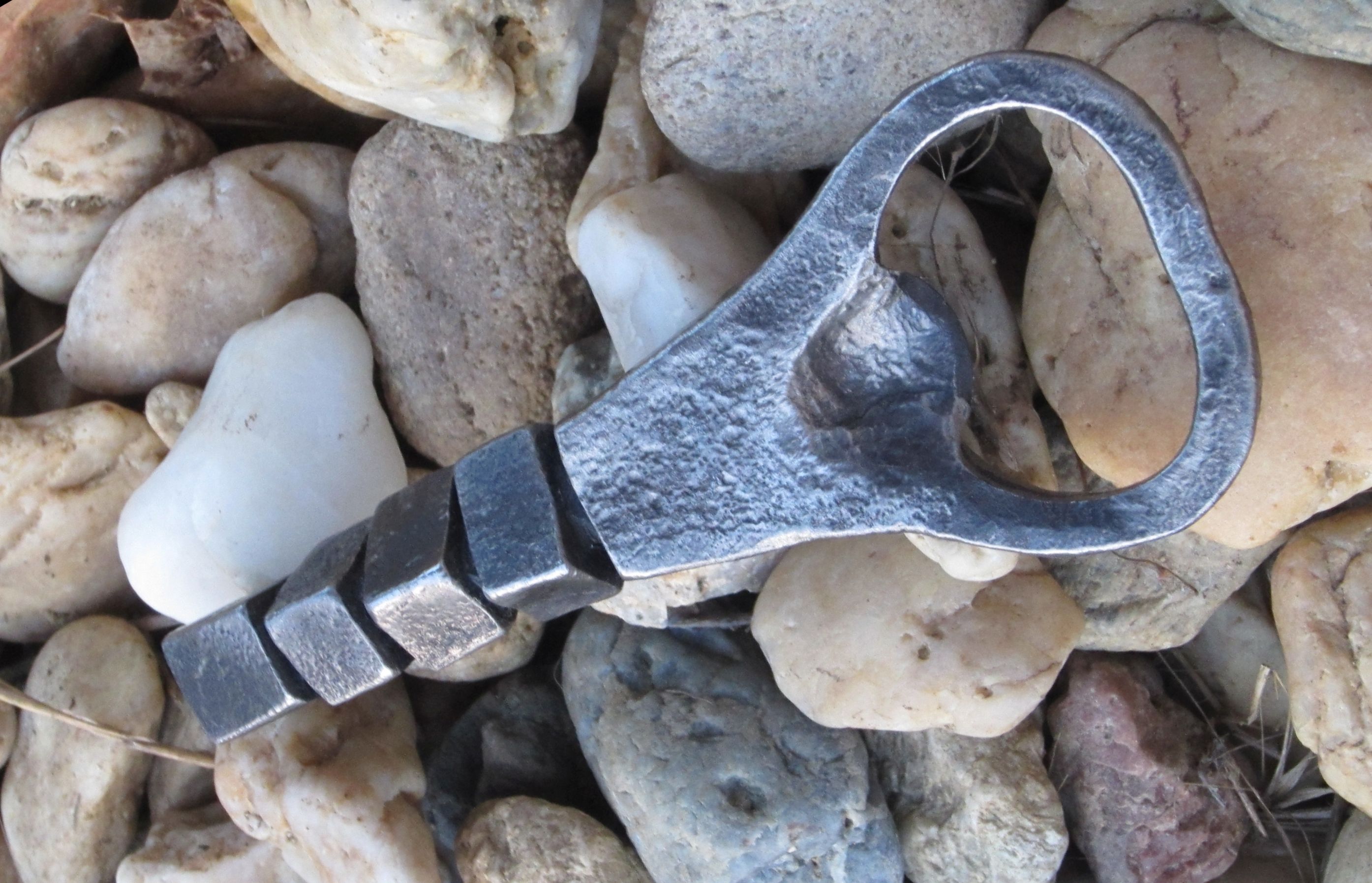

Gergely Posted August 20, 2016 Share Posted August 20, 2016 (edited) More ex-harrow element openers. Some experimenting. Need some better looking letter-cutters And finally I made some appliable carnauba, so these are the first with carnauba finish, hurray! Bests Gergely Edited August 20, 2016 by Gergely adding info Quote Link to comment Share on other sites More sharing options...

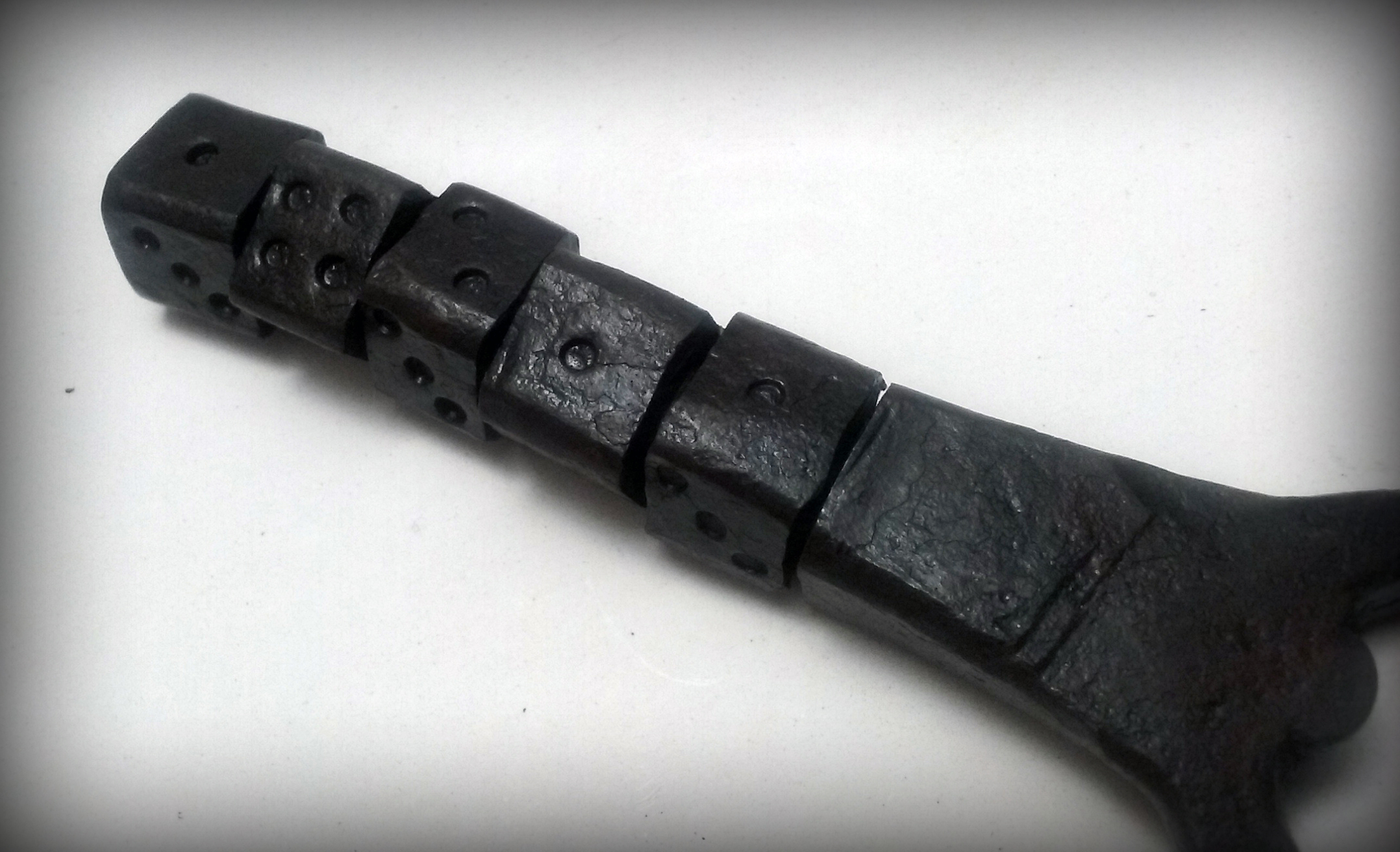

HEAP of JEEP Posted August 22, 2016 Share Posted August 22, 2016 Don't remember where I first saw this idea... maybe here, maybe facebook, maybe a craft show... don't remember, but wherever it was, I have always wanted to try it. So, this afternoon, after a great show at my weekly farmers market/artisan's fare, I was feeling good and decided it was time to try it. I didn't take the width of the cutting wheel in account, so my dice look a little squished, but it was fun and think it turned out decent. Quote Link to comment Share on other sites More sharing options...

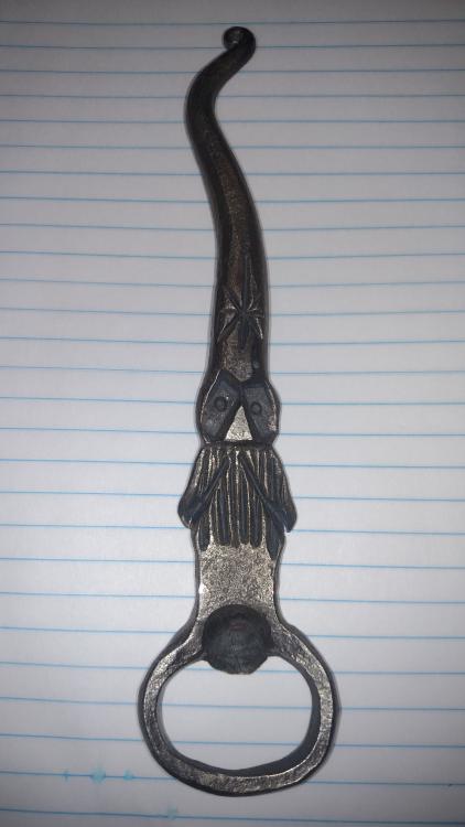

Donniev Posted August 22, 2016 Share Posted August 22, 2016 Had enough time to get this and a pair of tongs made, copied it from a YouTube video (mark aspery, I think). I've made a few of em now and given them away, next time I make one I'll think of a few things I can do different to make it my own Heap, that looks great, love the idea of incorporating dice in em Quote Link to comment Share on other sites More sharing options...
Frosty Posted August 22, 2016 Share Posted August 22, 2016 I like the dice in a cube twist Heap, lots of potential with that one. It needs more aggressive wire brushing though, the scale really looks out of place on dice. I like the figure Donniev, I'm not sure what it is but I like it. Sort of strikes me as an owl elf? Very cool. Good on ya both! Frosty The Lucky. Quote Link to comment Share on other sites More sharing options...
starbits Posted August 22, 2016 Share Posted August 22, 2016 Jeep: The numbers on a dice add up to 7 on opposite sides. 3&4 2&5 1&6. You will need to fix that on the next version, because customers will notice. Starbits Quote Link to comment Share on other sites More sharing options...
Michael Cochran Posted August 22, 2016 Share Posted August 22, 2016 5 hours ago, starbits said: Jeep: The numbers on a dice add up to 7 on opposite sides. 3&4 2&5 1&6. You will need to fix that on the next version, because customers will notice. Starbits It wouldn't hurt but I don't know how many people are going to examine it that closely. I for one was not going to but I had to after you mentioned it. Quote Link to comment Share on other sites More sharing options...
Donniev Posted August 22, 2016 Share Posted August 22, 2016 Frosty- it's a wizard Quote Link to comment Share on other sites More sharing options...
ThomasPowers Posted August 22, 2016 Share Posted August 22, 2016 Well in most modern systems they do (see chirality) and historically in some systems they don't. OTOH I know a smith that forges dice and makes sets where one die has only 3's and one has only 4's so *ALL* rolls are "sevens". Dental insurance *not* provided with such dice. Quote Link to comment Share on other sites More sharing options...
HEAP of JEEP Posted August 22, 2016 Share Posted August 22, 2016 8 hours ago, starbits said: Jeep: The numbers on a dice add up to 7 on opposite sides. 3&4 2&5 1&6. You will need to fix that on the next version, because customers will notice. Starbits The worst part is, I knew that... but in the heat of forging, the only thing on my mind was, "Make sure you don't repeat a number on the same die." I was going to do another one tonight, just to prove to myself that I can measure things correctly and get proper cubes, so I will make sure I keep it in mind tonight. Quote Link to comment Share on other sites More sharing options...

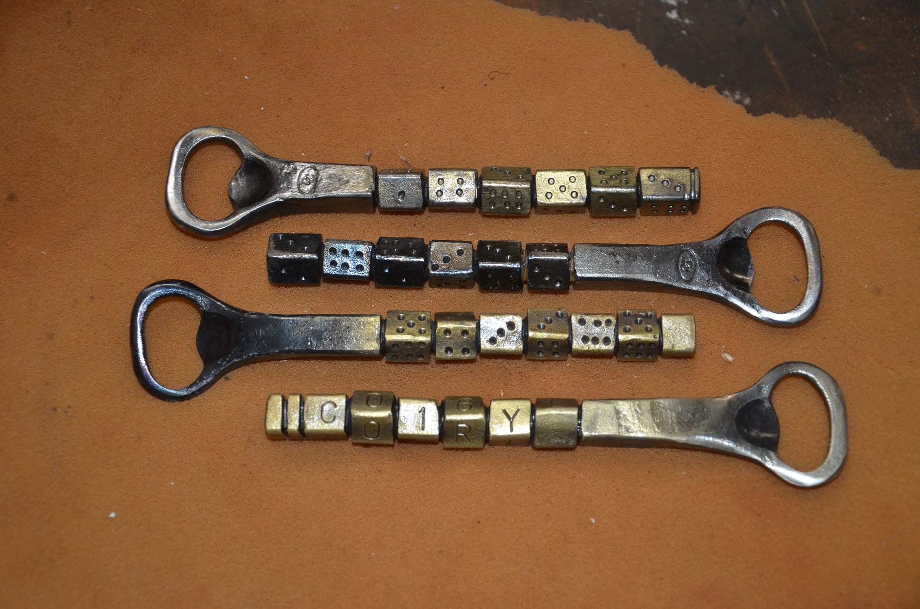

ausfire Posted September 1, 2016 Share Posted September 1, 2016 Been thinking about Heap's idea with the cube twist dice openers. Had to give it a try. Learning experience. The top two in the photo are not good, as I was inexact in my execution of the çubes. I fared better with the third one, but erred with having two identical dice side by side. The bottom one was just an experiment - my name written spirally with the date in Roman MMXVI and Arabic 2016. You have to rotate it to read. For next time: Be exact with the cubes - I will scribe the lines with a fine point - exactly 12mm. Centre punch the dots first to have them evenly spaced before punching larger dots. Ensure all opposite faces add to 7 before final punching. Anyway, here they are: Quote Link to comment Share on other sites More sharing options...
HEAP of JEEP Posted September 1, 2016 Share Posted September 1, 2016 7 hours ago, ausfire said: Been thinking about Heap's idea with the cube twist dice openers. Had to give it a try. Learning experience. The top two in the photo are not good, as I was inexact in my execution of the çubes. I fared better with the third one, but erred with having two identical dice side by side. The bottom one was just an experiment - my name written spirally with the date in Roman MMXVI and Arabic 2016. You have to rotate it to read. For next time: Be exact with the cubes - I will scribe the lines with a fine point - exactly 12mm. Centre punch the dots first to have them evenly spaced before punching larger dots. Ensure all opposite faces add to 7 before final punching. Anyway, here they are: Those are beautiful, Aus, and why I bow to the masters. I've forged up a couple of more for my shows, and got the dice correct this time, but then I read that Vikings used to use dice and they made sure that the opposing sides NEVER added up to 7. Found it on the internet so who knows if its true or not, BUT... I used it as a selling point, and that first one is now labeled as a "Viking" bottle opener, and the price went up by $15. LOL Oh, and I can't take credit for the idea... I saw it somewhere... maybe on this forum... It was just my attempt at replicating it. Quote Link to comment Share on other sites More sharing options...
