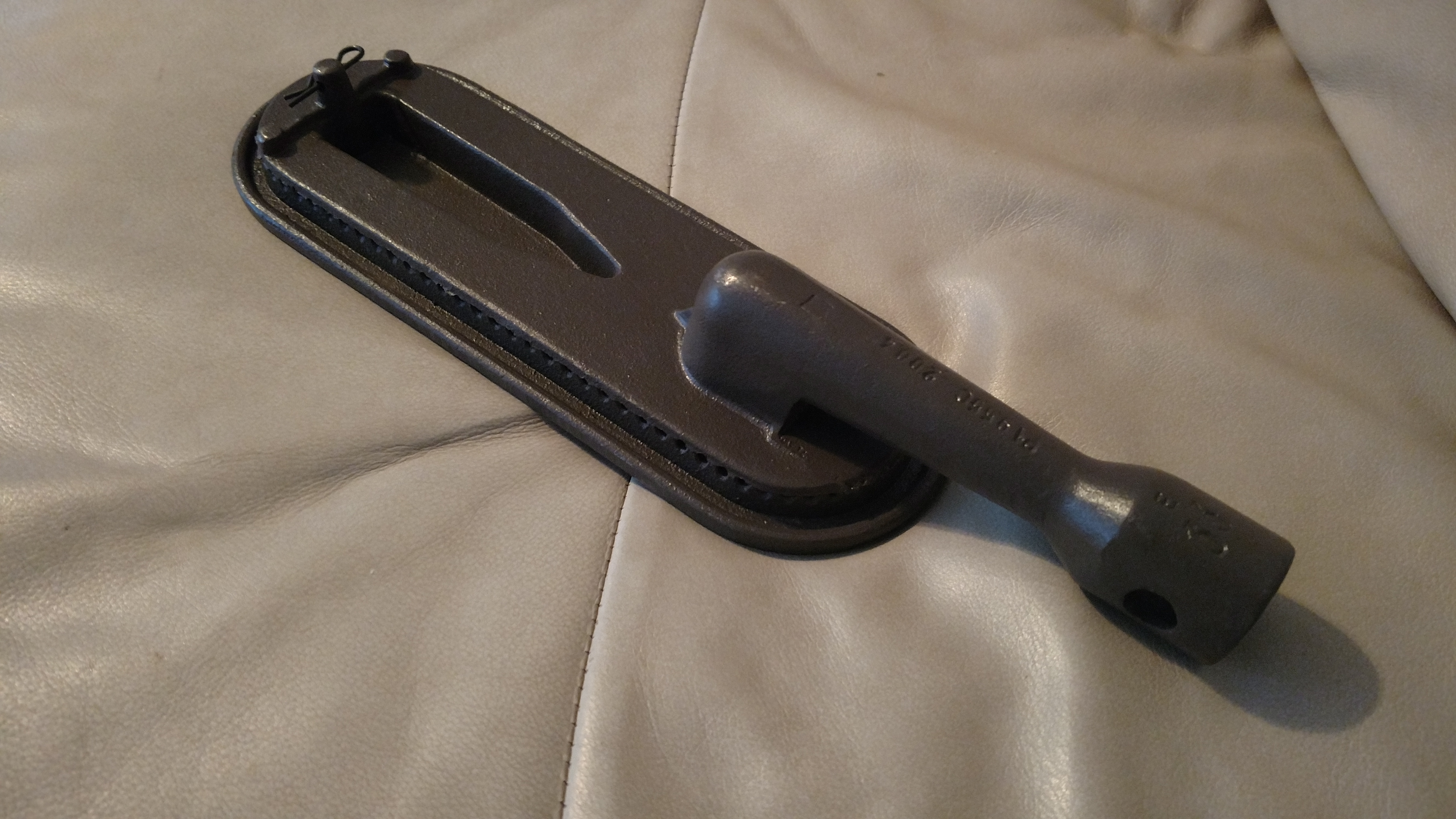

Frosty - sorry if something like this has been asked, but I was gifted a cast iron grill burner. What are the odds of using it like a ribbon burner? Or am I way off base? -
