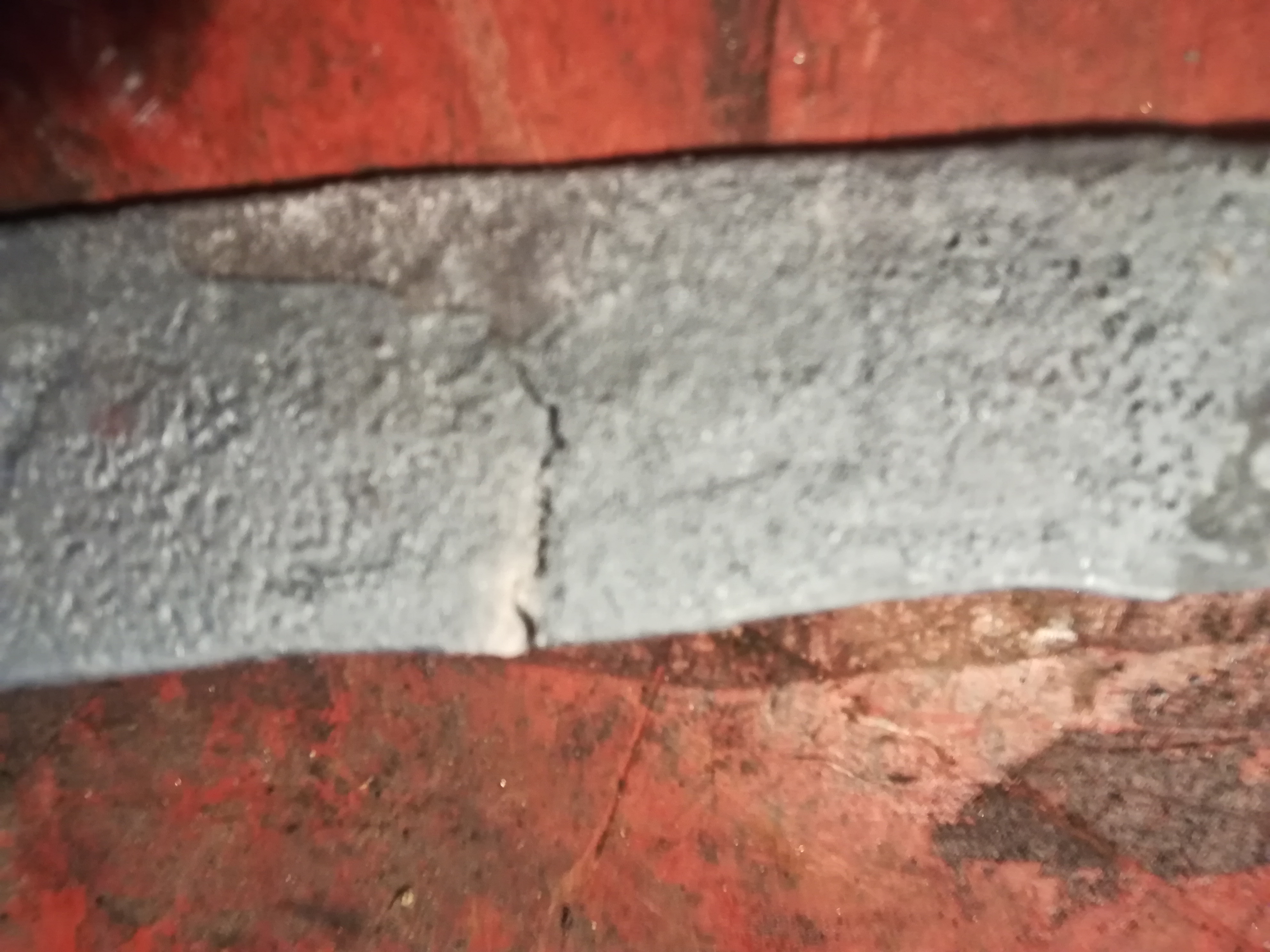

    OK. I have no idea as to how I have the forge set up regarding CO. Doors are always open and I have a CO detector close by. Now you are talking to a real new boy here, despite his 64 years, so a lot to learn. Point me in the direction where I can understand what a reducing atmosphere, and what I need to do to control it is please. I do leave it in the forge for quite a while as the metal cools so quickly. From video's I've watched, blacksmiths seem to be working metal for longer than I do. Less than a minute each time. I'll check grain size tomorrow.

    Sometimes I'm hammering lightly to take out any bending in the steel before returning to heat, but I thought you could tidy up metal when dark? I do have the steel directly under the flare, should it be to one side in the gas forge?

    I've made a few nice blades from O1 steel, but this week thought I'd make some from recycled metal. First off an old file that went well until I noticed a crack in the tang. I heated it again and the tang just fell off. After I cooled the blade and cleaned it up, realised (sorry - UK spelling) a massive crack across the tip was also a problem. Started afresh with a length of coil spring and the same thing happened - small cracks appearing as the blade edge was being formed. Tried a third time to make a letter opener from a small file, and the same thing again. So, I understand the coil spring could have deformities in it already, but three on the trot makes me thing I'm forging incorrectly. Any thoughts?
