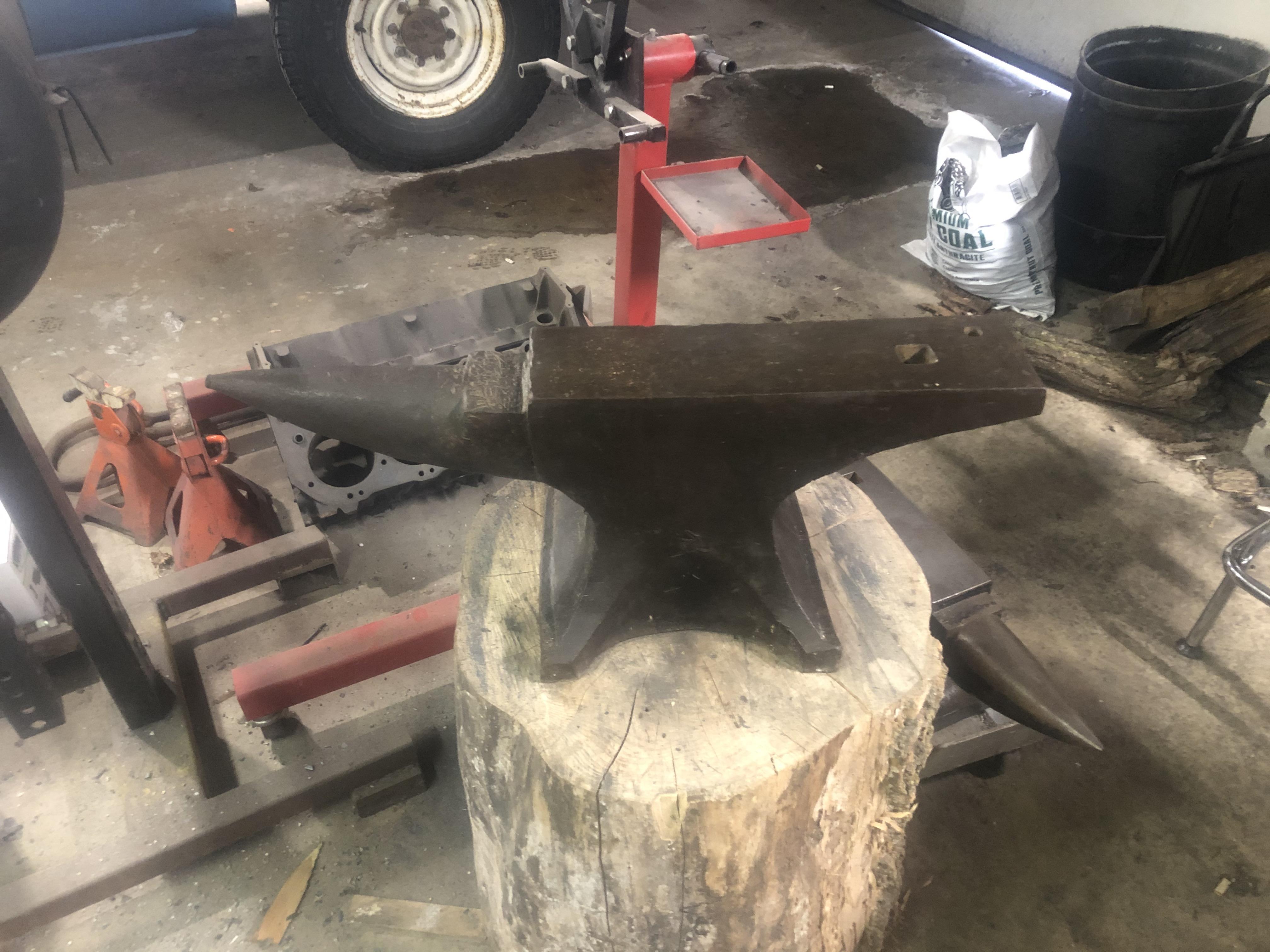

  1. 198 lb Peter Wright. It's 2 inches taller than the 120 lb anvil I was using, so I need to cut off about 2 inches from my stump and mount it.
