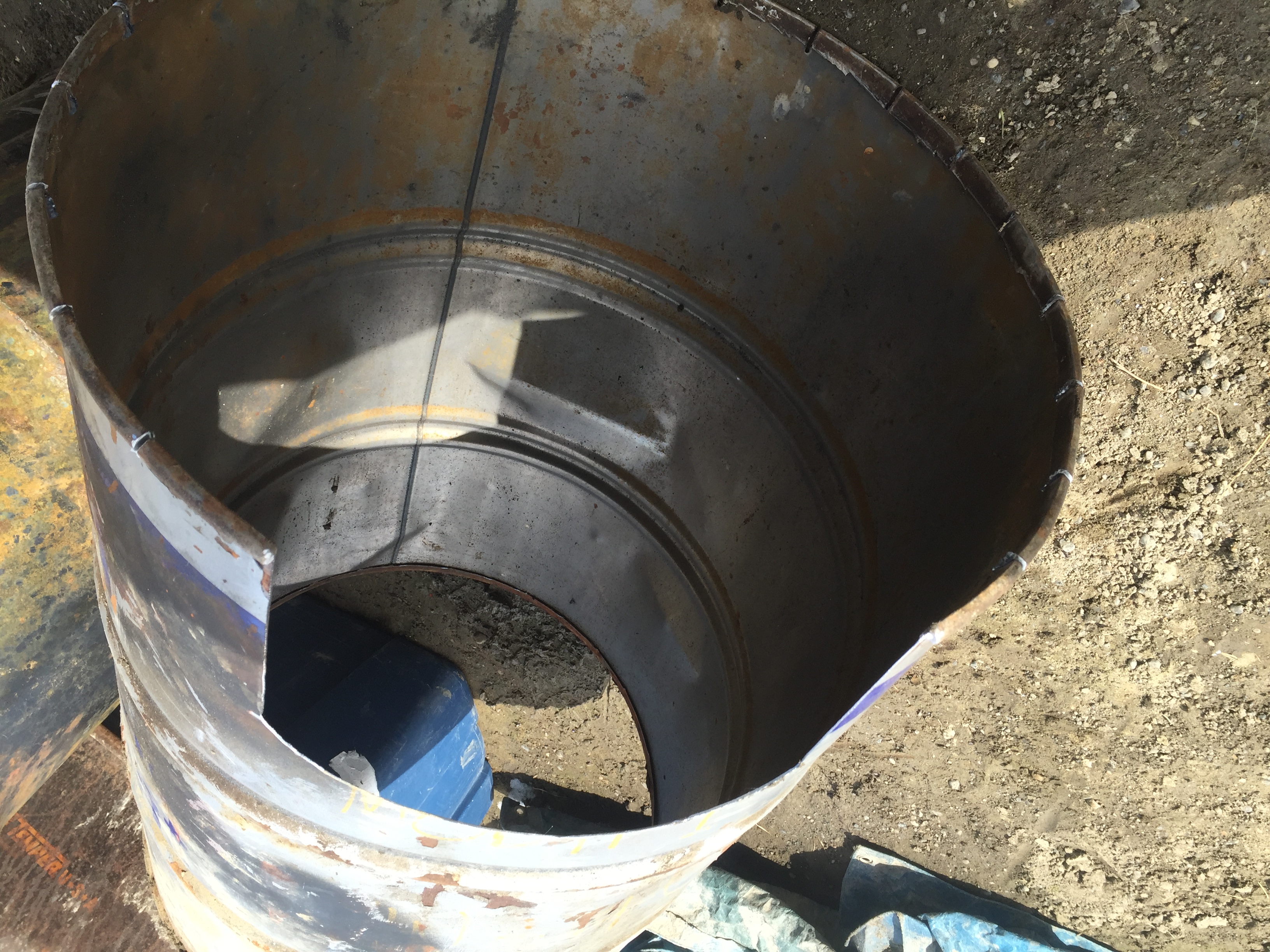

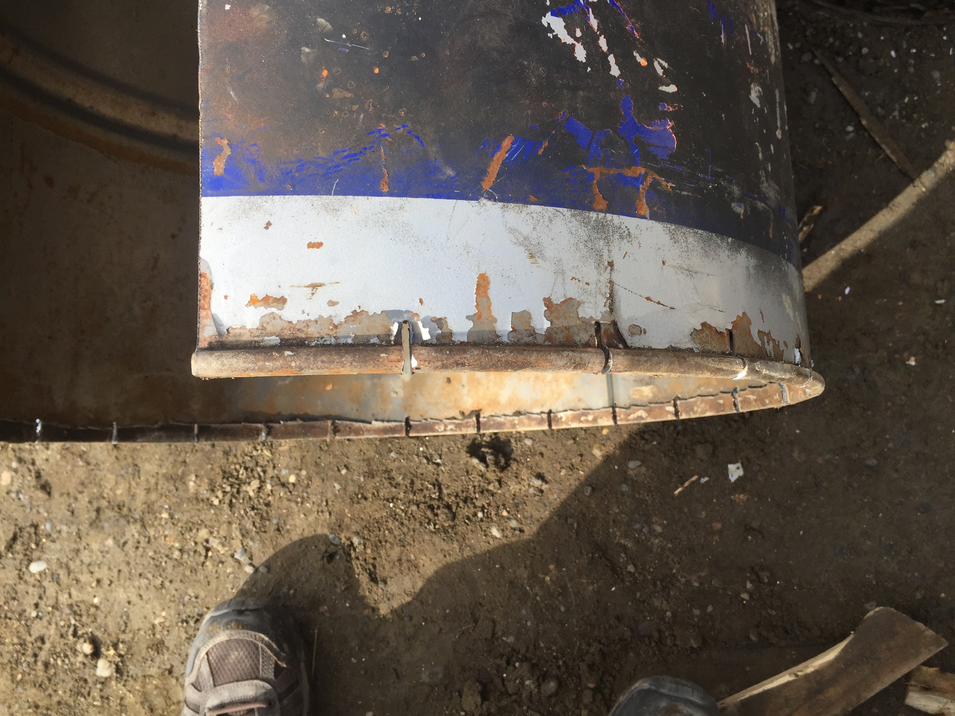

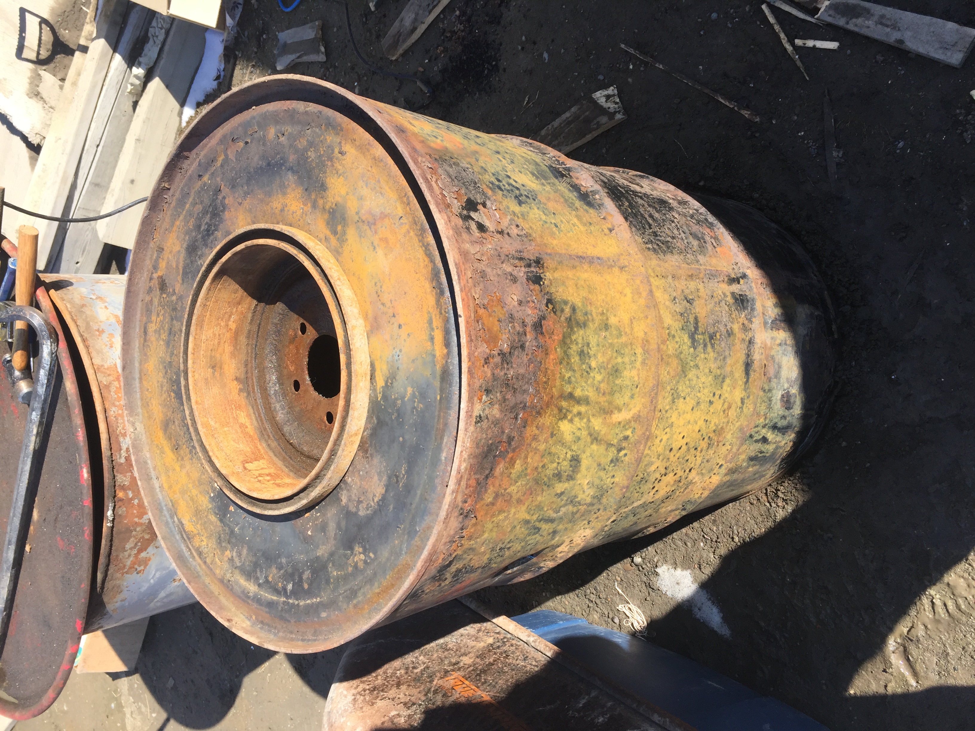

I made some progress on my supercharged 55 side blast forge as well. I made the opening in the side wall way to small so I will be cutting that bigger soon. Still haven't had a fire in it yet, but we are getting there. I still need to add a grate to the bottom of the fire pot, but I don't think I'm going to put a pipe under it as this is a side blast and all the ash will be contained under the 55 gallon drum that is the base of the forge. I used a drum with the top cut out of it and flipped it upside down. en cut an opening in the center to drop in my brake drum for the fire pot. I cut a 12" wide by 7" tall opening in the face of the chimney then cut in slots every 3" to create tabs around the rim. The first time I cut them the slots were to shallow and I had to cut them a second time. Finally I alternetly bent the tabs in and out to cradle the rim of the first drum. -

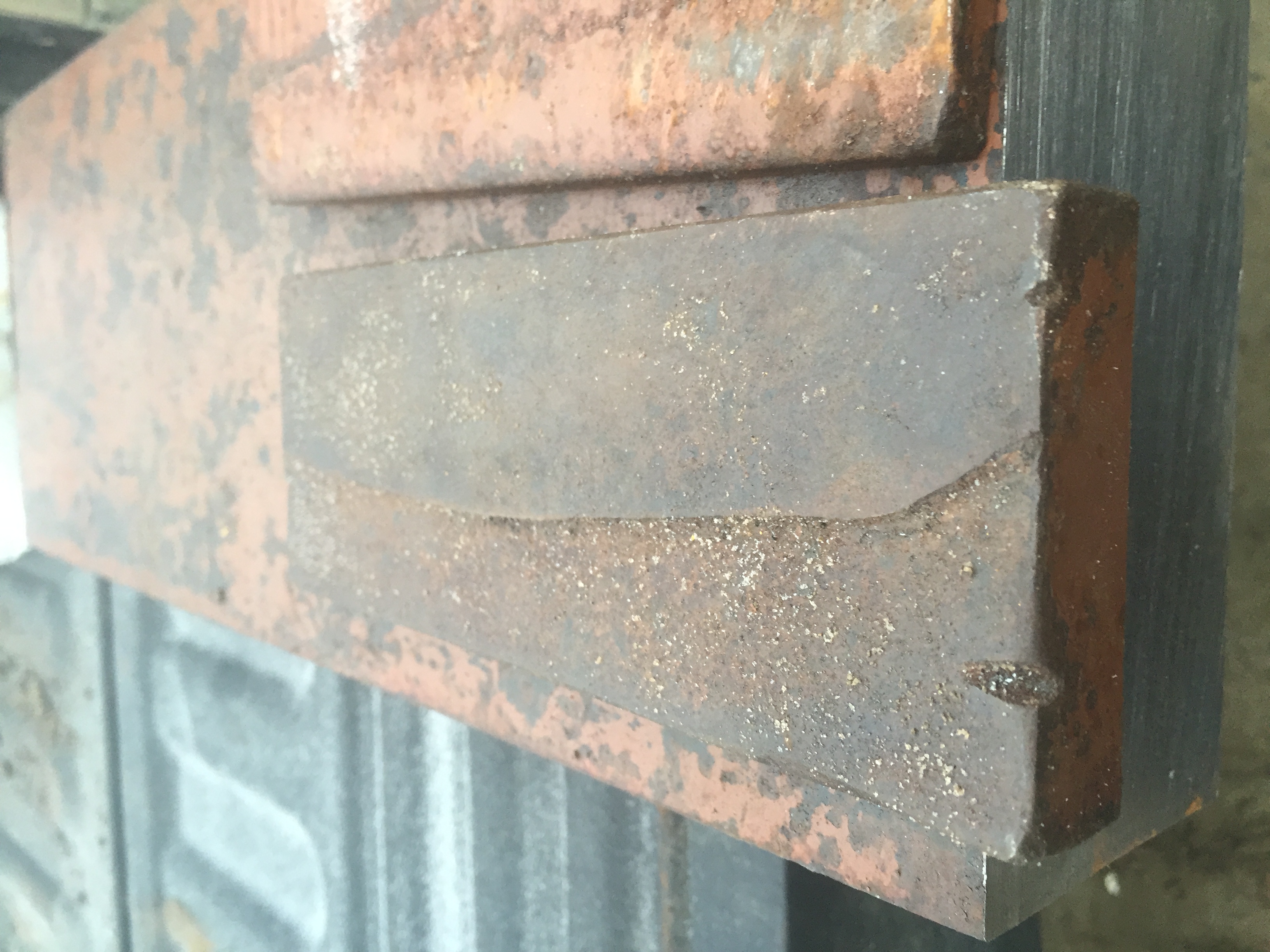

For anyone that was worried I was messing up my anvil here are some pics. The striking surface and bottom end of my bar stock anvil were not at all level and I cut maybe an inch total from both sides combined. -
