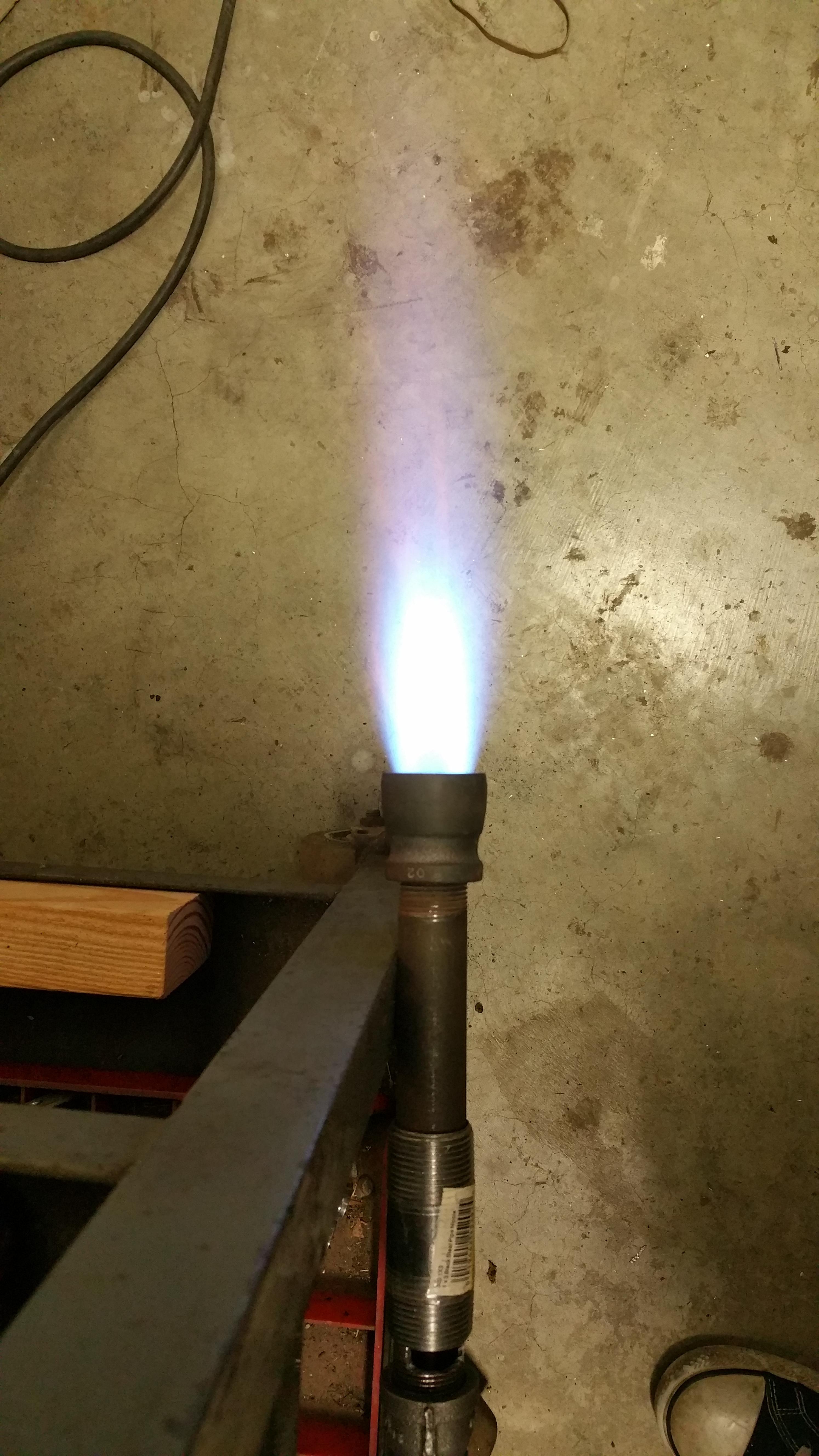

  8. Hello All!! Had a chance to fire up my new forced air forge. I used 1" black steel piping and a stainless steel flare that I TIG welded. Fuel pressure set to around 4-5 psi and used a shop vac for now. Seems to running well to me. Any suggestions/criticism is welcomed! Thanks!

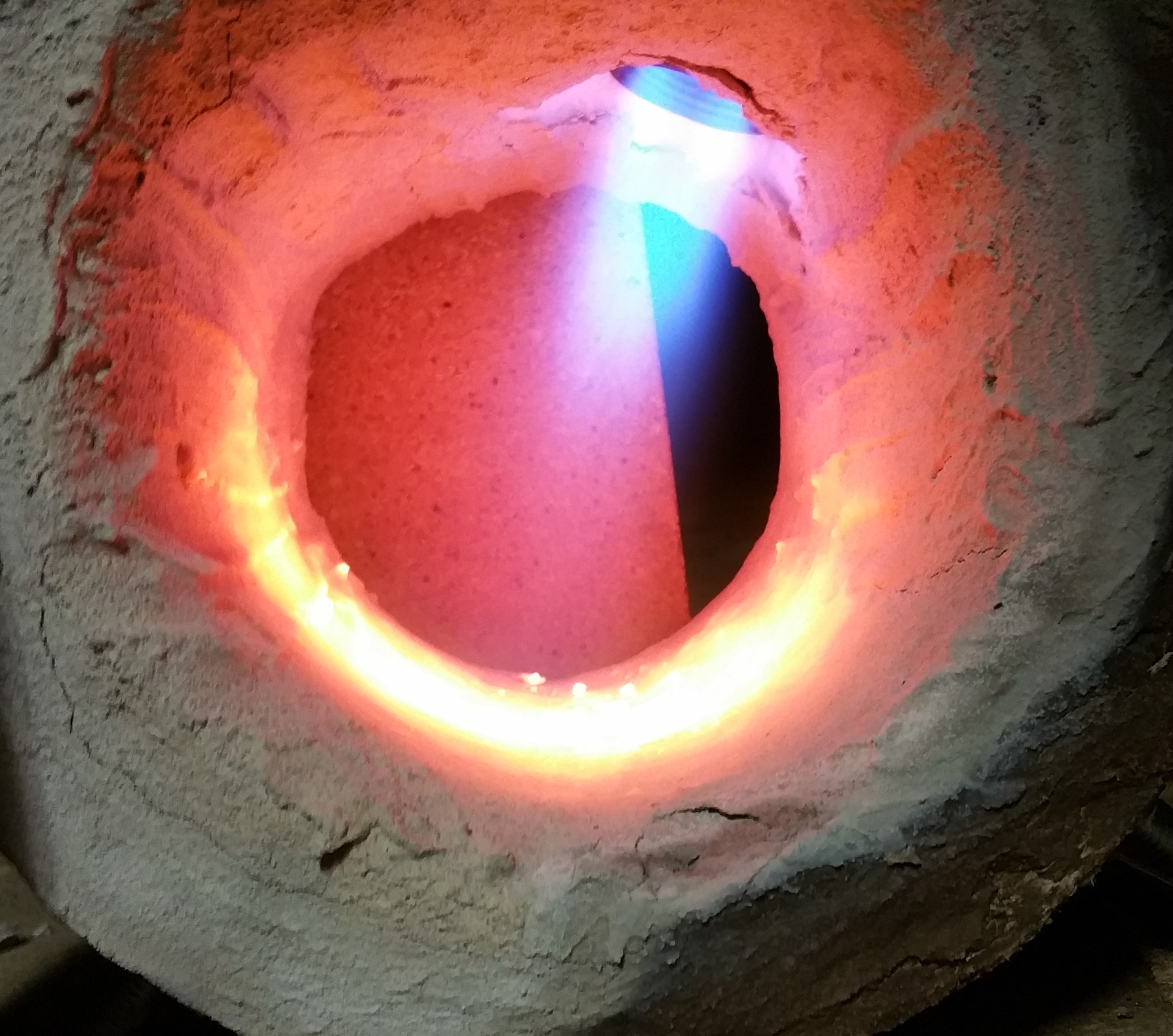

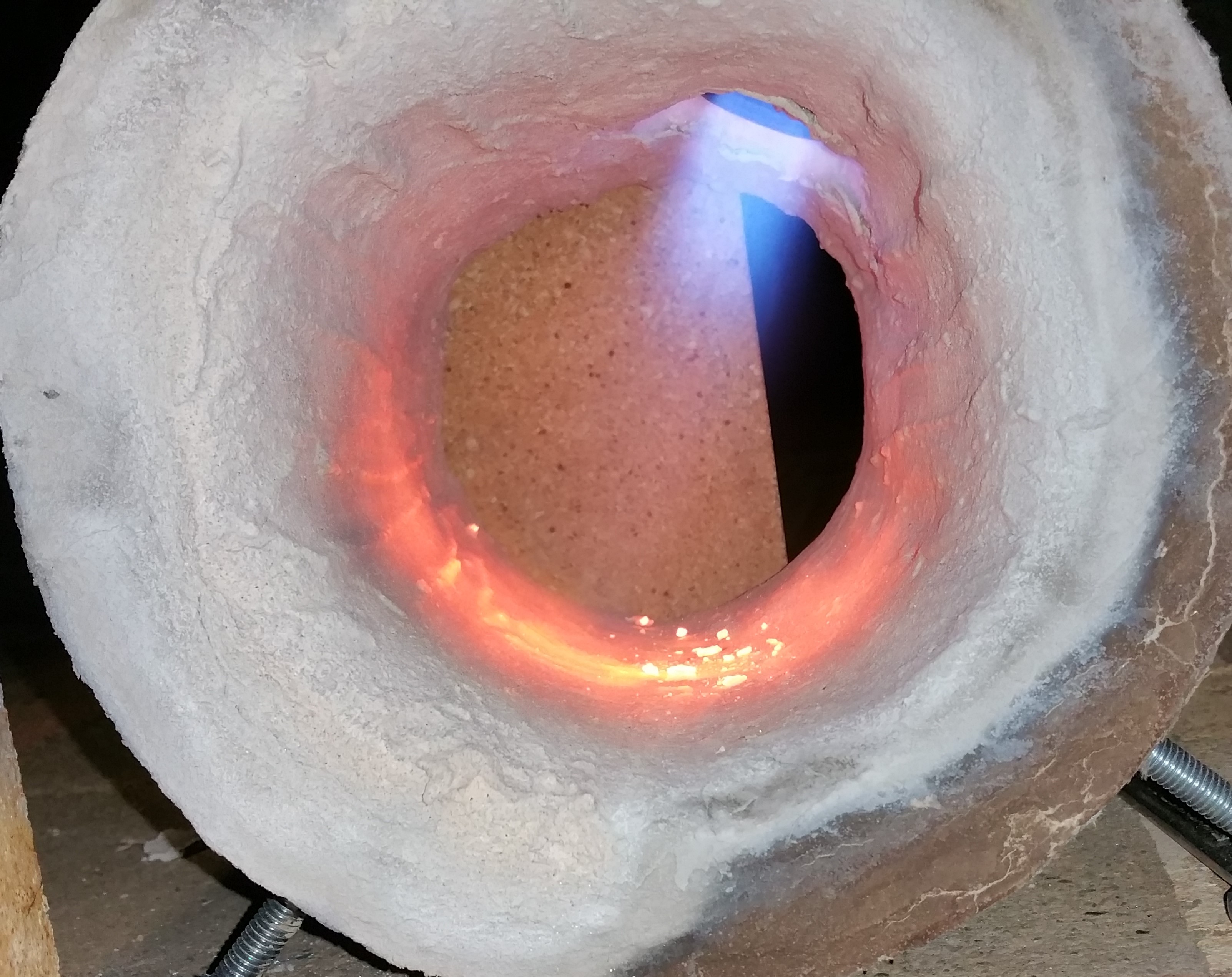

  17. I'M BACK!! I got around to firing up my new little forge that I made from a freon tank. Using the burner (as mentioned above in my past post) I fired her up. I noticed an orange tinge to the flame. I attribute it to the angle of the burner. Maybe the flame is deflecting?? Anyway, I through in a railroad spike. After 7 minutes or so, that thing was glowing & the flame was barely visible...hmmm. I set the spike on my anvil & admired it. I allowed the forge to cool and after adjusting the burner angle, I fired her up again. I was quite happy, but would love more opinions. Second picture after is about 3 minutes in, and lastly...I think its about 8 minutes in. A regulator is on order...BTW Thanks you for looking!!
  18. Hmm...not a Mikey burner? I guess it's a knock off? I have limited tools, so I try to simplify and use what I have. Today, I opened up the sides of the pipe. Still need to clean it up to make it pretty and functional. Stacked some bricks, lit the temporary forge and let it run for about 5 minutes or so. I threw in a railroad spike just to see how long it would take to get it to glow. At 6 minutes, I took out the spike and set it on the anvil. Here are some pics of my build. I am using a .025 mig tip. My apologies...I tried uploading more pictures, but I kept getting a failure to upload message.. The burner tube is 3/4x8in black pipe.

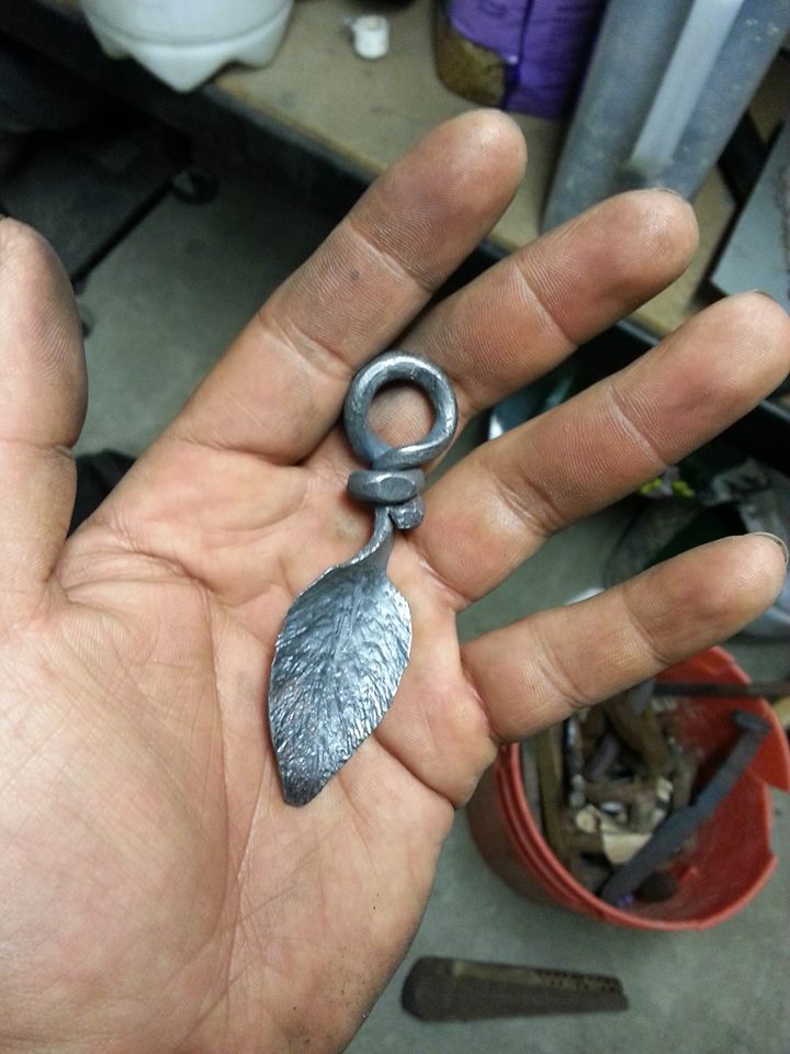

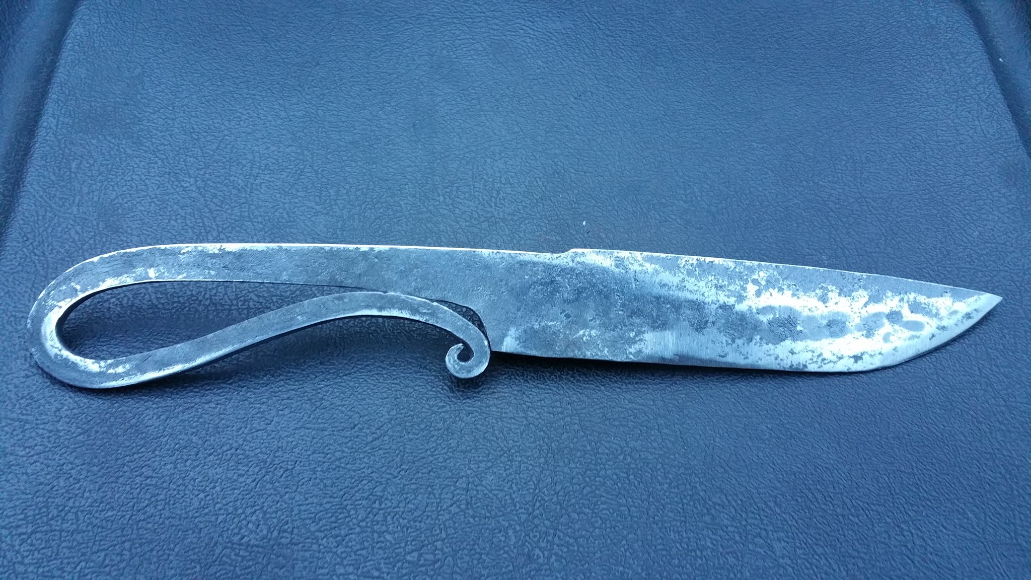

  21. Thanks! There's a video on YouTube: "Jesse James Blacksmith part 2" He goes to Israel and works with Blacksmith Yuri Hofi, Yuri states he still learns by making these leaves. If it works for him...means I can learn a lot. I used the obligatory leaf spring...LOL. Can't wait to finish it! Still need to quench the blade and leather wrap the handle.
  22. Thanks! Took me a while to make a leaf and this knife. My arm was pretty tired! But I had a lot of fun with these two projects!

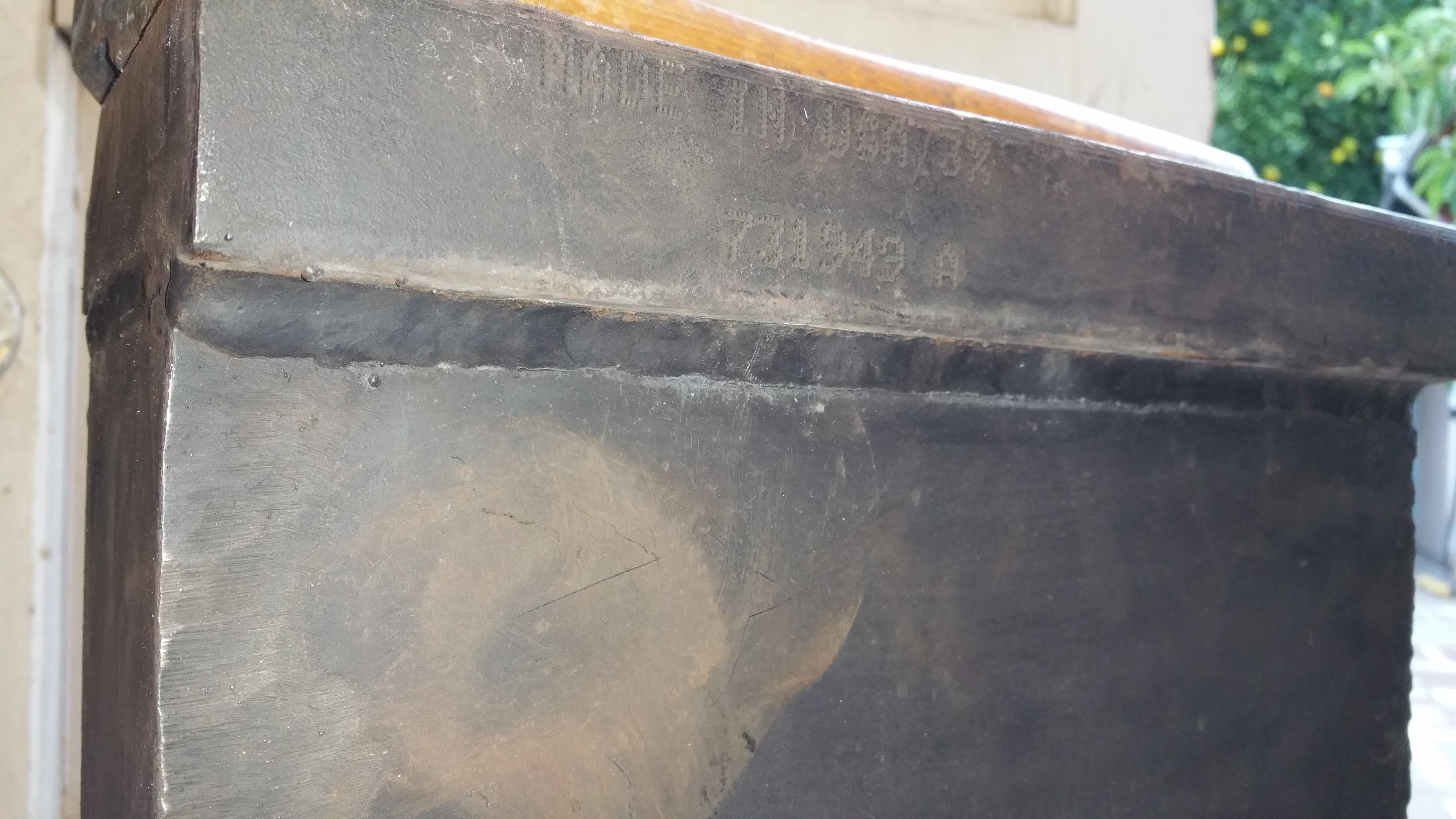

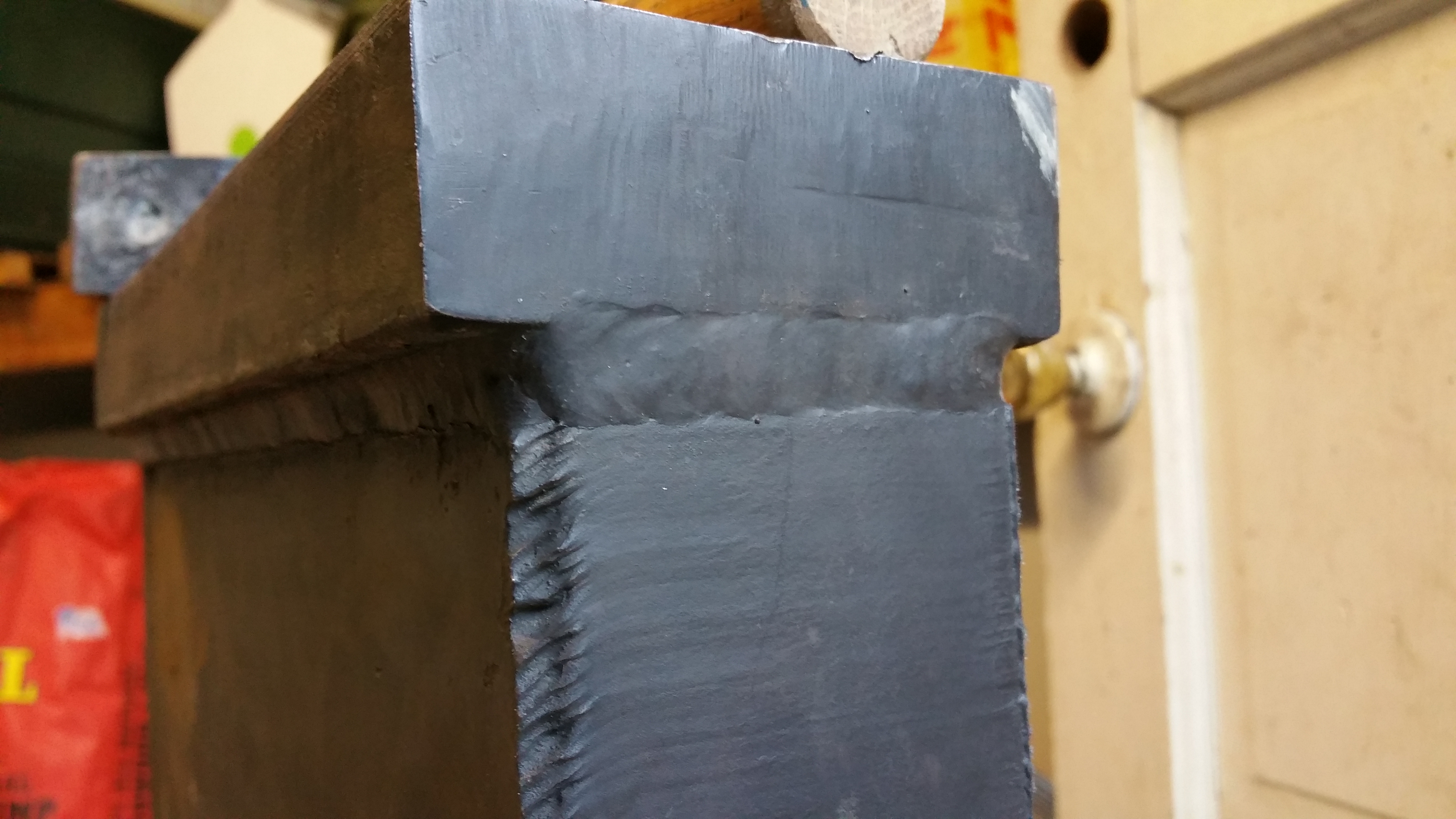

  23. My apologies for late reply... Here are some more pictures. I'm not sure if they are full penetrating welds. But the shop I took it too, told me he used some high impact resistance rod. He gave me a number, but cant remember. Here's a video clip of rebound. It's not too bad I guess.. 20161023_181758.mp4

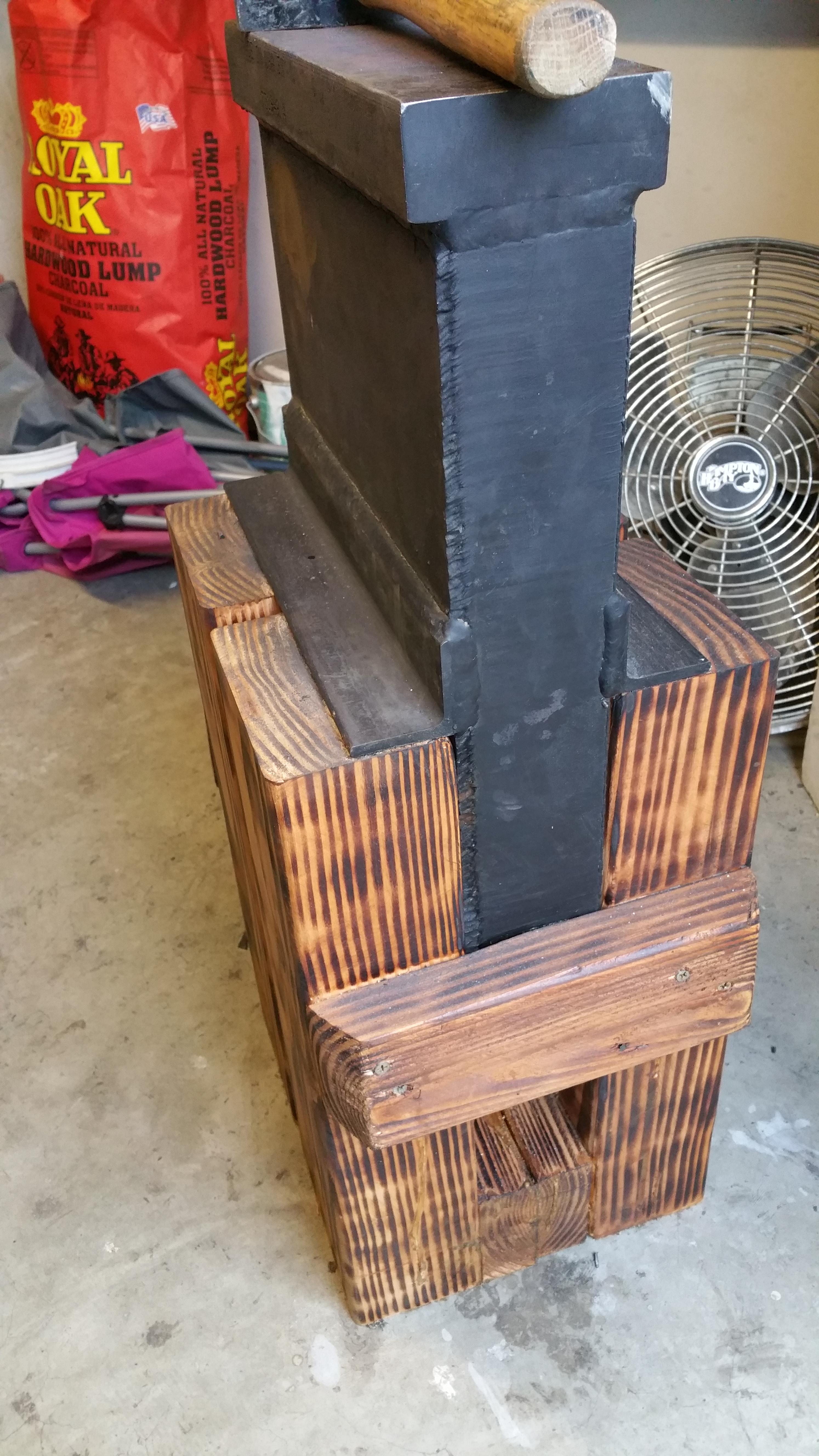

  24. Finally finished up my anvil stand and had some good fun. Started out by turning a round bar stock, into a square then into a leaf. Dang its tiring!!
