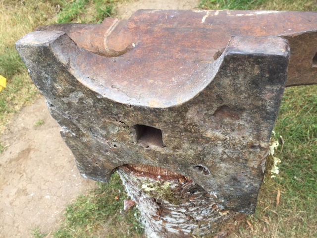

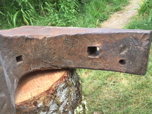

Early Trenton Broke at waist need advise
Sluicebox replied to Sluicebox's topic in Anvils, Swage Blocks, and Mandrels
Thanks everyone, that's what we will do. Weld up what has been ground out and leave it be. No light shines through hole so probably L bolts as mentioned above. I have some of that nasty heat sink grease that wont wash off no matter what you do. Will post pics after repaired. Thanks for all the input everyone. Glad I didn't cut out that bolt. Best to you all. PS that repair was started before I acquired it. -
Thank you Mr. Stevens. I do have a thick aluminum plate, what is heat sink grease? Here are those daylight pics of the critter. After looking at in in daylight I don't think the crack goes completely through. Probably 85% though. The U bolt doesn't show signs of hammer marks so I'm guessing they did that in a large press. Likely they pressed the bolt into shape from the sides and then pressed the top down before tightening the nuts. Also shown is the serial number I still would love to get a date off of that. Thanks for all your input everyone. I just want to get this working so my Grand kids can have it. -
Thanks for the excellent safety tip DSW. It would be DC stick. If I run two bolts through the pritchel holes and have another support under the tool plate near the horn that should keep the top plate immersed in a nice bed of water. Matto your right about the old repair on that looking neat. That took a pretty smart person to come up with that one and you can tell it was done by a Black Smith. It's amazing what those old guys could do. I see evidence of it all the time in the old mining districts. The wages of a Smith back then were only $.50 less a day than the Mill Foreman. The Smith kept them in business.
