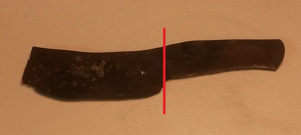

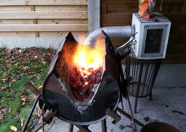

Now it is time to forge out the general shape of the razor. I use a primitive setup to heat the steel. I like working with charcoal because it burns clean, doesn’t smell, and doesn’t have the potential to make the shop go boom.. First I mark the transition between the edge and the tang using the side of the anvil. Then I upset the tang area a bit to get it out of the way of the edge part. Then I do the same at the other end of the edge part, using my horn to pinch it just a bit. This makes it fairly easy to bevel the edge part into a triangle without messing up the tang. Once the edge part has been shaped, I further upset and draw out the tang into a taper. The reason I do it in this manner is that I have found this to be the easiest method of making the blank while ensuring that the tang and the edge are aligned properly lengthwise while also keeping them aligned in the vertical plane. With this I mean that if you look head-on at the blank, you see the triangular section positioned vertically, with the crosscut of the tang behind it, also with a rectangular cross section oriented vertically. I have found this to be the trickiest part of the process because where they meet, the steel develops ‘shoulders’. If you hammer the triangle once while the shoulders are on the anvil, the tang twists and realigning it is a bother. Additionally, the tang has to taper evenly from the shoulders to the end of the tail. I cut the blade from the stock using a cut-off hardy. With some steels I use an angle grinder. For example the Japanese suminagashi steel (white paper steel core with soft sides) has delaminated twice on me when using a cut-off hardy. Granted, that could be resolved by cutting hotter, but that creates the problem that the spine might bend sideways because it isn’t very strong when hot on account of the mild steel sides.
