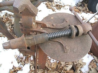

This is the subject of this Blueprint. This is my demo vise and is stored outside in the weather year round.
Leg or Blacksmiths Vise --
All Leg Vises work in more or less the same way, but some are constructed differently. In essence, all leg vises are not created equal. They are just like everything else, through years of evolution and trial and error some improvements have been made.
The white arrows point to the forward and rear what I call EARS. My Grandfathers leg vise does not have this feature, but is in excellent shape. I have never heard an explanation of what their function is other than my own. My explanation is that they are deflectors to keep hot scale, filings and saw cuttings from falling directly into the the bearing surface of the front screw handle and the contact area where the screw box sets in the split part of the vise main frame. We all know that any kind of abrasive material will abrade away metal that is in constant motion. Even common dust will do this.
This is what the screw box and screw look like for this vise. Contrary to most belief the threads are not of the Acme type, but are square threads. Square threads do not have tapered sides so thus there is more mass to the thread as it is not narrower at the top and thus will take more torque and the abuse of much use. They are necessarily a little looser than most thread fits and thus do not bind up or gaul as easily as other thread types.

This shows the thrust washer and centering cone from the first vise. The arrow points to the rounded taper that does the centering in the outer jaw opening. It also shows a more or less massive bearing surface on the screw handle.
This is the thrust washer and centering cone from the other vise, notice that the bearing surface on the screw is much smaller and is rounded over from wear. This vise is much harder to get really tight and also to release the pressure.

Any Heavy, Thick or Sticky Lubricant should never be used on the screw of a Vise, as it is like a magnet for any foreign DEBRIS to Stick To. The Only Lubricant that should be used on any Vise Screw is a Light Weight OIL. Light weight Oil has the ability to easily discharge or get rid of any Abrasive Debris due to its Thin Viscosity and it does not HOLD Debris to the screw like the Heavy, Thick, Sticky stuff does.
Once a week or so if the Vise gets a lot of use, the Vise Screw should be unscrewed almost all the way and a good spraying with WD40 or other very light weight oil should be used to wash the Screw Off, making sure to turn the screw by quarter turns and spraying to Wash the Old Contaminated Oil from the screw, I hold a shop towel under the screw when doing this to keep the runoff mess to a minimum.
After the Cleaning Cycle, a Liberal amount of Light Weight Oil should be applied to 4 sides of the screw. I use 10 weight Non Detergent engine oil or Marvel Mystery Oil.
A liberal amount of the same Light Oil should be squirted in the end shown by the White Arrow before the Vise Screw is Screwed Back In. Hold the Palm of your Hand tightly against the opening in the end while screwing the screw back in so it builds up pressure and the Excess Oil you squirted thru the hole will be Pushed Out thru the Internal Screw Box Threads and will push the Old Oil and Fine Debris out the other end. An old rag laid in the scissors part of the jaw legs will cut the mess to a minimum.
On Vises with a Closed End on the Screw box, there are two choices. 1. You can Completely Remove the Screw and squirt a liberal amount in the Screw box before reinserting the screw, or you can Bore and Tap the Screw box in the area shown by the White Arrow and screw in a plug before screwing the Screw back in.
Don't forget to Lubricate the Thrust bearing area near the end of the handle. This area should be thoroughly wiped clean before lubing it.
It is a Good Practice to place an Old Rag at the position indicated by the arrow when filing, or sawing to keep the cuttings from falling down onto the screw. If the Vise Jaws are open quite a ways the rag should cover the Whole Exposed Screw.
