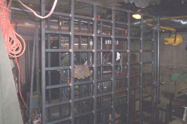

Security Door
Both doors assembled and built in this position ( you can see the supports welded to the doors and tables). 1"square bar, 1/4 x 1, 3/8 plate ( lock covers ), 1"1/2"( 11 ga ) tubing ( hinge supports). Hinges themselves are 5/8 ID 1 1/8 OD tubing and 5/8 pins. 3/4 x 6 grade 8 bolts to mount the door on the building. Client paints and installs.
