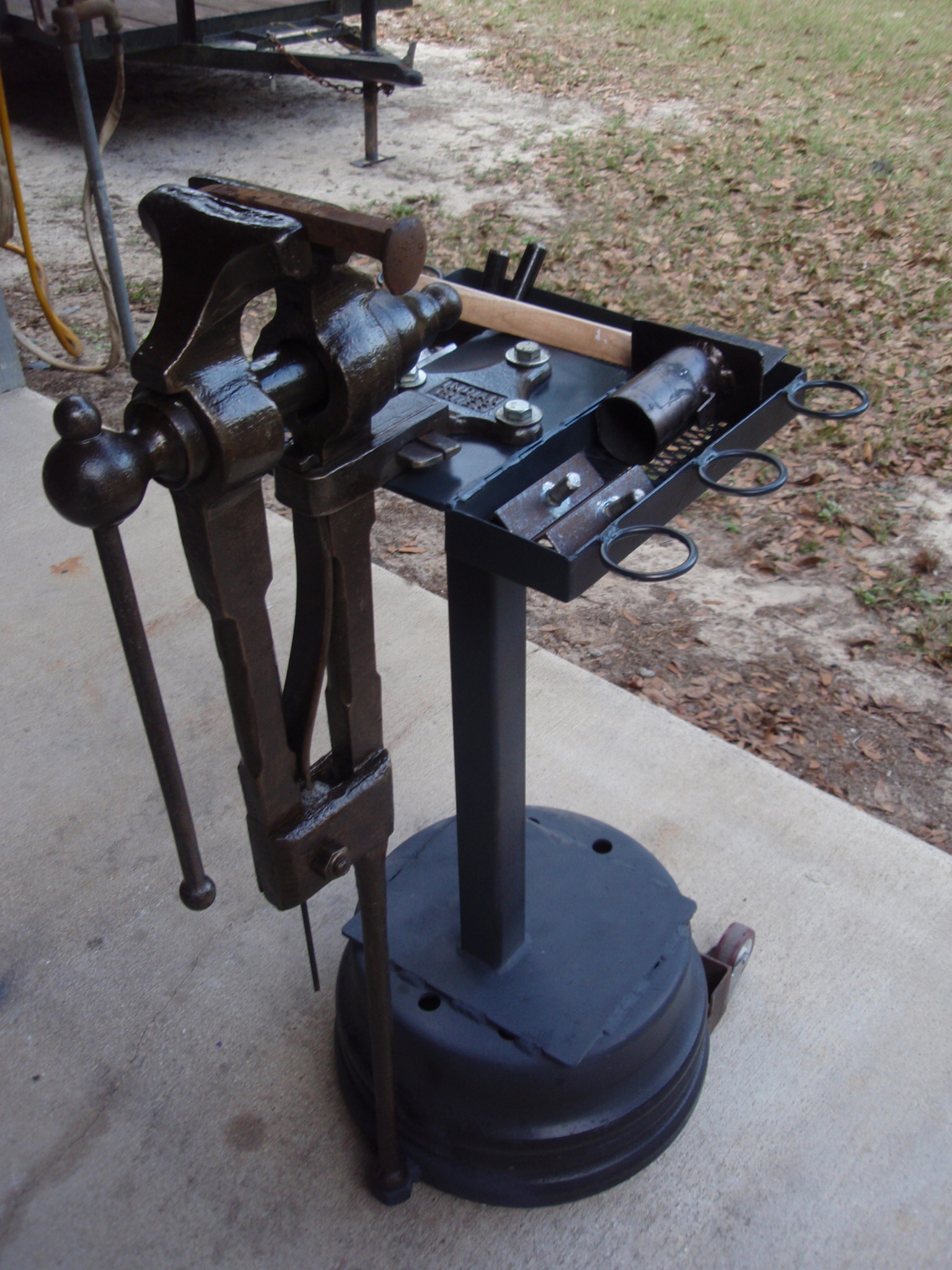

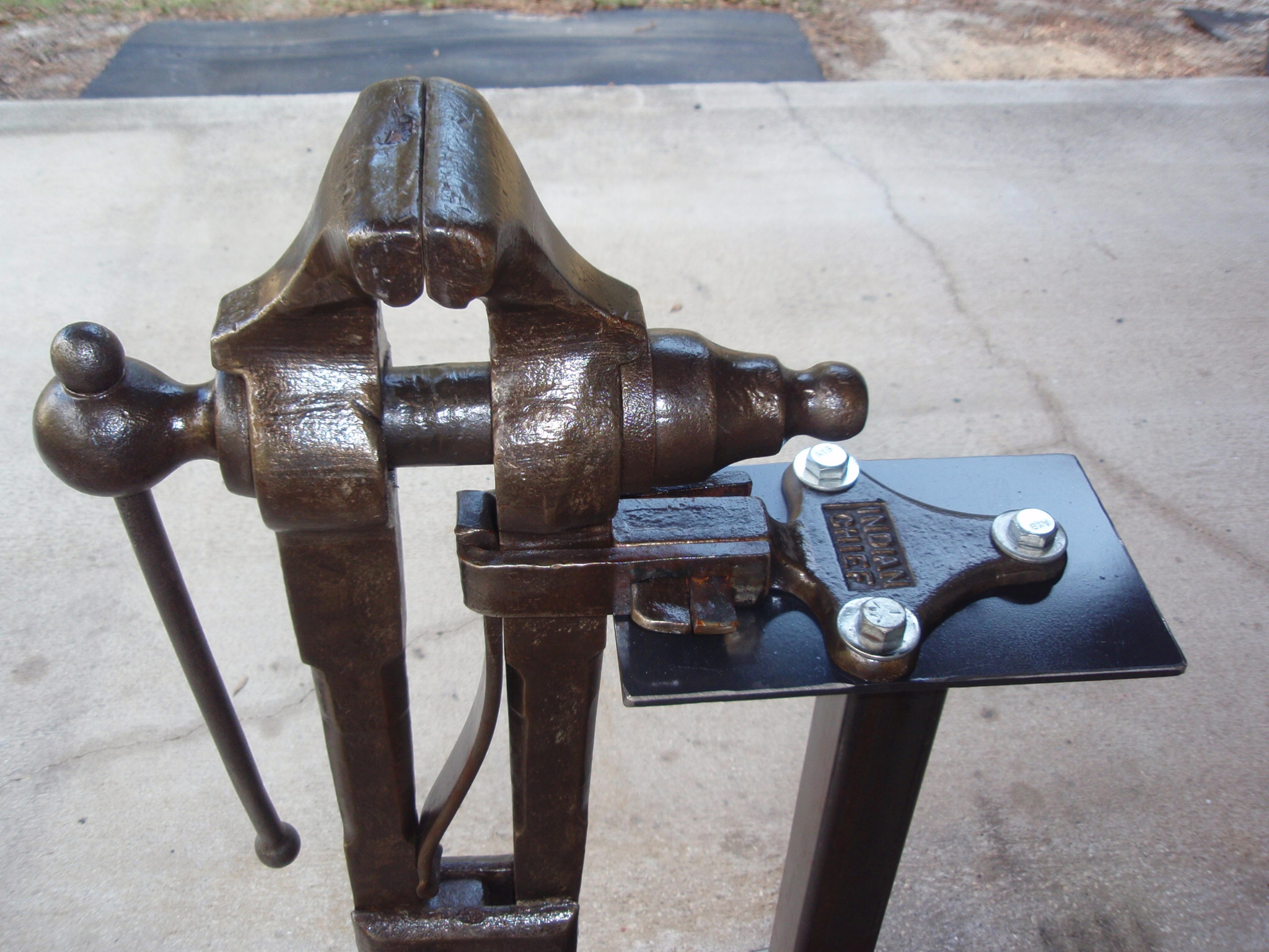

Thats Hot... Posted December 24, 2016 Share Posted December 24, 2016 When I open the vise it is tight ( it does not spin fast like a bench vise at all ) until it gets to about 3 to 4 " open. You can see the piece just past the handle in front of the jaw, it will spin when the vise is open about 3". This is my first post vise and all and all it is clean and straight, it just is tight to open. I am going to fab up a tray in the next few days. Quote Link to comment Share on other sites More sharing options...

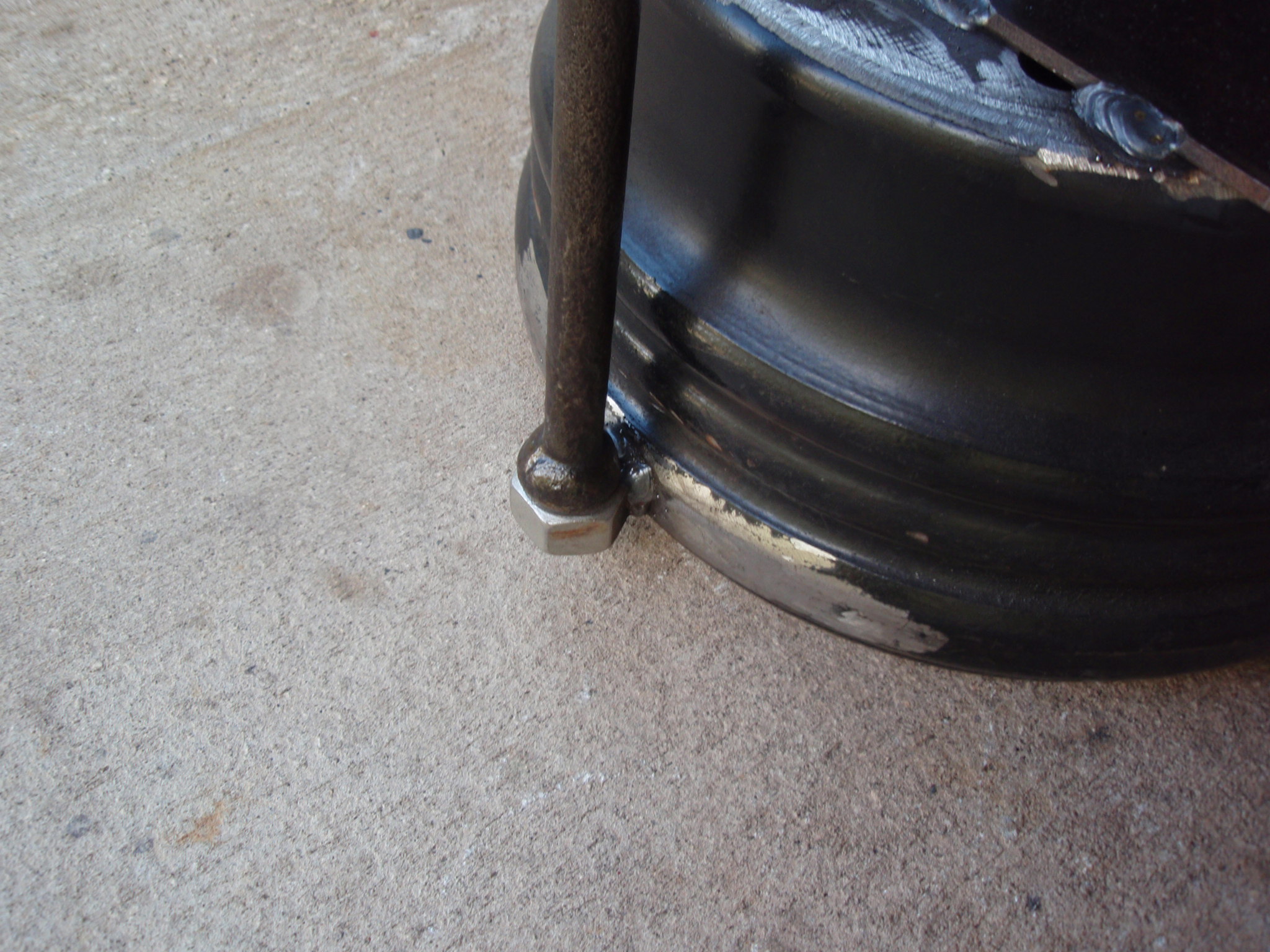

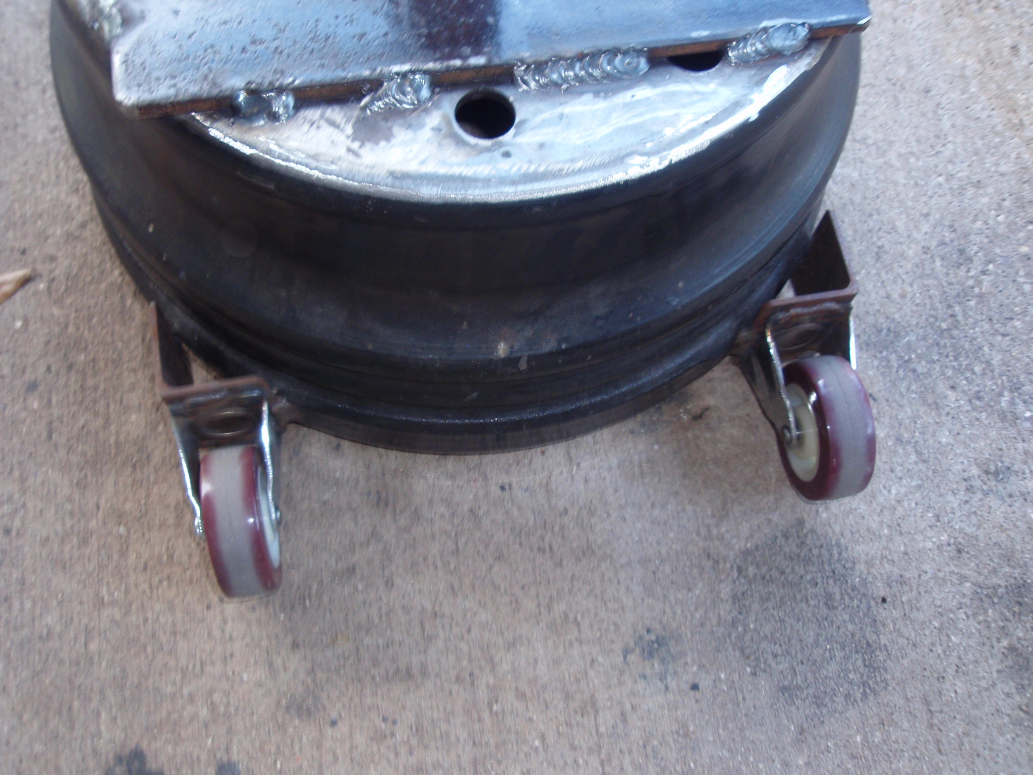

BIGGUNDOCTOR Posted December 25, 2016 Share Posted December 25, 2016 Probably just decades of old dried grease hanging it up. Unscrew the screw fully to clean, and clean the threads inside the screwbox as well. As to the base, brake drum bodies are cast iron so getting welds to hold is difficult. They may look good, but they tend to crack easily. Quote Link to comment Share on other sites More sharing options...
Thats Hot... Posted December 25, 2016 Author Share Posted December 25, 2016 1 hour ago, BIGGUNDOCTOR said: Probably just decades of old dried grease hanging it up. Unscrew the screw fully to clean, and clean the threads inside the screwbox as well. As to the base, brake drum bodies are cast iron so getting welds to hold is difficult. They may look good, but they tend to crack easily. I have 6 tools on these drums, And yes they like to crack. On this I turned up the to heat to 1/2 and let her rip... so far no pinging... The first one I did was for a bench vise using a Hobart 140 welder.... I think I can still hear. the pinging now. I need to fab up a tray soon In 2017 I am going to put a lot of time in to learning this art of Black Smithing . Quote Link to comment Share on other sites More sharing options...
Marc1 Posted December 25, 2016 Share Posted December 25, 2016 Cleaning the screw may help but my guess is that your hinge is too tight and dry. Pull the pin, move the moving jaw out of the hinge, examine the condition of the parts, and check for high spots or uneven wear that catch. Clean, smooth touching surfaces, grease and put all back. Quote Link to comment Share on other sites More sharing options...
Thats Hot... Posted December 25, 2016 Author Share Posted December 25, 2016 Thanks guys !! I now have it spinning with two fingers !!! Quote Link to comment Share on other sites More sharing options...

Thats Hot... Posted December 26, 2016 Author Share Posted December 26, 2016 14 hours ago, Marc1 said: So what did you do to it? I just unscrewed it and cleaned it all up. It was not in bad shape. I did use some PB Blaster when I put it back together. Quote Link to comment Share on other sites More sharing options...

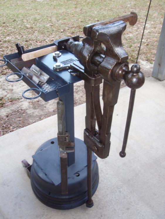

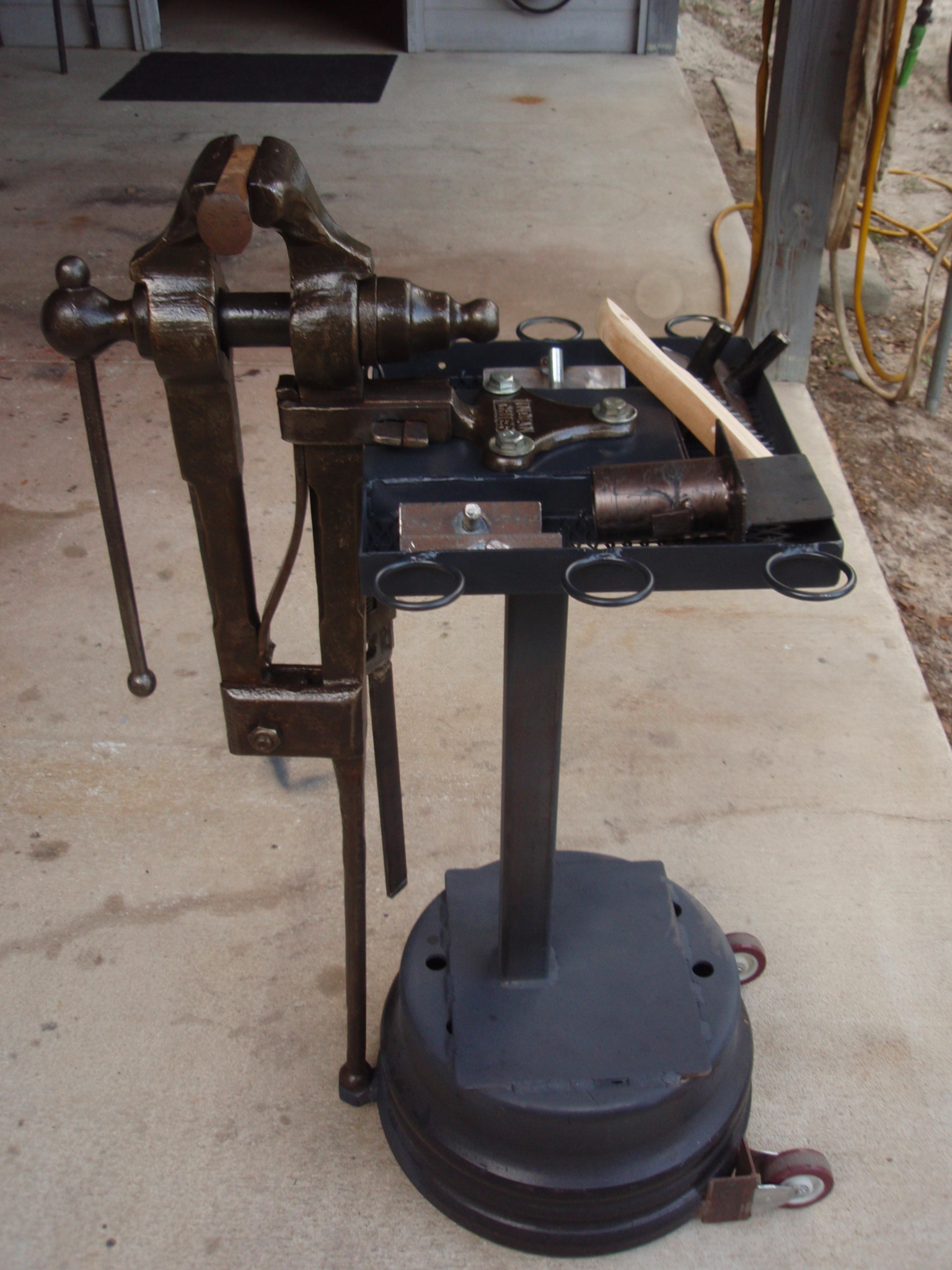

Thats Hot... Posted December 27, 2016 Author Share Posted December 27, 2016 It's up and ready, with the tray I fab up yesterday. I did not want the tray larger than the base of the stand.... one less thing to run into. Quote Link to comment Share on other sites More sharing options...
