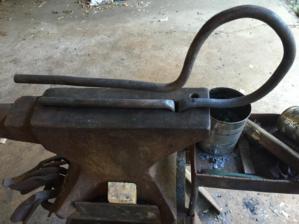

Blister Fingers Posted December 26, 2016 Share Posted December 26, 2016 What about the sway bar? That's a nice long hunk of thick round bar with a big hole punched in each end. Quote Link to comment Share on other sites More sharing options...

JHCC Posted December 26, 2016 Share Posted December 26, 2016 No, save the glass to use as flux when you get into smelting your own wootz. 11 hours ago, Blister Fingers said: What about the sway bar? That's a nice long hunk of thick round bar with a big hole punched in each end. Sway bars make nice spring swages: Quote Link to comment Share on other sites More sharing options...
BIGGUNDOCTOR Posted December 27, 2016 Share Posted December 27, 2016 Yep, forgot to mention the sway bars. Some are hollow nowadays. I have saved the glass as spares for my cars. I had a bunch of Toyota truck rear windows given to me , and I thought of using them for a blasting cabinet window since they were flat. If you need smaller rods/spring steel the rear seat frames are good. Quote Link to comment Share on other sites More sharing options...
