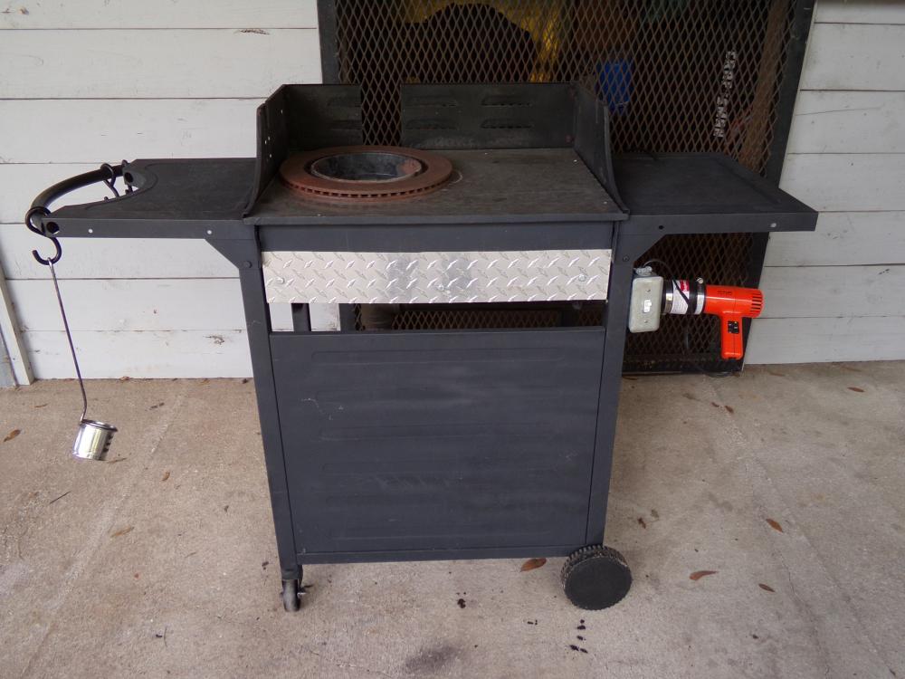

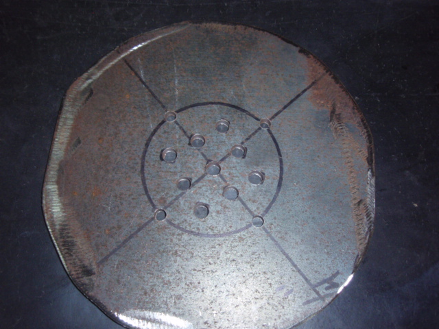

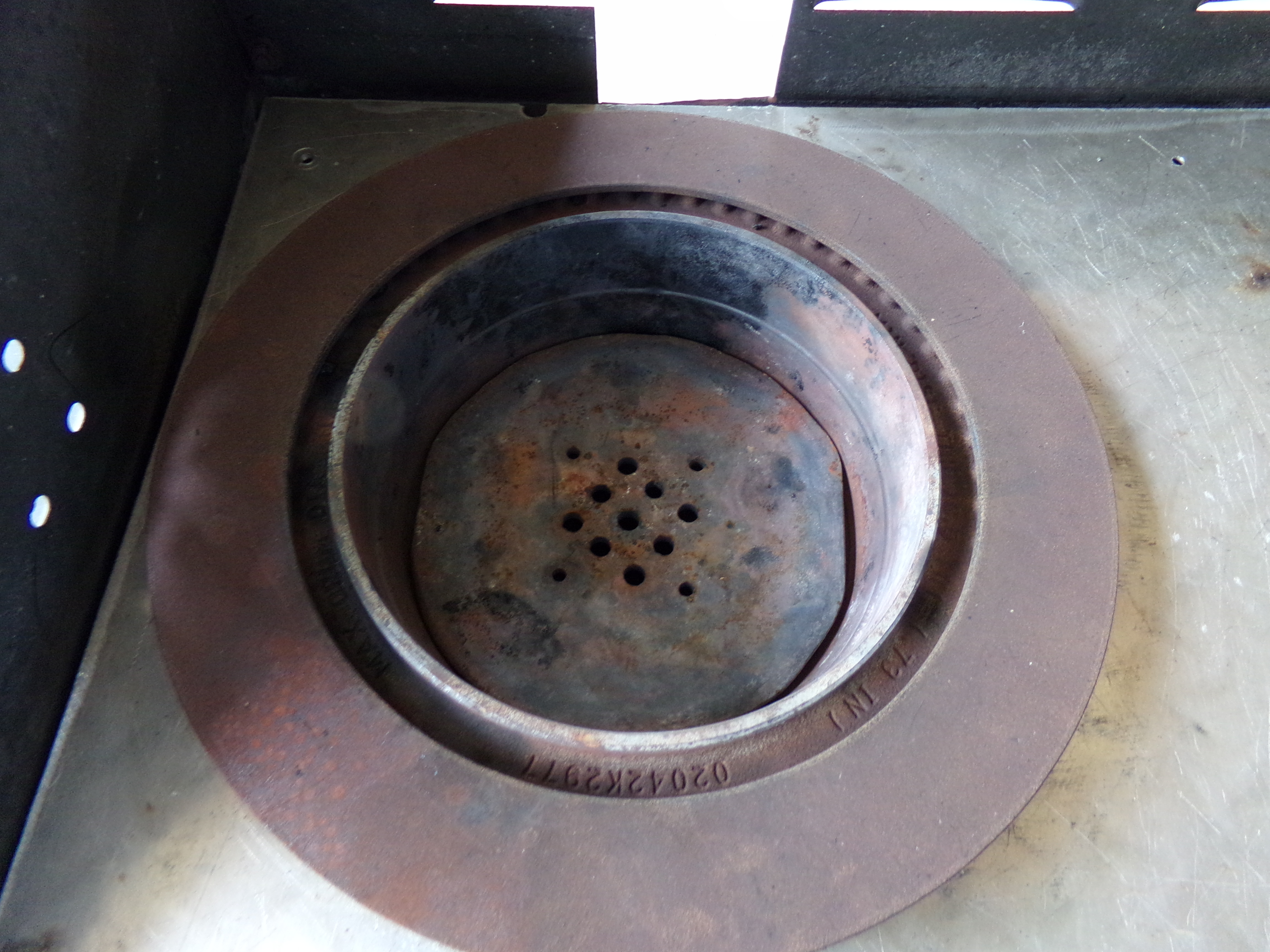

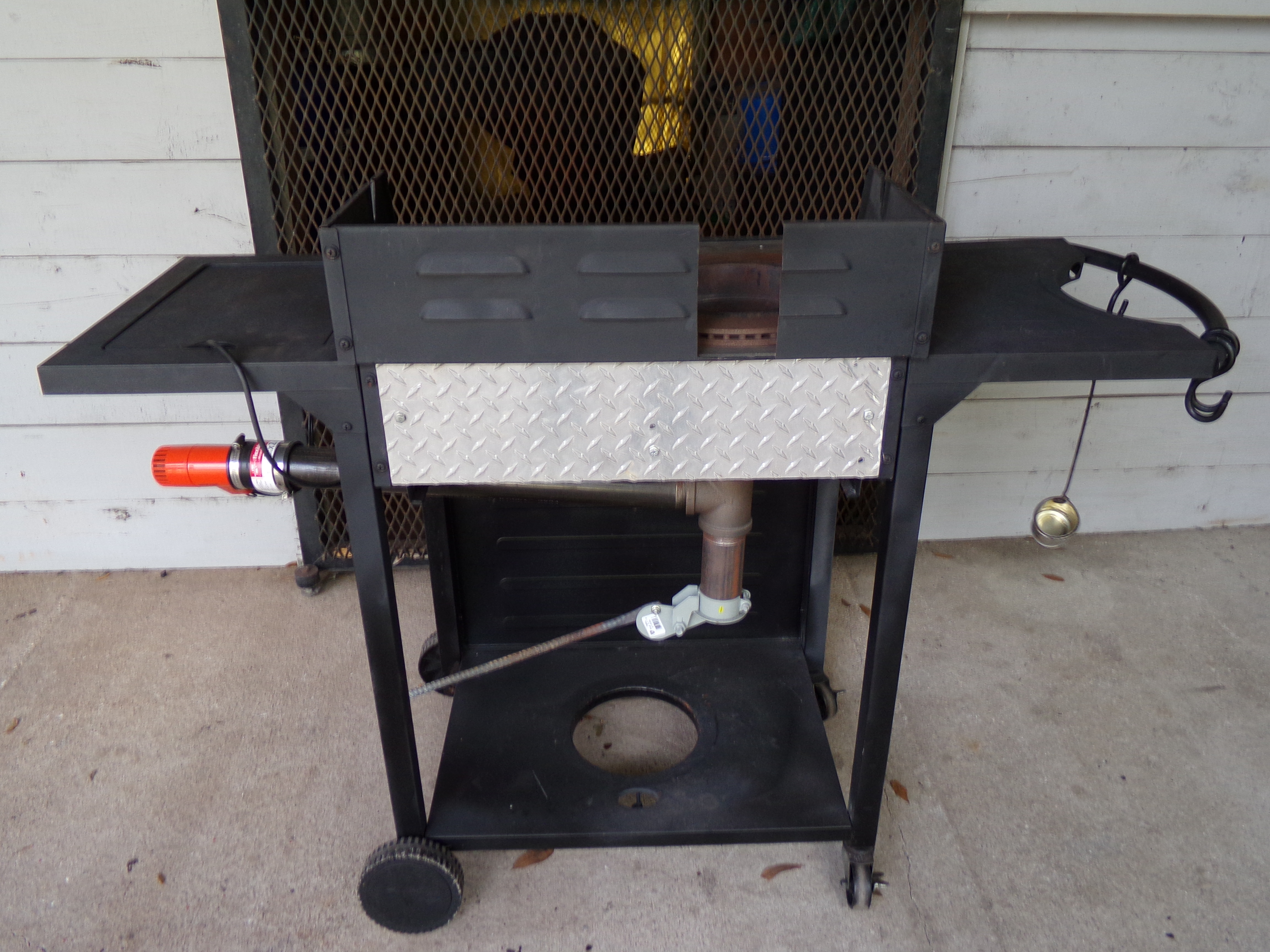

Thats Hot... Posted December 12, 2016 Share Posted December 12, 2016 This is what I use inside my rotor, so far this works for me. And like you I am just starting out. Here is the back of the forge.. Quote Link to comment Share on other sites More sharing options...
beard Posted December 13, 2016 Author Share Posted December 13, 2016 Good stuff guys. Thats Hot, I really like what you did with the grill. I've had this old 55gal drum behind the chicken coop for about two years and I don't think anybody else is going to use it so I think I might use that as the base for my forge. I had a feeling that the first rotor I got wasn't right for me. I hit up three more garages and the steel supply warehouse today. The only actual brake drum I found was a monster, and I came across another rotor that I think might be the one. I'll put the pictures of those two below starting with the rotor. I got my flange and T from the steel supply, and about 3' of 2" pipe. The price on the T was nuts, I almost told the guy to put it back. I'm going to see the man I got the first rotor from in a day or two about welding a few things, if he's got one he'll sell cheaper then I'm taking this other one back. Here's a few more pics of the scrap that I deal with. I figured somebody might enjoy seeing it. The first one is about a week worth broken or damaged parts I pulled off the wrecked bikes. The rest of them are what has accumulated in the dumpster over a couple months. There's a bunch of oddly shaped stuff in there. Quote Link to comment Share on other sites More sharing options...
