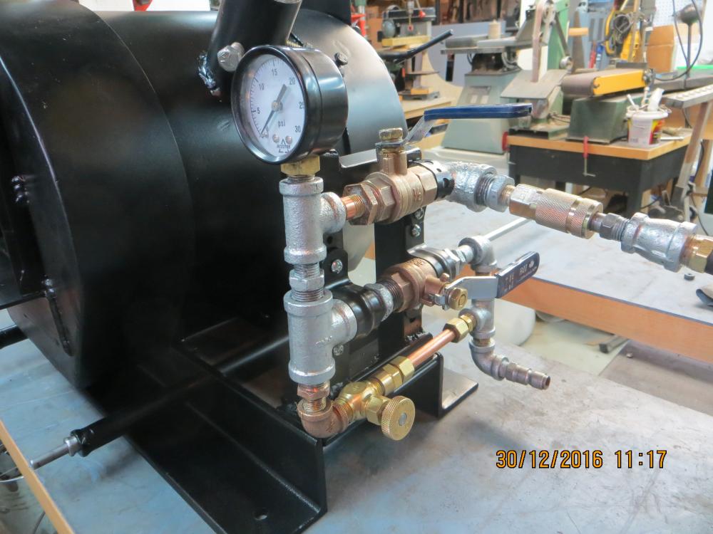

Hoenirson Posted January 2, 2017 Author Share Posted January 2, 2017 Forge metalwork is mostly done, all elements have been insulated. Both ends, doors and sacrificial insulation coatings are still baking hard, in the oven as I type this. So pics of the forge just before insulating will have to do. Front: Side and Gas Manifold: Rear with door in place: Firing it up revealed a few things. Positives: 1. Temperature ramped up good and fast with very little pressure. 2. Gas manifold did not heat up, so is far enough away from heat. 3. Bullet hinges works very smoothly with the heavy door. 4. Simple handle near 3:00 position of front door should stay nice and cool. (first forge project?) 5. 1 inch overlap of front and back stops 90% of hot gases at that joint. Small amount of heat emerges directed back along body of forge maybe an inch. Negatives: 1. A good amount of heat escapes up behind sliding doors, so handle will have to be redirected forward of the door, out of the path of the 'chimney' like heat exhaust. 2. Rear door now fits VERY tight on forge. Gently tapping it on and off seems to work. 3. Burner quick release needs to be upgraded to heavier duty version like the bottom one, as it proved intermittent. 4. A fine adjust (not the idle adjust) at base of manifold would be much handier than using the tank adjust. This would allow me to keep eyes on forge while adjusting temperature. 5. A fair amount of cement debris is being produced. I wonder if the ITC-100 I am still re-hydrating will eliminate this. Things to do: 1. Thicken coatings and bake on longer (in progress) 2. Fabricate long stock support surfaces for extensions. 3. Modify top of door slides moving handle forward of chimney effect. 4. Make a simple handle for front door. 5. Apply ITC 100 once cement coating stabilizes. 6. Build proper floor once kiln supplies gets here. Here is a quick video of forge so far (sans some of the insulation). As always, I remain thankful of all the help so far, and very interested in feedback. Happy New Year everyone! Quote Link to comment Share on other sites More sharing options...

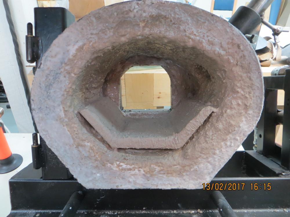

Hoenirson Posted January 4, 2017 Author Share Posted January 4, 2017 In the interests of sharing the bad as well as the good, I present my failed forge door souffle. And the more I added refractory to seal in the edge, the more it would curl up and pull away. This effect was less pronounced on the oval shaped ends of the forge, suggesting shape is a factor. In response the lining was broken to allow it to sit as flat as possible, and a metal lip is welded into place. This was then sealed in with more refractory. (Partially shown on later picture) The forge ends vertical plates are trimmed nearly flush to the forge top and extended over the top, to seal better when fully down. Lifting handles are added to each door, and finally a larger handle to open the front end. Quote Link to comment Share on other sites More sharing options...
ede Posted January 4, 2017 Share Posted January 4, 2017 I'm curious how your sliding door is going to work out. If I was going to make a sliding door, I would probably try one similar to Penland's. If you FF to 8:20 in the video, you can see they've rigged up a counterweight balance where one steps on a pedal to lift the loose fitting door up. I agree with Frosty on this one that your door will succumb to warpage. Quote Link to comment Share on other sites More sharing options...
ede Posted January 4, 2017 Share Posted January 4, 2017 2 hours ago, Hoenirson said: I present my failed forge door souffle. Hey, look it finally "blowed up" Quote Link to comment Share on other sites More sharing options...
Hoenirson Posted January 4, 2017 Author Share Posted January 4, 2017 Understood. If the doors get stuck I will report it. They are on VERY loosely. I will share that welding the lips on the doors did warp the rear sliding edge a bit and that bound the door up a bit tighter when closing but nothing a couple of wee taps with hammer corrected quick enough. The back door (the first one I built) has tighter tolerances than the quite floppy front slide. In the meantime this gives me something to do while: a ) some kiln shelves and supplies come in, b ) knee gets all healed up. Still hobbling about, but even that amount of activity helps rebuild strength. Plus limping in public is kept to minimum. Based on what this has taught me so far, I would be tempted to incorporate some holding edges into the oval forge ends as well. First though I want to see it after some actual forging use. That will be a while though. I have been rushing the cement to set and paid a price each time. I am thinking a week to air dry should be better, then oven bake, then some brief firings. Thanks for the feedback and patience folks. This has been a lot of fun so far, and beats surfing the couch while I heal up. p.s. When sourcing the hardware for all this, the clerk who was very helpful had a lot of doubts, and assured me he would watch for the newsreport of the nearby explosion, to see when my build was done. That gave me a laugh, thus the title. Quote Link to comment Share on other sites More sharing options...
Latticino Posted January 4, 2017 Share Posted January 4, 2017 Very glad you got rid of the quick release fitting on the gas train. You would be much better served with use of a true piping union fitting if you need to be able to take a joint apart for service. I don't believe that typical compressed air quick releases are rated for gas service. Quote Link to comment Share on other sites More sharing options...
Hoenirson Posted January 4, 2017 Author Share Posted January 4, 2017 Good point. Thankfully I found a propane parts supplier in Halifax, that can provide gas rated stuff. I am also hoping to replace the rubber hose with a stainless one. I have one propane rated one still on the rig for the feed from the tank, and the one that got removed LOOKED the same (doesn't fit any other male connector in my air parts pile) but was not. Quote Link to comment Share on other sites More sharing options...

Hoenirson Posted February 10, 2017 Author Share Posted February 10, 2017 Supplies have arrived! I received a large Alumina 5/8" kiln shelf sufficient to line a goodly portion of the forge floor, seal off the door ends, and have a wee bit left over. It was more economical to order a large shelf and cut down, then to order thinner smaller pieces. Also received was some Alumina Hydrate and some Sodium Silicate. I hope to use this for a couple of things. -1: stick the floor bits in place - 2: mix a refractory that doesn't continue to shed ceramic dust. Alternatively a wash that seals the ceramics down better. With the ITC100 coating applied, the dust is still pretty heavy, which makes me think my zirconia coating is at risk as well. I am thinking, that with these 2 ingredients and perhaps something to minimize shrinking, I can build a better refractory coating than what I have now. Reviewing iforge refractory discussions again, and keeping in mind that I have restricted refractory purchasing options here in Nova Scotia, here is what I am wondering about. For point one I found a reference to something potters call 'wadding' and 'kiln wash'. Quote alumina hydrate - Al(OH)3—... Used primarily for shelf wash and wadding—better adhesion and suspension than aluminum oxide (Al2O3)... Wadding = Alumina Hydrate (3 parts) + EDK / Kaolin ( 2 parts) Kaolin = 46% alumina, 54% silica Kiln wash = Kaolin + water The above reference then discusses methods to raise the melting temperature of the wadding Quote " How much alumina would you need to add to raise the melting point of epk? According to the diagram, kaolin (46% alumina, 54% silica) melts at 1800 C (3272 F). For some reason, at this level the curve stalls: You need to raise the % of alumina above 55% to raise the melting point. " I found what I believe is the source graph mentioned: This sure seems like a fine argument to mix up the thickest Alumina Hydrate recipe possible. Melting temperatures do seem high though, based on anecdotal evidence. Thoughts? Quote Link to comment Share on other sites More sharing options...
