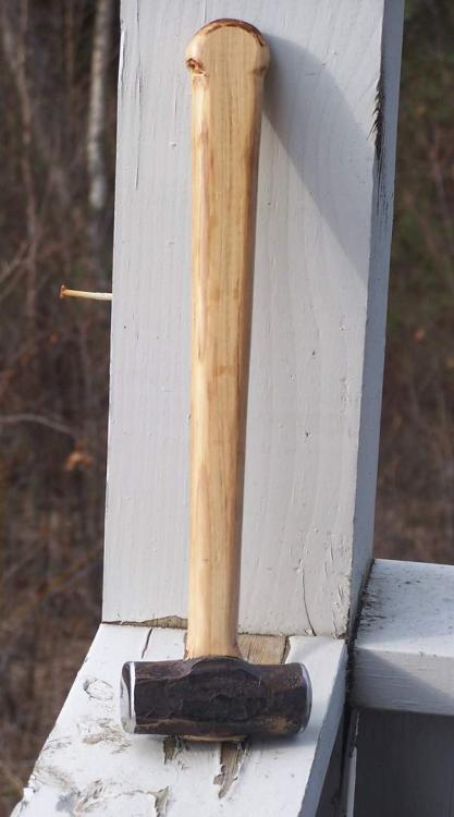

Frosty Posted November 21, 2016 Share Posted November 21, 2016 16 minutes ago, blacklabel said: Thanks Frosty! We did discuss handle lengths, I was told your hammer handle should be the same distance from where your wrist breaks to just about your funny bone. Sounds like a farrier to me, they tend to like long whippy handles. Pick what works best for you not someone else, there is a LOT of old school master, apprentice tradition to things like this. We're no longer practicing a commercial craft and individuality is allowed where it was often not tolerated at all in a working shop. My way or the highway was often how it was. I'd have to measure or gauge them but I think mine are closer to wrist to inside of my elbow joint. I have a template I use to make handles. I use 5/4" clear, tight, straight grain, hickory from a local hard wood supplier. I can call ahead and he'll lay a clear straight grain 5" - 6" x 8' board or two aside for me. I think most of the farriers and many of the smiths in the Valley get their handle stock from him. Nice guy, reasonably discounted prices for us too. When I make a hammer head I use a rectangular drift I made from a rail clip for the eye. The rectangular eye drift is much easier to get straight and square than an oval drift so my hammers come out true more easily and require less tweaking. I much prefer to buy an undressed hammer and dress it myself. It's not like it's difficult and I get to decide on the crown and edge radii. Then again I've been playing blacksmith a long time and have developed preferences that work for me. Below is the first hammer I made with MUCH help from Metalmangler, (Mark). It's about 36 oz turning hammer made from a broken Ford pickup axle, Mark's pickup unfortunately. The handle is actually shorter than it looks but the pic shows the taper well enough. I put the knob on the end just in case it slipped in my grip. The taper has made that a complete thing of the past bu the knob has sort of become a brand so all my handles get one. Frosty The Lucky. Quote Link to comment Share on other sites More sharing options...
