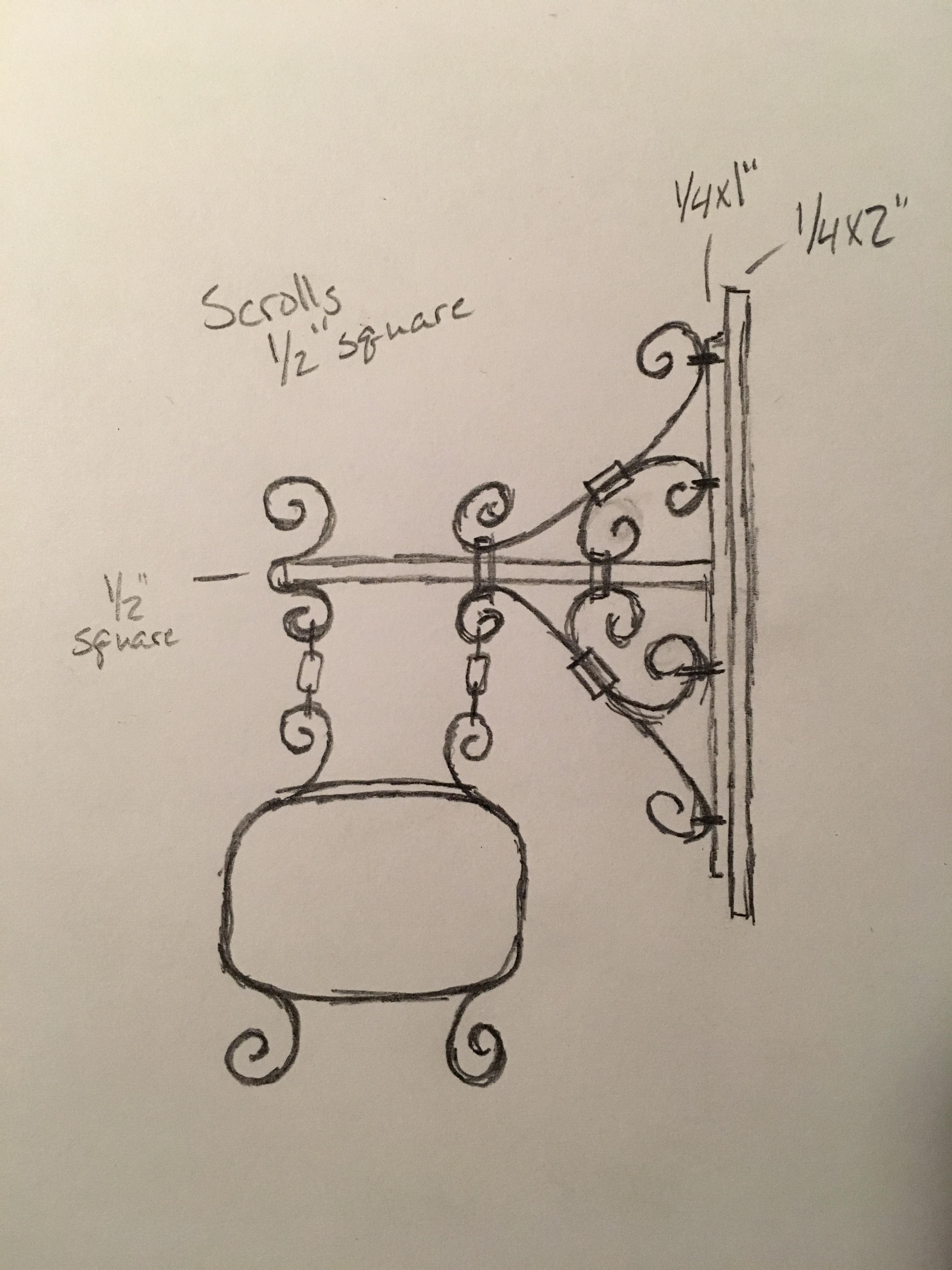

Michael Cochran Posted November 17, 2016 Share Posted November 17, 2016 I have been wanting to do all sorts of projects lately to test and expand my skill set and now it's time to build a sign to hang outside my shop. I was going originally going to do something really plain (basically a shelf bracket with a couple scrolls with a yankee tool cast iron anvil) but have decided that won't do. I have attached the third sketch I did today for someone to guide me a little. Each sketch was a little different and progressively more complex. I might be biting off more than I can chew but figure someone might see the sign and it might lead to more projects. I have notes scribbled on the sketch but will answer any questions you guys have. I'm planning on collaring the two scrolls on top together and the same with the bottom as well as collaring between the top and bottom. On the upright I'm debating on rivets or plug welds from behind. The sign panel will probably be 16 gauge sheet held in place by friction. I'm thinking that I can have the side pieces closed in a little tight and notched so that it holds the sheet in place. I'm planning on welding up the six or so links of chain from some 1/4 or 5/16 round I have laying around. The panel has changed shape with every sketch, it started as a horizontal oval then went to a wierd rounded rectangle with a wide top, now I'm at a rounded rectangle with more even sides. If anyone sees and glaring flaws that my inexperience prevents me from seeing please feel free to tell me. Any suggestions including a change in stock sizes is welcome. Quote Link to comment Share on other sites More sharing options...
ThomasPowers Posted November 17, 2016 Share Posted November 17, 2016 think of a bracket for side to side forces as well. Quote Link to comment Share on other sites More sharing options...
Lou L Posted November 17, 2016 Share Posted November 17, 2016 I can't speak much to the stock sizes with experience but I can toss out guesses. Assuming you aren't hanging a solid steel sign it appears to be plenty sturdy to me. The lighter stock seems a good choice to me. Thicker stock adds more weight which makes attaching to a wall and collaring more complex. I would attach (countersink and weld) posts to the 2" wall flange and run them through holes in the 1" flange. You could thread them to make detaching from the wall easier) or peen them. Not sure if I make sense here. Either way, I think it's a great design. Wherever possible try to make the connection points visible. It will accentuate the hand made aspect of the sign. Lou Quote Link to comment Share on other sites More sharing options...
Glenn Posted November 17, 2016 Share Posted November 17, 2016 Make the sign part out of cardboard and hang it on the building for size reference. Back off to the point where you would first see the sign approaching the building and calculate the size where you would be able to see and or read the sign. Old time signs were very large so they could be seen from a distance. After all it is your advertisement and calling card on display. One half inch solid bar may be visually a bit small to be seen from any distance. You may want to consider flat bar or angle iron for the thickness necessary to be seen as well as a lighter weight. Another way to get size prospective is to photograph a sign that you can easily see and them measure the size of the sign and lettering against a known distance, such as the door to the building. The sign and lettering dimensions will work out to be very large to huge in some instances, but remember that you had no trouble reading the sign from your viewing distance. There is also the traveling speed of the viewer that needs to be factored in if your close to a road, etc. Quote Link to comment Share on other sites More sharing options...

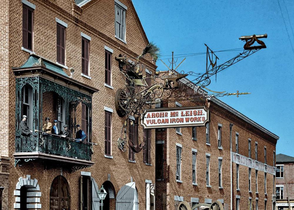

John McPherson Posted November 17, 2016 Share Posted November 17, 2016 If you want to set the bar reeeeaally high, I give you Archibald McLeish - Vulcan Ironworks, Charleston, SC. 1865, (at the end of The Recent Unpleasantness, as noted by the boys in blue.) This is a study in ornamentation as well as engineering. Quote Link to comment Share on other sites More sharing options...
Alan Evans Posted November 17, 2016 Share Posted November 17, 2016 Is that "swords into ploughshares" or the other way around? Alan Quote Link to comment Share on other sites More sharing options...
Michael Cochran Posted November 17, 2016 Author Share Posted November 17, 2016 Thank you all for the comments. Id like to start off by saying my shop is in my back yard and few people (maybe 20) will ever actually see it in person. I was already looking at lettering sizes before I determined the final size of the sign. However this does have a limited amount of space to be able to mount, between the roof line and garage door. I'm headed out the door for my day job right now but will come back and reread the comments and address them one by one when I can. Quote Link to comment Share on other sites More sharing options...

JHCC Posted November 17, 2016 Share Posted November 17, 2016 4 hours ago, John McPherson said: If you want to set the bar reeeeaally high, I give you Archibald McLeish - Vulcan Ironworks, Charleston, SC. 1865, (at the end of The Recent Unpleasantness, as noted by the boys in blue.) This is a study in ornamentation as well as engineering. That gives a whole new meaning to the term "wall anchor". Quote Link to comment Share on other sites More sharing options...
ThomasPowers Posted November 17, 2016 Share Posted November 17, 2016 And I get the urge to walk in the middle of the street... Quote Link to comment Share on other sites More sharing options...
Michael Cochran Posted November 17, 2016 Author Share Posted November 17, 2016 As stated, this project is more for myself than anything. Im planning on posting a picture of the sign on Facebook and twitter for a little advertising so it will have lettering. I hadn't considered bracing for side to side movement but will take that into account. I really don't know what else to say now since I'm a little lost. Quote Link to comment Share on other sites More sharing options...
ThomasPowers Posted November 17, 2016 Share Posted November 17, 2016 So plan it in steps and do them as you find them doable. (planning to make it easily demountable might be step 1. We get a LOT of wind out here 50 MPH is not uncommon and my first year out here we had 80 MPH straight line winds so designing stuff to swing in them and have side force bracing is natural. Quote Link to comment Share on other sites More sharing options...

Michael Cochran Posted November 17, 2016 Author Share Posted November 17, 2016 2 hours ago, ThomasPowers said: So plan it in steps and do them as you find them doable. (planning to make it easily demountable might be step 1. We get a LOT of wind out here 50 MPH is not uncommon and my first year out here we had 80 MPH straight line winds so designing stuff to swing in them and have side force bracing is natural. First step is building a jig to make the scrolls. Then I have to build a jig for the collars. Then I have to . . . I might make it removable but I don't know just yet. I like the idea and might incoperate Frostys suggestion of a dovetail he made in another discussion. 1 hour ago, jwilson645 said: Mike, that is quite a good looking sign. I have some 16 gauge sheet and other stock laying around so come see me before you go buying anything. I appreciate that. I was already thinking about what I had to buy to do this project and the biggest thing would have been the sheer. I think most everything else is in one of my piles around my shop. I might have to work Saturday but won't know for sure until tomorrow. Quote Link to comment Share on other sites More sharing options...

Frosty Posted November 19, 2016 Share Posted November 19, 2016 About high wind areas and signs. Be sure the part of the wall is strong enough to take heavy dynamic, lateral loads. It's not so hot to have a sign strong enough to withstand high winds if it rips pieces out of the wall. Thanks for the proportion drawings Vaughn good info. Who knows maybe I'll make a sign someday. Working with the sign guys in highways maint. there was an old adage went something like, "If you can't read it through a foggy windshield at 50mph. it's not a sign. On the road side I'd use symbolism and something catchy say. BIG anvil with a smith behind it pointing up the driveway with the tongs. Anvil horn pointed up the drive too. Can't hurt to double down on the message. Of course the smith in the sign wouldn't really be behind it, just a silhouette on top of the anvil, it'd look the same from both directions. Then again you might have a neighbor who drove from the "backside" you wanted to receive a different message. Hanging one for you own satisfaction is a good thing IIRC they're called "vanity signs," though I don't think that always applies. Something cool that puts a smile on your face is perfect. At one point I was going to cut out a BIG letter E from sheet steel and hang it over the door then time folk to see how long it took to figure out the word play. Frosty The Lucky. Quote Link to comment Share on other sites More sharing options...
