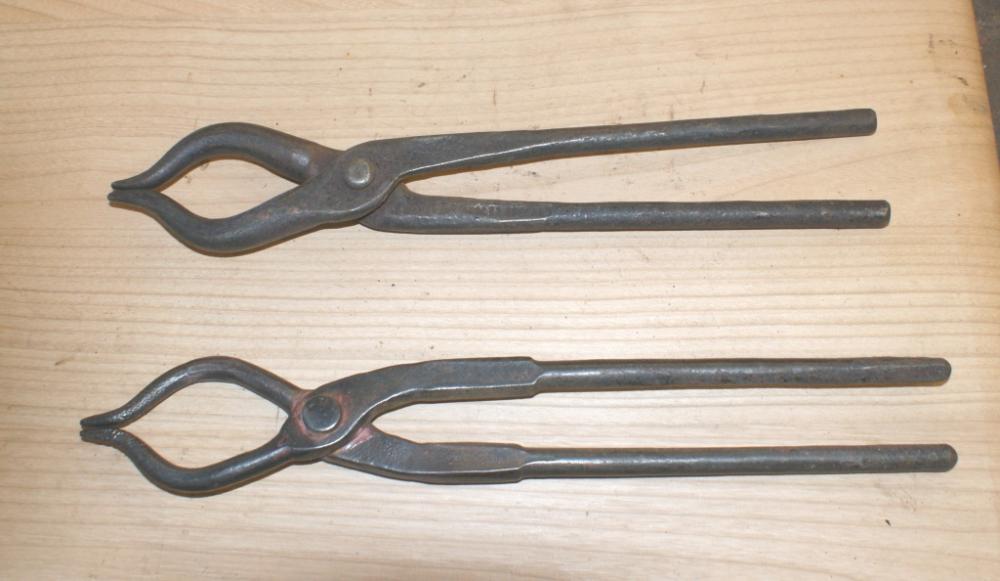

John McPherson Posted November 3, 2016 Share Posted November 3, 2016 I have seen them identified as bow pliers or collaring tongs by UK smiths, and they seem to be a staple item in use by the Lohars of India. Quote Link to comment Share on other sites More sharing options...
Matthew D Posted November 3, 2016 Author Share Posted November 3, 2016 Thanks for all the replies. John, thank you for posting the photos and information about "bow/collaring" tongs. I also noticed that this pattern of tongs are used by the Indian Lohars in the videos posted online. I have also noticed that they are used by the Nepalese and Filipino blacksmiths. I am sure other smiths from around the world use them as well. Why are they so common? One thought is that they are very versatile and I want to understand why. The pattern seems to be used among blacksmiths from many parts of the world which leads me to believe it is a very old pattern. The small amount of contact by the tong tips to the work piece would enable the smith to exert a lot of PSI in one small spot, translating to a strong grip on the material without exerting much energy. The long jaws and small tip permits the smith to maneuver the work piece in all sorts of directions. I see smiths who lay the work piece flat, on edge, etc to do their work. Also, the smiths we see using these tongs, tend to specialize in just a few types of work, or at least that is what the videos tend to show. They are also relatively poor, so having many tongs is not practical. I have seen the Filipino smiths use a type of top tool holder/tong made from bamboo. Seems like a blacksmith who does a variety of tasks tend to have tongs for all sorts of different uses and sizes of materials. I have made all my own tongs this past year, and some are more useful than others. I have 7 pairs now. My first two pairs were made without tongs. I keep making them and am getting better all the time. I can see how different types of tongs sold different sorts of problems. For example: Holding a horseshoe being forged versus holding a hot horseshoe when shoeing a horse. Or holding a bolt with a head and forging the shank. Or a blade of a particular size. Every time I watch one of the foreign smiths I learn some new things. Quote Link to comment Share on other sites More sharing options...

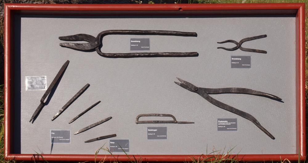

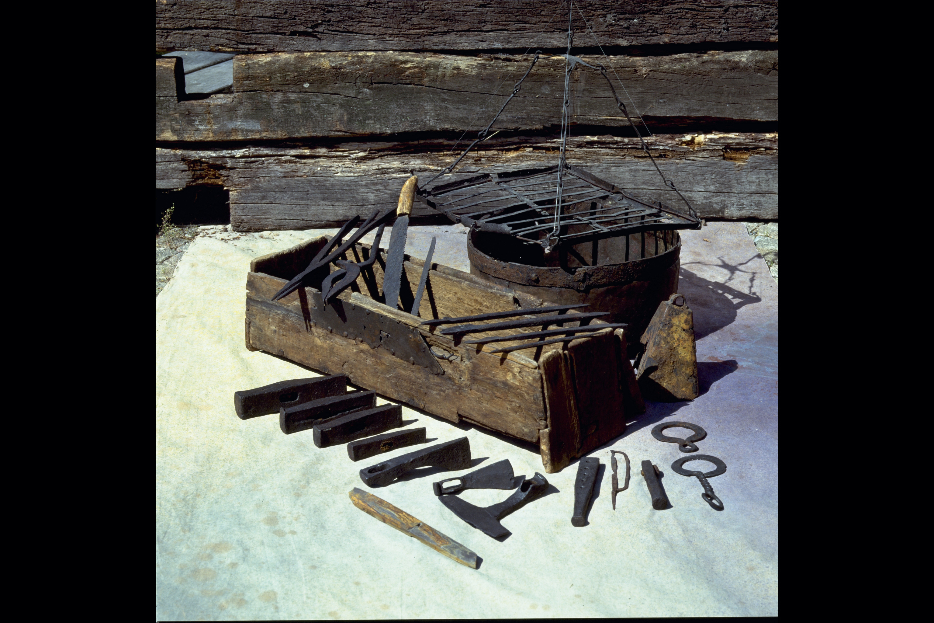

John McPherson Posted November 4, 2016 Share Posted November 4, 2016 Ancient pattern, indeed. Here is a picture of the Viking age Mastermyr tools, and reproductions. Quote Link to comment Share on other sites More sharing options...

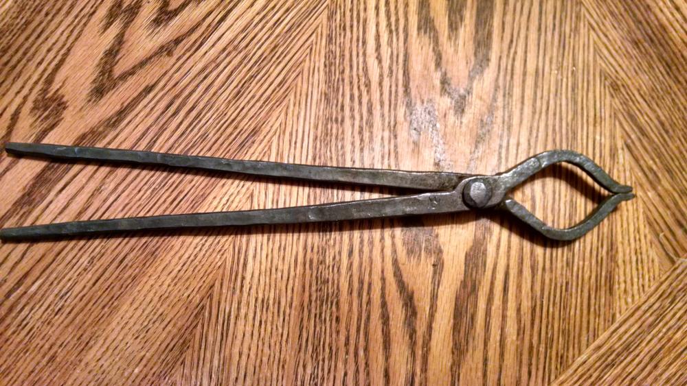

Matthew D Posted November 6, 2016 Author Share Posted November 6, 2016 Finished my African style tongs this evening. I made them from 5/8 round stock I picked up from a cattle ranch bone yard. Seems like some sort of medium carbon steel. Reigns are about 12 inches long and the jaws at the tip are a little shy of 5/16 wide. Haven't had a chance to really test them out yet. I'll let you know how they work in a week or so as I use them. I am getting better at making tongs and find that making them is a good practice in several blacksmithing skills. Setting down, drawing out, punching and riveting. Also, barring out the reigns, making bevels, bending and planishing. After making 8 pairs of tongs the last 12 months, I am getting better. Quote Link to comment Share on other sites More sharing options...
metalmangeler Posted November 6, 2016 Share Posted November 6, 2016 having the grip farther from the rivet allows for more range of grip especially with the grip being rather small in a lot of ways a pickup tong, this allows for the stock to change size as forged without changing tongs. Also if lacking resources less tongs in the shop. Quote Link to comment Share on other sites More sharing options...
Matthew D Posted November 8, 2016 Author Share Posted November 8, 2016 Went searching the internet for some photos and drawings of the old world pattern tongs. Came across this article. The discovery was made in 2014. Notice the tongs. Again it is that same pattern. http://sciencenordic.com/viking-blacksmith-buried-his-tools Quote Link to comment Share on other sites More sharing options...
gote Posted November 15, 2016 Share Posted November 15, 2016 This is part of "Sigurdsristningen" showing Sigurd/siegfrid (right) licking the blood from the dragons heart which he holds in his right hand and the dead smith to the left and smiths tools between them. Obviously the most common design in Viking times. Quote Link to comment Share on other sites More sharing options...
Mark Ling Posted November 18, 2016 Share Posted November 18, 2016 On 11/5/2016 at 8:55 PM, Matthew D said: Finished my African style tongs this evening. I made them from 5/8 round stock I picked up from a cattle ranch bone yard. Seems like some sort of medium carbon steel. Reigns are about 12 inches long and the jaws at the tip are a little shy of 5/16 wide. Haven't had a chance to really test them out yet. I'll let you know how they work in a week or so as I use them. Almost remind me of hammer eye tongs with the small amount of contact with the steel, and that they're very versatile. Littleblacksmith Quote Link to comment Share on other sites More sharing options...
SJS Posted February 19, 2017 Share Posted February 19, 2017 Ratios are still important, even though the point of contact is small 5/16" the distance to the rivet, and the length of the reins play a role in how well it grips. In general longer reins and shorter jaws give you more leverage and a tighter grip. The overall springeyness of the reins does make it feel like you can grip better. The stock gripped will tend to be able to pivot at the point of contact thought. For manipulating chunks of steel, like a hammer head, and using top tools on it thats fine. But gripping a thick bar and whaling away on it trying to reduce it, or draw it down, might be more difficult, even with the spring tension advantage... Mathew D look up some of the threads about Habbermann tongs, you will see a very similiar springeyness in the design. The hammer eye tongs used in the tool making curriculum is based on Habbermann's ideas Quote Link to comment Share on other sites More sharing options...
