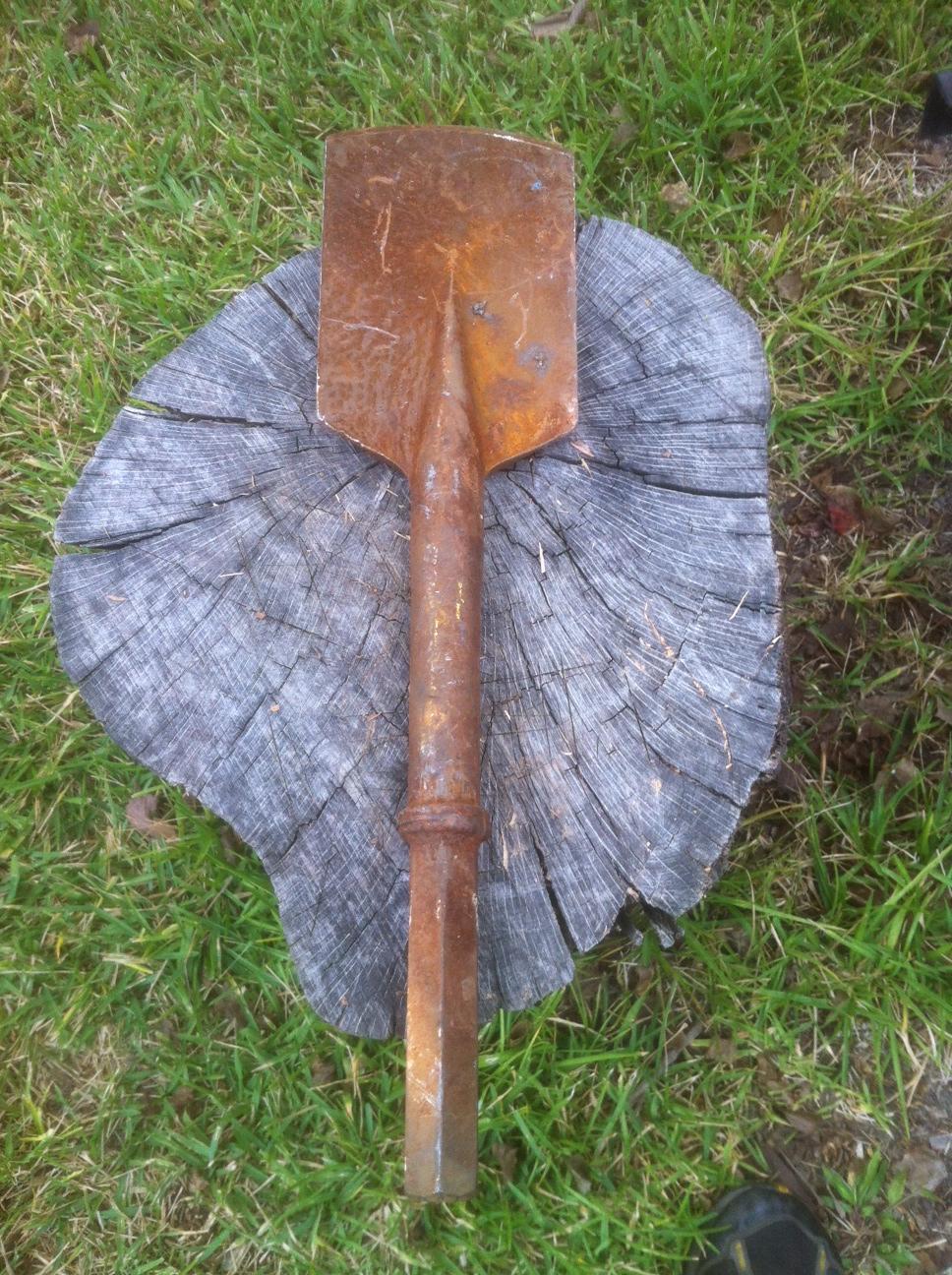

Rmartin2 Posted October 28, 2016 Share Posted October 28, 2016 I found this at the scrapyard and was wondering what it is made out of and will the shaft be good hammer material. The round shaft is about 1.5" diameter. Quote Link to comment Share on other sites More sharing options...
swedefiddle Posted October 28, 2016 Share Posted October 28, 2016 Good Morning, Breaker Bits are usually made from 1045 to 1055. It would work well for a Hammer. Clay Spades are either 1 1/8" or 1 1/4" Hex. I reforge lots of Breakers, I use Water to quench, draw the temper to a light straw, before Blue. Neil Quote Link to comment Share on other sites More sharing options...
Rmartin2 Posted October 28, 2016 Author Share Posted October 28, 2016 Good to hear. Thanks Neil! Quote Link to comment Share on other sites More sharing options...

BIGGUNDOCTOR Posted January 8, 2017 Share Posted January 8, 2017 That breaker bit looks in great shape. Have you looked into selling it? Quote Link to comment Share on other sites More sharing options...

Adun Clebr Posted January 13, 2017 Share Posted January 13, 2017 On 1/8/2017 at 4:46 PM, BIGGUNDOCTOR said: That breaker bit looks in great shape. Have you looked into selling it? My thoughts exactly... Unless you just want to use it to make a hammer, those are easily $120.00+ bits (new). So, if you got it at scrapyard price... Anyhow- please post your hammer-making progress; that's cool, too. Quote Link to comment Share on other sites More sharing options...
rockstar.esq Posted January 20, 2017 Share Posted January 20, 2017 I stopped by the local home improvement center in the rental section to see if they had any worn out jackhammer bits. I was given all I could carry free of charge. I offered to pay for them but the manager just laughed and said I was doing them a favor by taking all the dull stuff away. One neat thing about those large 1-1/4" bids is the bolster at the chuck end. That's just about perfect for a hardy tool. Grind four faces to fit your hardy hole and the bolster diverts any hammering force into your anvil. I made a nice straight bick out of one. Quote Link to comment Share on other sites More sharing options...
ThomasPowers Posted January 20, 2017 Share Posted January 20, 2017 I like the sq ends on sucker rod for that use too, of course you need to source rod that the wrench flats fit your hardy... Quote Link to comment Share on other sites More sharing options...

Jasent Posted May 15, 2017 Share Posted May 15, 2017 I have that same bit and was thinking of using it to make an ax drift Quote Link to comment Share on other sites More sharing options...
dickb Posted May 25, 2017 Share Posted May 25, 2017 Many tool rental shops have used jackhammer bits that they just throw away. I think they include the cost of a jackhammer bit in the rental price. Maybe to limit their liability is renting a used and possibly damaged piece of hardware. They work fine for hardy tools. After forging to shape and grinding, I use them as is without any heat treating. They are plenty tough enough and easy to dress with a file if you miss the work and hit the tool with the hammer. Quote Link to comment Share on other sites More sharing options...
