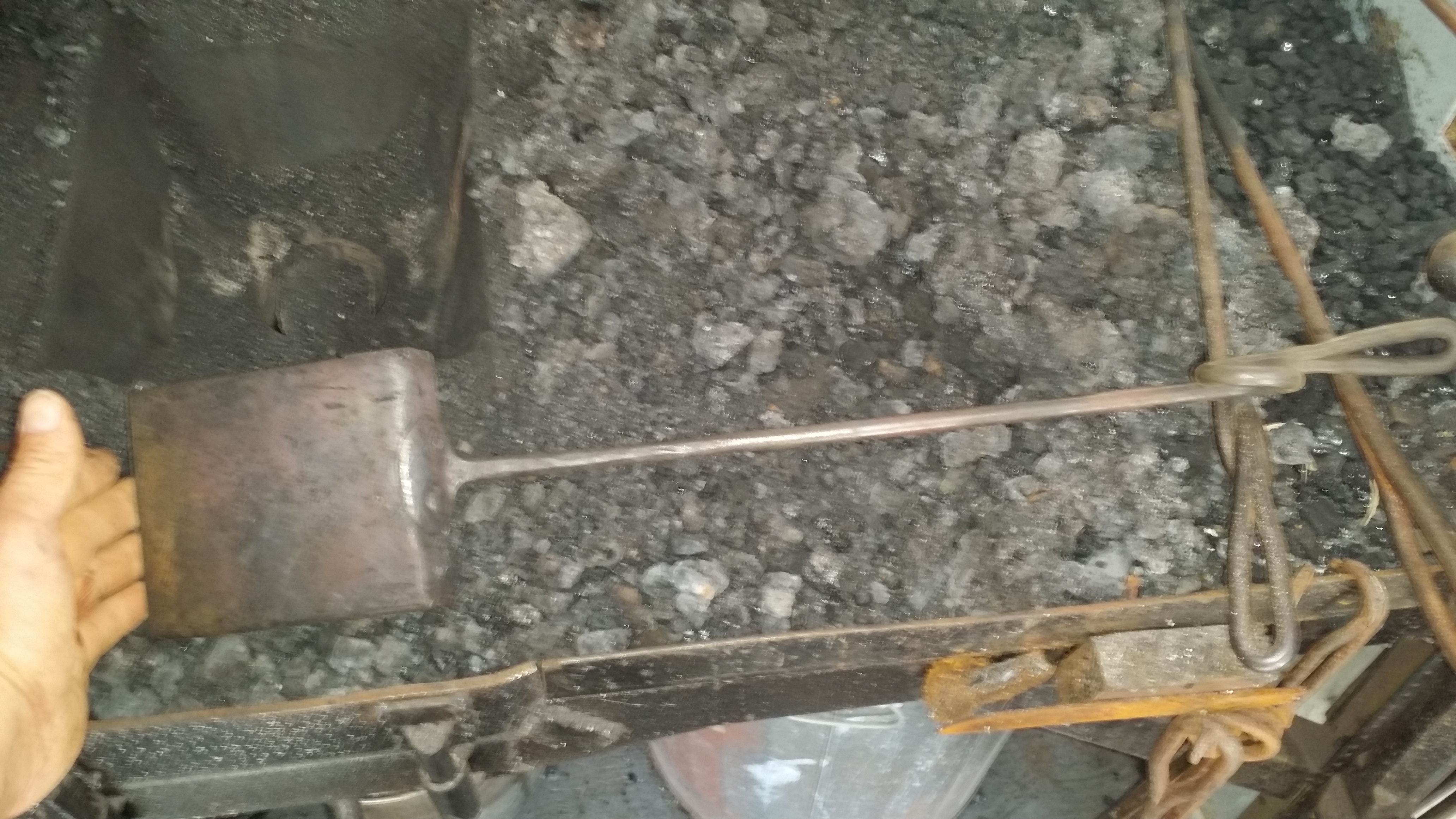

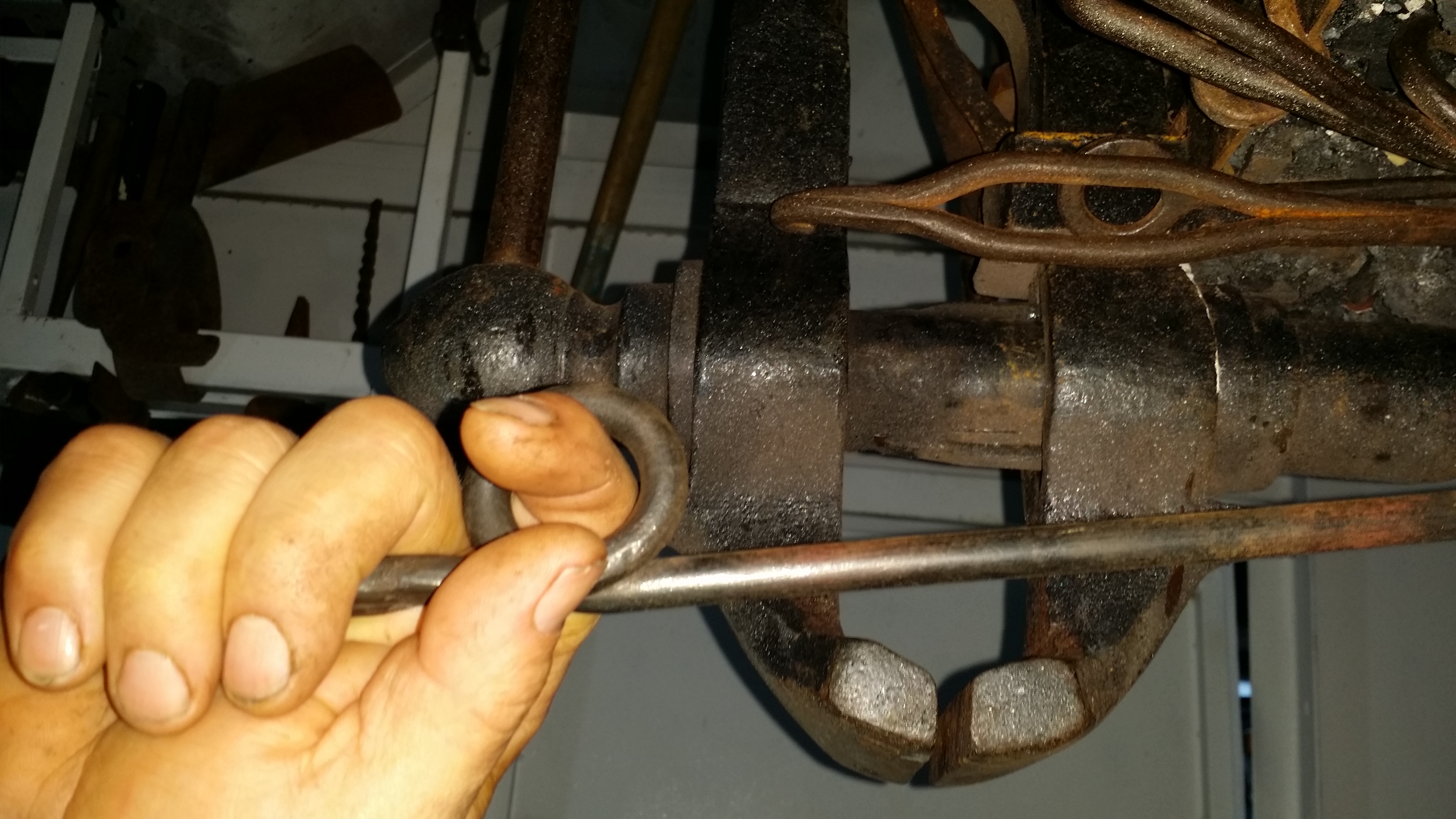

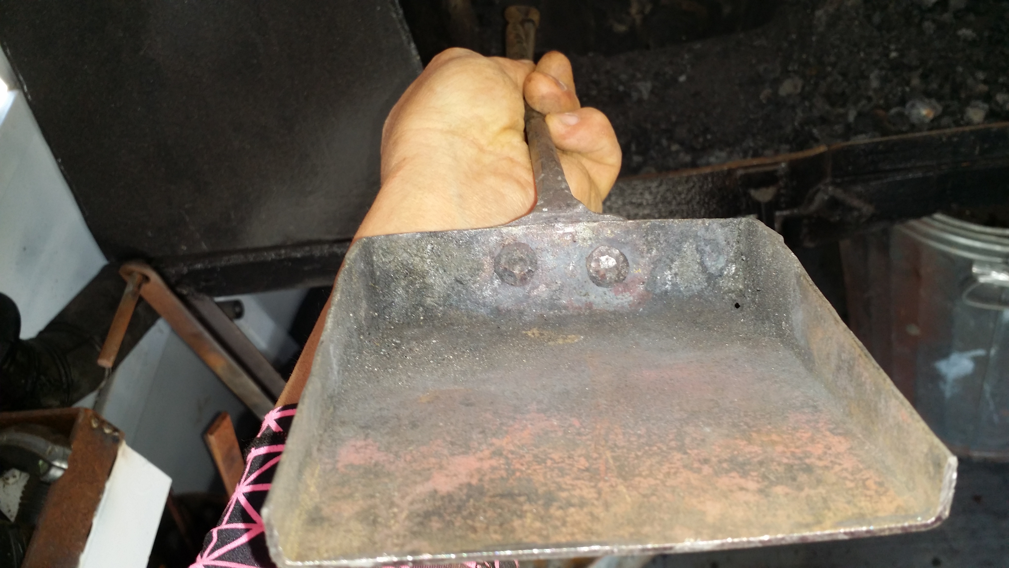

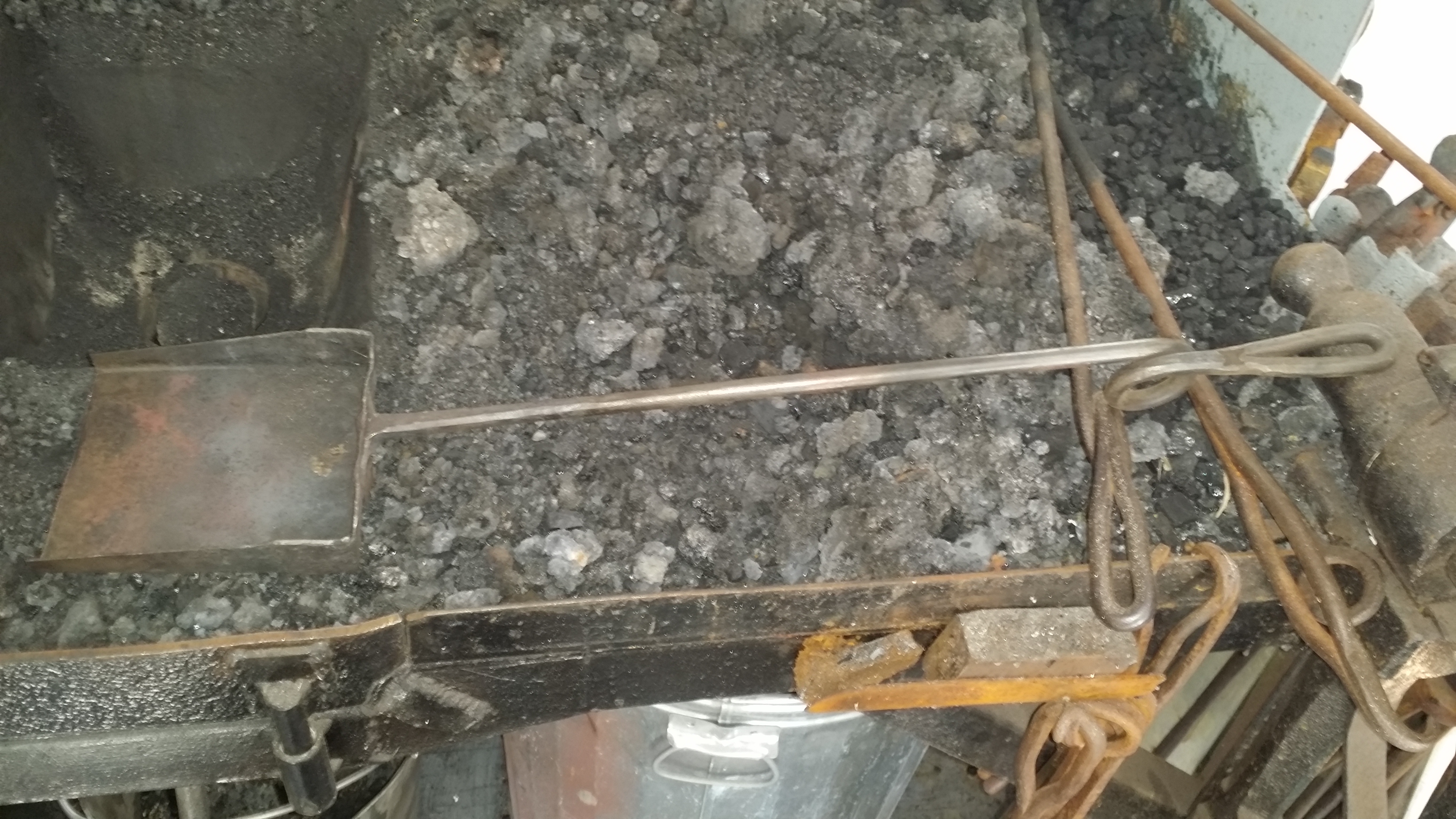

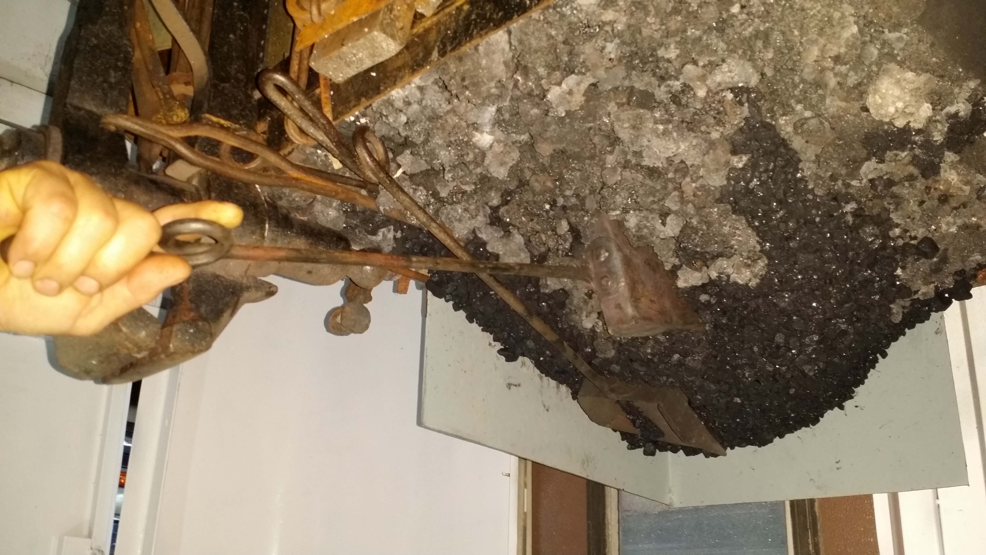

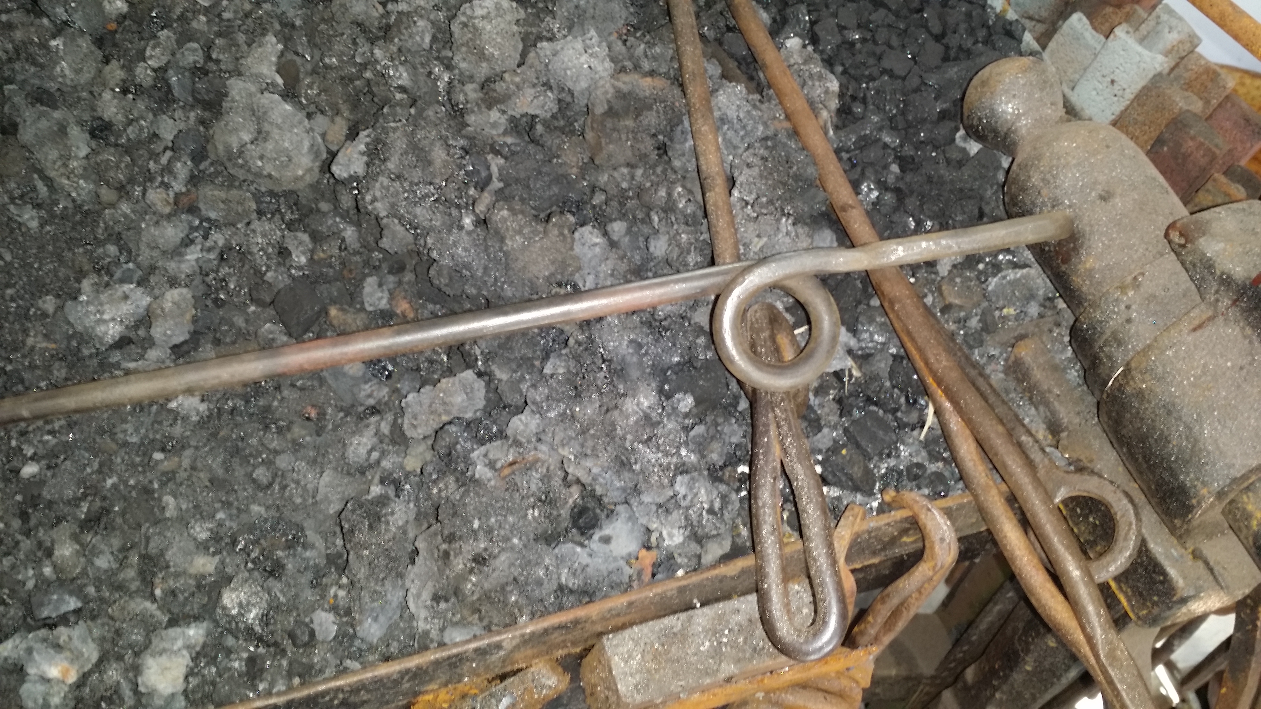

aessinus Posted October 13, 2016 Share Posted October 13, 2016 "I'll post up another thread on farrier tools if you'd like.. " Please do. There may be a couple of folks here who like tool pictures 17 hours ago, jlpservicesinc said: Got one shovel done with the pattern I prefer.. Here is 1.. I will make 3 more.. But here is the start's.. Right-handed thumb loop for leverage? Quote Link to comment Share on other sites More sharing options...

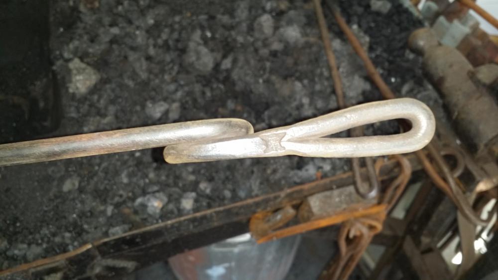

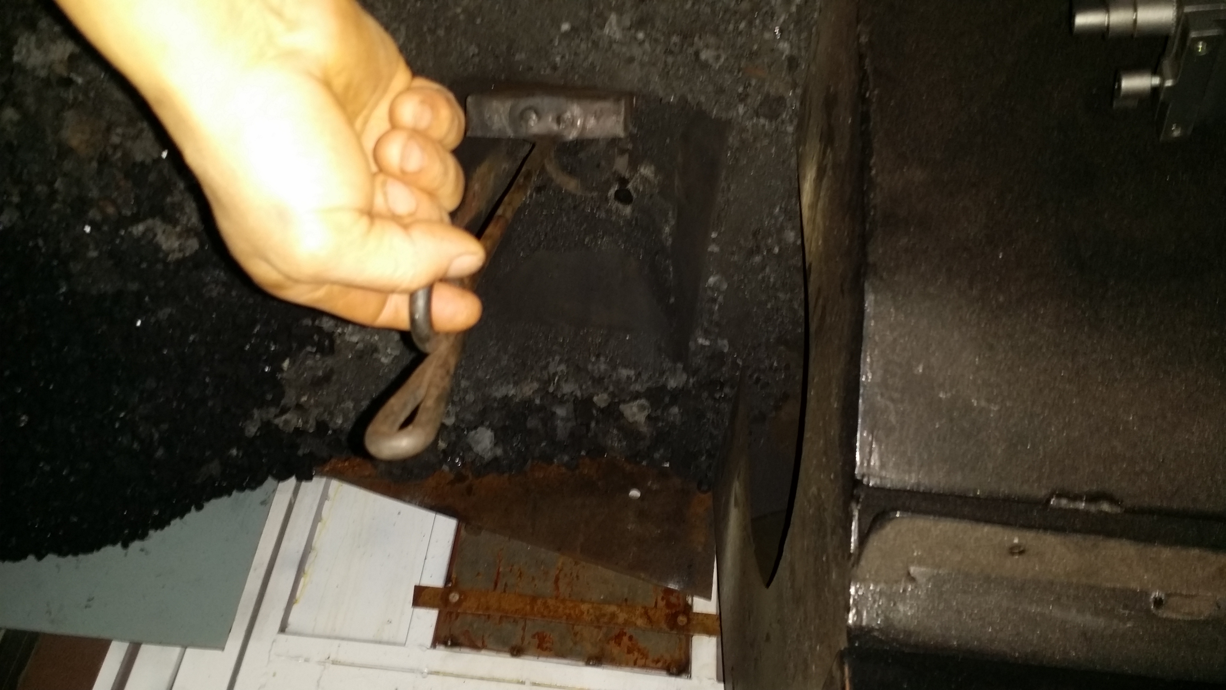

jlpservicesinc Posted October 13, 2016 Author Share Posted October 13, 2016 yes, but for finger loop... pointer finger goes into the hole.. Also when you need to scoop stuff out of the firepot you stick your finger through the loop and then just lift your hand.. It matches the same angle as the side of the firepot and then you can just lower your hand till the handle is back in your hand and scoop it out.. Quote Link to comment Share on other sites More sharing options...
Anachronist58 Posted October 13, 2016 Share Posted October 13, 2016 Your design, JLP? 'Cause that is mighty slick. Robert Quote Link to comment Share on other sites More sharing options...
jlpservicesinc Posted October 13, 2016 Author Share Posted October 13, 2016 27 minutes ago, Anachronist58 said: Your design, JLP? 'Cause that is mighty slick. Robert I think so.. I came up with it back in 87.. No sure if there are any "New" ideas or not.. Quote Link to comment Share on other sites More sharing options...
Anachronist58 Posted October 14, 2016 Share Posted October 14, 2016 If it's never been seen or heard of before on your entire island, it qualifies as an "original" idea. Good work. Quote Link to comment Share on other sites More sharing options...
jlpservicesinc Posted October 14, 2016 Author Share Posted October 14, 2016 10 minutes ago, Anachronist58 said: If it's never been seen or heard of before on your entire island, it qualifies as an "original" idea. Good work. Thanks.. Not that I know of.. so maybe original.. :).. I have a hard time claiming ownership of any ideas in Blacksmithing (or any hammer trades) as the trade is several thousand years old and there have been lots of smart people many times over.. Lots of ideas simply have been forgotten.. Sorry about the pictures.. The pictures are right side up on my computer but when i upload them they flip. Quote Link to comment Share on other sites More sharing options...
Daswulf Posted October 14, 2016 Share Posted October 14, 2016 Still happy using that fire tool design. It's a keeper. Thanks again for sharing. Easy to maneuver and control. Quote Link to comment Share on other sites More sharing options...
Anachronist58 Posted October 14, 2016 Share Posted October 14, 2016 4 hours ago, jlpservicesinc said: Sorry about the pictures.. The pictures are right side up on my computer but when i upload them they flip. Pics are coming out upside up when I click on them on my mobile. Quote Link to comment Share on other sites More sharing options...
aessinus Posted October 14, 2016 Share Posted October 14, 2016 I, for one, am borrowing your idea. There are a multitude of uses for that simple loop. As soon as I saw your 1st picture, I face-palmed. 11 hours ago, jlpservicesinc said: Sorry about the pictures.. The pictures are right side up on my computer but when i upload them they flip. The forum software should have a button labeled "Hit me with your hammer".... Quote Link to comment Share on other sites More sharing options...
jlpservicesinc Posted October 14, 2016 Author Share Posted October 14, 2016 19 hours ago, Daswulf said: Still happy using that fire tool design. It's a keeper. Thanks again for sharing. Easy to maneuver and control. Your welcome.. Glad it worked out for you.. 17 hours ago, Anachronist58 said: Pics are coming out upside up when I click on them on my mobile. That is so funny.. Haven't figured out way.. Right side up on the computer.. Huh.. 11 hours ago, aessinus said: I, for one, am borrowing your idea. There are a multitude of uses for that simple loop. As soon as I saw your 1st picture, I face-palmed. The forum software should have a button labeled "Hit me with your hammer".... Thanks.. That's cute.. If you use if for a shovel handle be sure and make your shovel the same width as the bottom of the firepot.. Quote Link to comment Share on other sites More sharing options...
