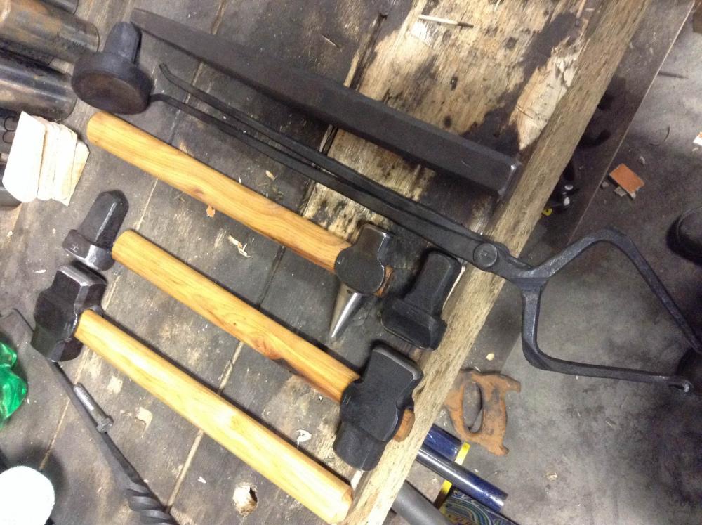

Gorō Posted October 4, 2016 Share Posted October 4, 2016 Just want to thank Ethan Harty for forging these tools for me. I would buy from him again no doubt. 5/5 Quote Link to comment Share on other sites More sharing options...
JHCC Posted October 4, 2016 Share Posted October 4, 2016 So many possibilities! Quote Link to comment Share on other sites More sharing options...
Daswulf Posted October 4, 2016 Share Posted October 4, 2016 Looks like someone will be making some hammers. Quote Link to comment Share on other sites More sharing options...
Gorō Posted October 4, 2016 Author Share Posted October 4, 2016 7 hours ago, Daswulf said: Looks like someone will be making some hammers. Yep after failed practice runs I figured I'll just get the whole peice of kit. Quote Link to comment Share on other sites More sharing options...
Daswulf Posted October 4, 2016 Share Posted October 4, 2016 Awesome. Looks like great kit to get you moving. Make sure ya post your work, I'd love to see it. Quote Link to comment Share on other sites More sharing options...
Frosty Posted October 5, 2016 Share Posted October 5, 2016 SWEET kit! An eye drift, slit punch, cup tool and Brazeal style tongs, beautiful turning and straight pein hammers. Looks to me like he set you up, if you want a cross pein you're going to have to make your own. I LIKE the way he thinks. I'm a little jealous. Frosty The Lucky. Quote Link to comment Share on other sites More sharing options...

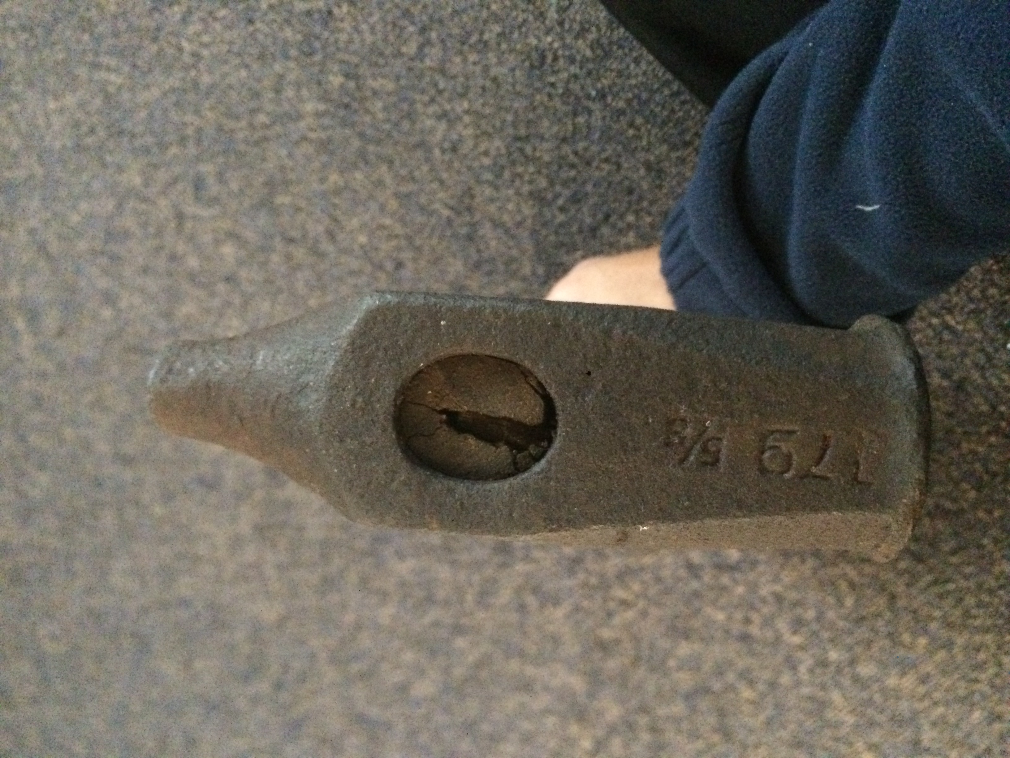

Gorō Posted October 5, 2016 Author Share Posted October 5, 2016 Day by day, bit by bit I'm slowly getting there. Ive got some old axles,cv drive shafts and rusted cable from my old mans winch on his trawler I'm hoping to put to good use when everything is set up! Initially I tried punching with a handled punch I got from eBay but it didn't move the steel how I wanted it. I'm probably going to remove the handle and reshape it Quote Link to comment Share on other sites More sharing options...
Frosty Posted October 5, 2016 Share Posted October 5, 2016 That punch has been broken or (probably) cut off for some reason, the working end should be around 4" / 100mm? long. These are still being made and used, sometimes called drift pin punch, they're generally used to remove lock pins, carbide teeth form soils or stone cutting bits and similar. We had a couple on each drill rig for changing teeth on the bits. They WILL bend if you work hard enough but I've never seen one broken, especially not there It may make a good blank to make a touch mark. It's designed to be hit with a hammer and the broken end was heat treated to stand up to abuse and or punching holes so it should work fine for a touchmark. Frosty The Lucky. Quote Link to comment Share on other sites More sharing options...
Gorō Posted October 6, 2016 Author Share Posted October 6, 2016 6 hours ago, Frosty said: That punch has been broken or (probably) cut off for some reason, the working end should be around 4" / 100mm? long. These are still being made and used, sometimes called drift pin punch, they're generally used to remove lock pins, carbide teeth form soils or stone cutting bits and similar. We had a couple on each drill rig for changing teeth on the bits. They WILL bend if you work hard enough but I've never seen one broken, especially not there It may make a good blank to make a touch mark. It's designed to be hit with a hammer and the broken end was heat treated to stand up to abuse and or punching holes so it should work fine for a touchmark. Frosty The Lucky. I was thinking of upsetting the punch part that broke off and then try to taper it and fix up the hammer eye. To make a touch mark would I neeed to engrave a design or something? It's something I haven't thought of yet. Quote Link to comment Share on other sites More sharing options...
JHCC Posted October 6, 2016 Share Posted October 6, 2016 Torbjörn Åhman has a good video of how to make a touchmark here. Quote Link to comment Share on other sites More sharing options...
Frosty Posted October 6, 2016 Share Posted October 6, 2016 I wouldn't go to much if any trouble making a hammer out of it. It's a top tool so the handle eye doesn't need to have as much resistance to turning. There are a lot of different ways to make a touchmark punch. You can engrave the punch directly or my preference engrave, chisel, chase, etc. the touchmark and drive the punch into it HOT. I guess the LOT I refer to are the ways to engrave. Frosty The Lucky. Quote Link to comment Share on other sites More sharing options...
JHCC Posted October 6, 2016 Share Posted October 6, 2016 I did an electrolytic etch onto the end of a straight Allen wrench and then filed away whatever wasn't part of the pattern. Quote Link to comment Share on other sites More sharing options...
Mark Ling Posted October 7, 2016 Share Posted October 7, 2016 On 10/4/2016 at 7:48 PM, Frosty said: SWEET kit! An eye drift, slit punch, cup tool and Brazeal style tongs, beautiful turning and straight pein hammers. Looks to me like he set you up, if you want a cross pein you're going to have to make your own. I LIKE the way he thinks. I'm a little jealous. Frosty The Lucky. I'm not sure if this is one of your sarcastic moments, its hard to tell from the tone you said it in, but I believe that in the kit there are not any cross peen hammers, or turning hammers, but rather a half inch fuller, and a 3/4" (?) fuller. Littleblacksmith Quote Link to comment Share on other sites More sharing options...
Frosty Posted October 7, 2016 Share Posted October 7, 2016 No cross pein in the kit, that's why I said he'd have to make one if he wanted one. It's a diabolical way to get guys started making hammers. There was just the barest hint of sarcasm slipped in on that one, most tool makers want you to buy one of theirs not make your own. Then again that looks an awful lot like a cup die in the back ground. The angle may be fooling me but I think the nice hammer on the bottom left has a flat face and a square turning pein in clear view. The one that looks a lot like a straight pein to me could indeed be a top fuller but the side you can't see looks a lot like a face to me. I could be wrong though, I wouldn't be surprised. Frosty The Lucky. Quote Link to comment Share on other sites More sharing options...
Gorō Posted October 7, 2016 Author Share Posted October 7, 2016 I'm thinking dog head, cross pein and a smaller rounding hammer. hopefully sometime this month I'll get some downtime to start forging. Quote Link to comment Share on other sites More sharing options...
