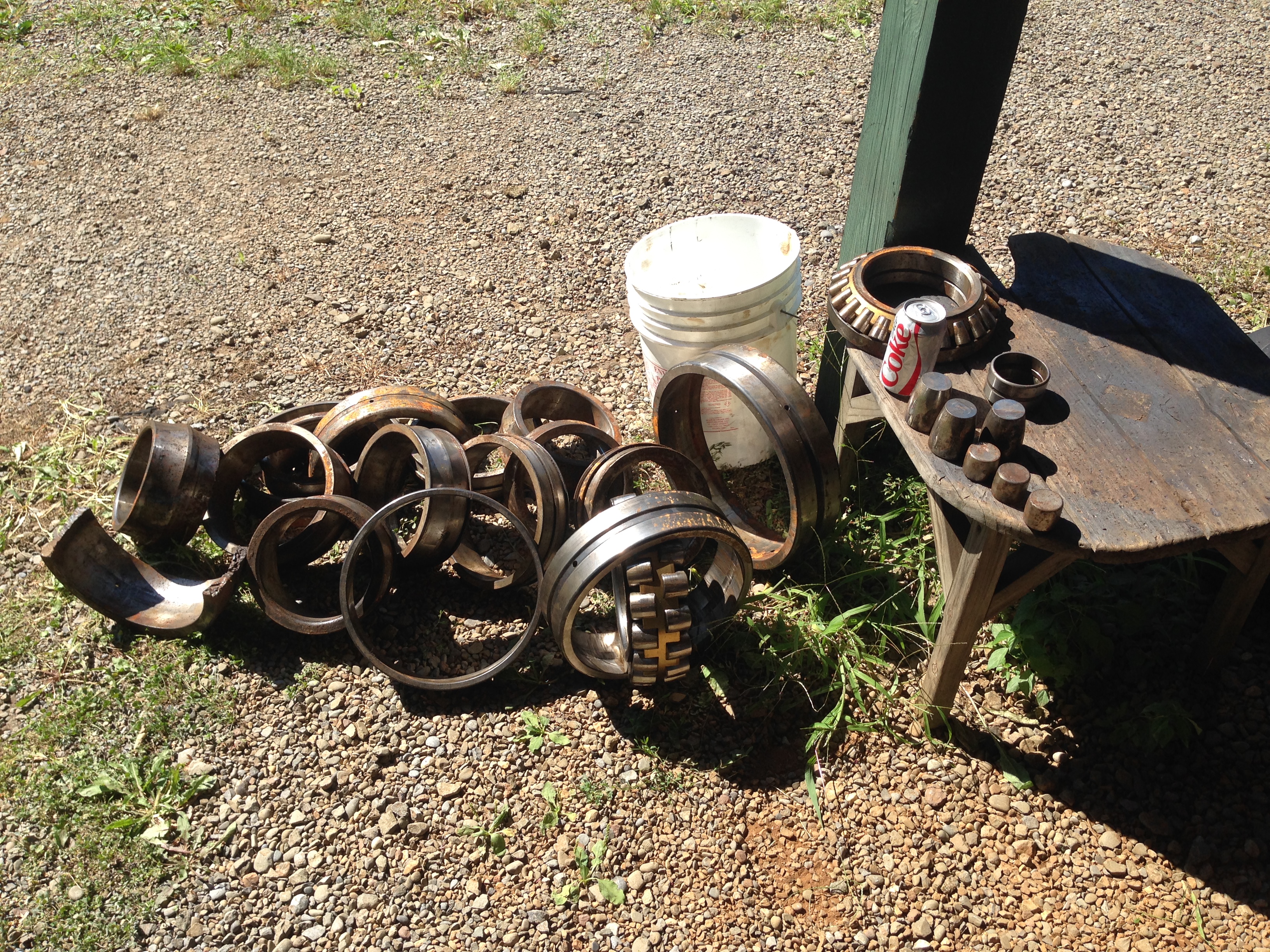

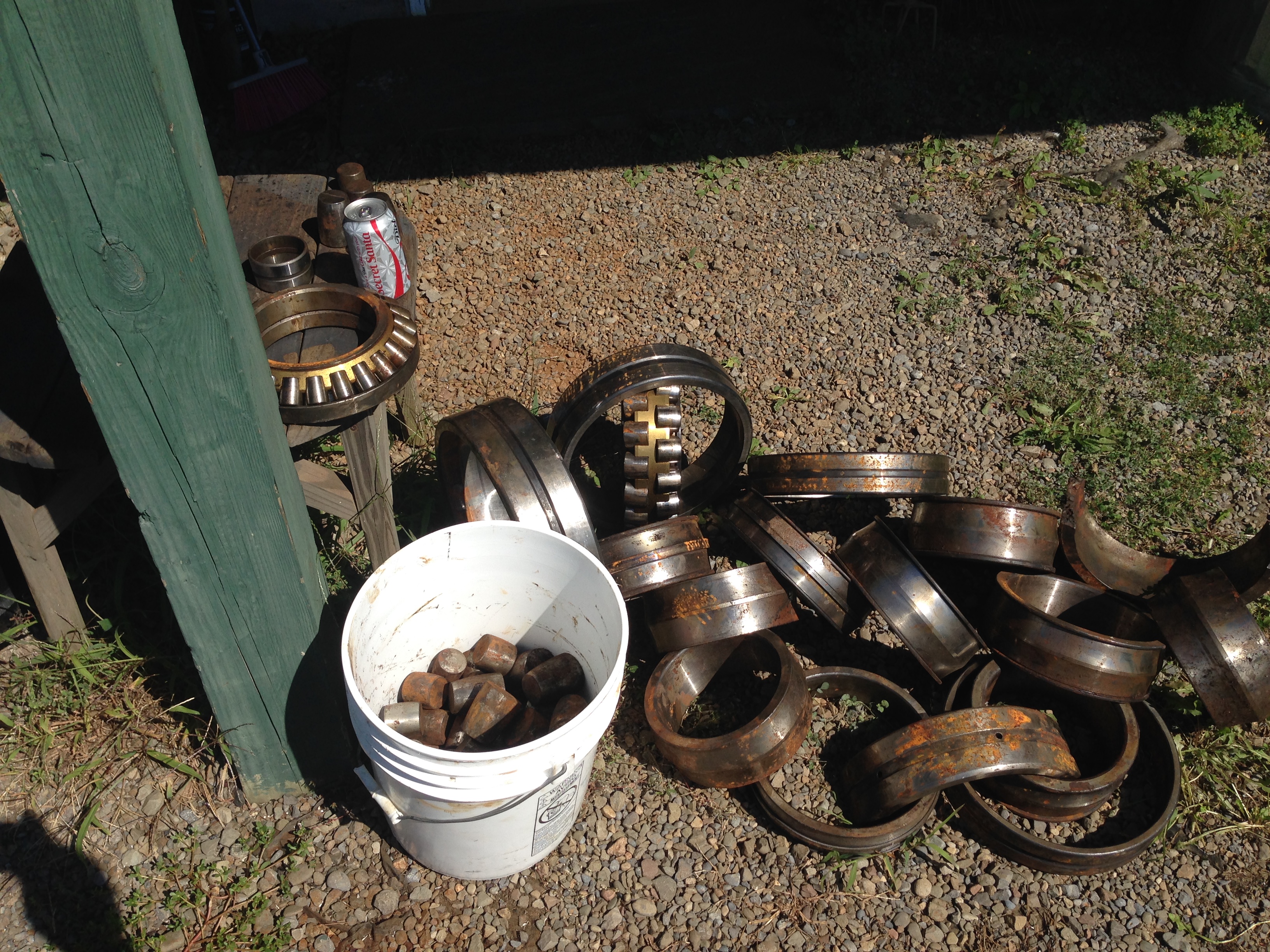

tdriack Posted September 6, 2016 Share Posted September 6, 2016 Hi Everyone! I came across a great find for free. Shipyard I was at was doing some spring cleaning - and was throwing out to scrap all the pictured bearing races and rollers. I haven't done any testing on the metal yet to confirm that it's 52100 steel, but I'm sure some is. It's all bearings from marine reduction gears. My initial plan was to use some of the small rollers to make some knife blades, and maybe make a hammer from a big conical roller as a keepsake, but I couldn't pass up the larger races and have a clean conscience lol. Note the soda can for sizing. Has anyone ever tried using similar metal for projects? I'd enjoy any comments or input. Quote Link to comment Share on other sites More sharing options...

Gergely Posted September 14, 2016 Share Posted September 14, 2016 Nice haul! I always like to have some bearing stock around - so can totally feel your joy. One technical thing though: these are pretty tough to forge. A 2" dia roller falls in the "can't move with handhammer" category. Try to get a striker or use a power hammer. Weld it onto a rod (preheating and postweld normalizing is important) to manage it easier. I don't know how much experience you have with 52100, sorry if I state the obvious. It's almost sure that those are made of that material. If you got an angle grinder try to hit the stock with a cutting disk. When you touch the stock with the disk you'll see about 10-15" long bushy sparks bursting into star like shapes at the end of their way.. This basicly means you've got high carbon steel but in this case it's something like 52100 - you cannot know because it's scrap steel. If so you can forge it into something but be aware of the temperature: no high carbon steel likes to get too hot. Stay in the orange, and stop forging under bright red. Heat treat it if you need it to be hard - my way is to let it be softer as overharden it. - 52100 types spit shrapnels very likely, not a funny alloy that way. I don't know for sure but it seems like it air hardens a bit - if you make a struck tool it's safer to anneal it and only after that harden and temper the business end. And about the bearing steels: I've found Ovako's brochure on their steels. Ovako is European, they supply steel IIRC for SKF. Steels for Bearings from Ovako.pdf Good luck with those! Happy hammering! Gergely Quote Link to comment Share on other sites More sharing options...

Gergely Posted September 21, 2016 Share Posted September 21, 2016 Maybe it's safer leave that piece unused for real tooling applications now. Oil quench is safer and it needs tempering back to blue if it's a tool (struck end needs annealing), stray or purple if it's a blade. Bests: Gergely Quote Link to comment Share on other sites More sharing options...
