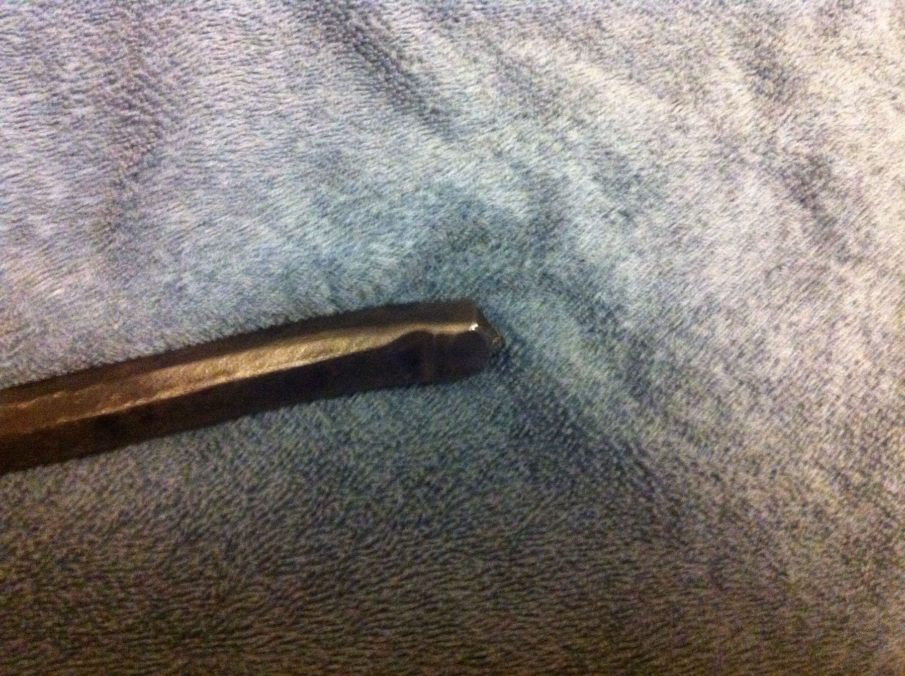

will52100 Posted August 3, 2016 Author Share Posted August 3, 2016 I tend to agree with you, when I was first starting out I used salvaged materials for knives. I learned a lot, but wasted a lot of time with poor steels and not knowing what to expect. I always advocate learning on a known steel, then branching out to experiment. Anyway, I managed to get over to my friend's house and check his hold fast out. Basically the end of the holder doesn't go all the way through the pritchel hole and has a flat with a bit of a kick to it. I'd brought mine over, we cut the end off and put a little flat on it and a bit of a kick and it held great. Got home and had to forge a bit of a nicer one than what I had. Anyway, this is what I came up with, could have used a bit more planishing on the head, but I was burned out from the heat today. It's forged from A36 1" square bar as that's all I had on hand big enough, I did use super quench on the end of the nub to maybe make it last longer, if it wears and starts slipping it's easy enough to fix though. Thanks for all the help Quote Link to comment Share on other sites More sharing options...
JHCC Posted August 3, 2016 Share Posted August 3, 2016 Very interesting; glad you found a solution. Questions: how tightly does it fit in the hole before you tap it down, and how well does it accommodate different heights of held-down material? Quote Link to comment Share on other sites More sharing options...
will52100 Posted August 3, 2016 Author Share Posted August 3, 2016 About 3/32" slack or so. The end of the hold fast is about 1/4" shorter than the end of the pritchel hole, so I've got 5" to play with, it'll hold down an inch or so, any thicker and I'd need to make a longer hold fast. mainly what I need it for is 1/4" thick and 3/8" thick flat bar. Now that I see what's going on, if I need to I can make another easily enough. Quote Link to comment Share on other sites More sharing options...
JHCC Posted August 3, 2016 Share Posted August 3, 2016 In other words, the little nub moves the bottom contact point up the pritchel hole to roughly the equivalent of where it would be on a thinner heel. That's very interesting. Quote Link to comment Share on other sites More sharing options...
will52100 Posted August 3, 2016 Author Share Posted August 3, 2016 Pretty much. The only other option would be to counter drill the pritchel hole from underneath, but good luck finding a reasonably priced cobalt 1 1/4" or so bit to drill the 60-61 rockwell anvil. The 5" thickness is great support for punching, but makes it tough to fit a hold down. My friend also has a London pattern and while the hold fast I'd made before wouldn't fit in the pritchel hole, they would lock up good in the hardy hole which was about 2 3/4" thick. Quote Link to comment Share on other sites More sharing options...

will52100 Posted August 3, 2016 Author Share Posted August 3, 2016 The hardness is only an inch or so, but it's all around the anvil sides and bottom as well. Think of it as a 1" jacket. Quote Link to comment Share on other sites More sharing options...
Frosty Posted August 3, 2016 Share Posted August 3, 2016 I've never seen a hold fast with the finger so close to the same length as the shank. What kind of anvil is this Will, I don't recall if you told us already. Frosty The Lucky. Quote Link to comment Share on other sites More sharing options...
will52100 Posted August 3, 2016 Author Share Posted August 3, 2016 It's a Refflinghaus, 330 pound German pattern #57. It just looks the same length due to camera angle, but it's only 5" longer than the shank to keep it within the pritchel hole. Quote Link to comment Share on other sites More sharing options...

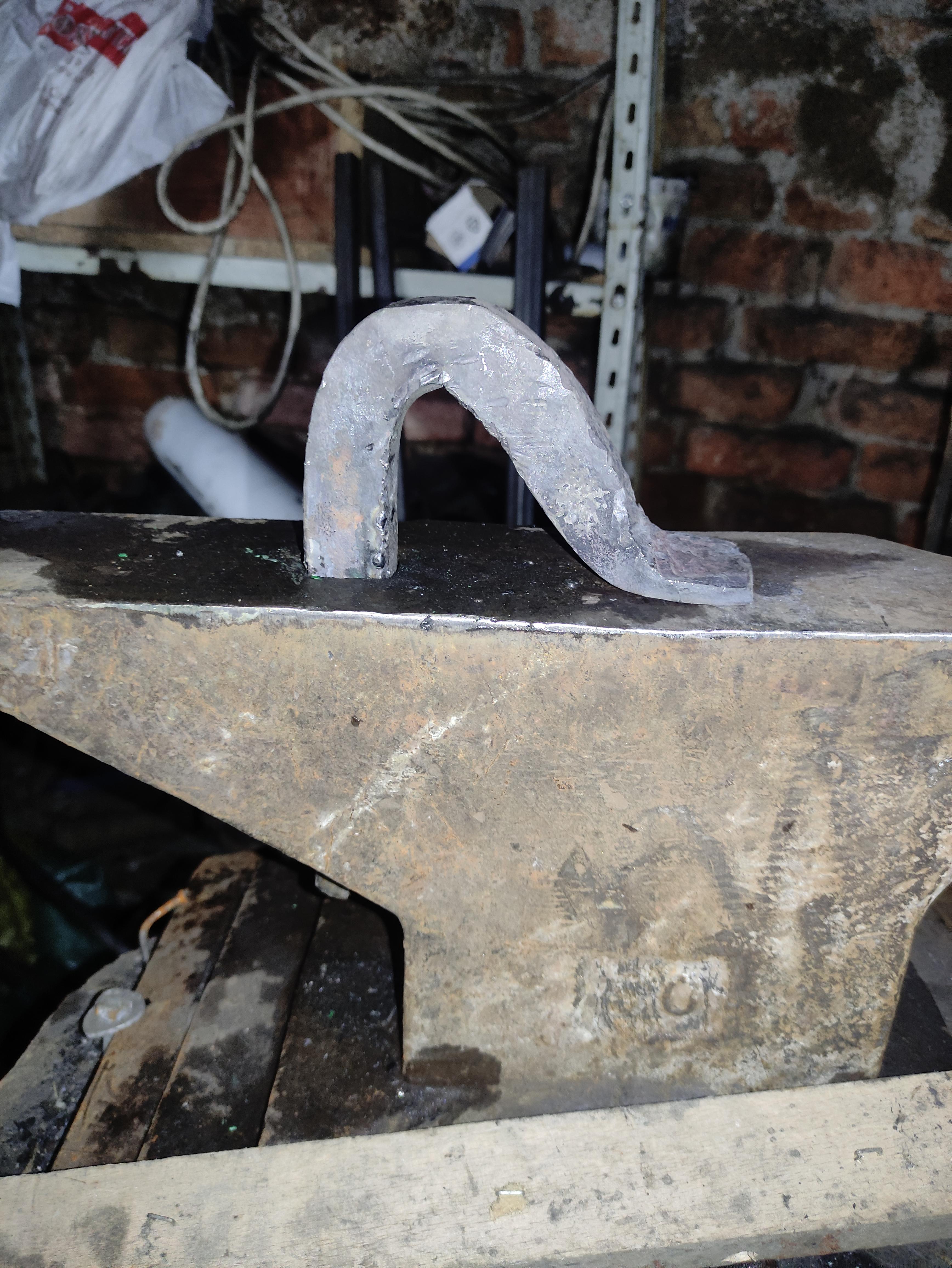

natkova Posted January 28, 2023 Share Posted January 28, 2023 I made holdfast but i had issue it wiggle too much, first it was too tight now it wiggle. Mine go to hardy hole since i dont have pritchet its 1"by 1" . Quote Link to comment Share on other sites More sharing options...

Branding Iron Posted January 29, 2023 Share Posted January 29, 2023 It wiggles when you put stock under the holdfast and give the top of the holdfast a couple taps with your hammer, or it wiggles when it’s placed in the hardy hole? I have a large square shank holdfast for woodworking with no real flex in the neck to help with wedging - it takes a couple really good whacks to lock it in place, but it requires stock underneath to create the angle on the stem. Quote Link to comment Share on other sites More sharing options...
natkova Posted January 29, 2023 Share Posted January 29, 2023 It wiggle after I whack it with hammer it even jump . Quote Link to comment Share on other sites More sharing options...

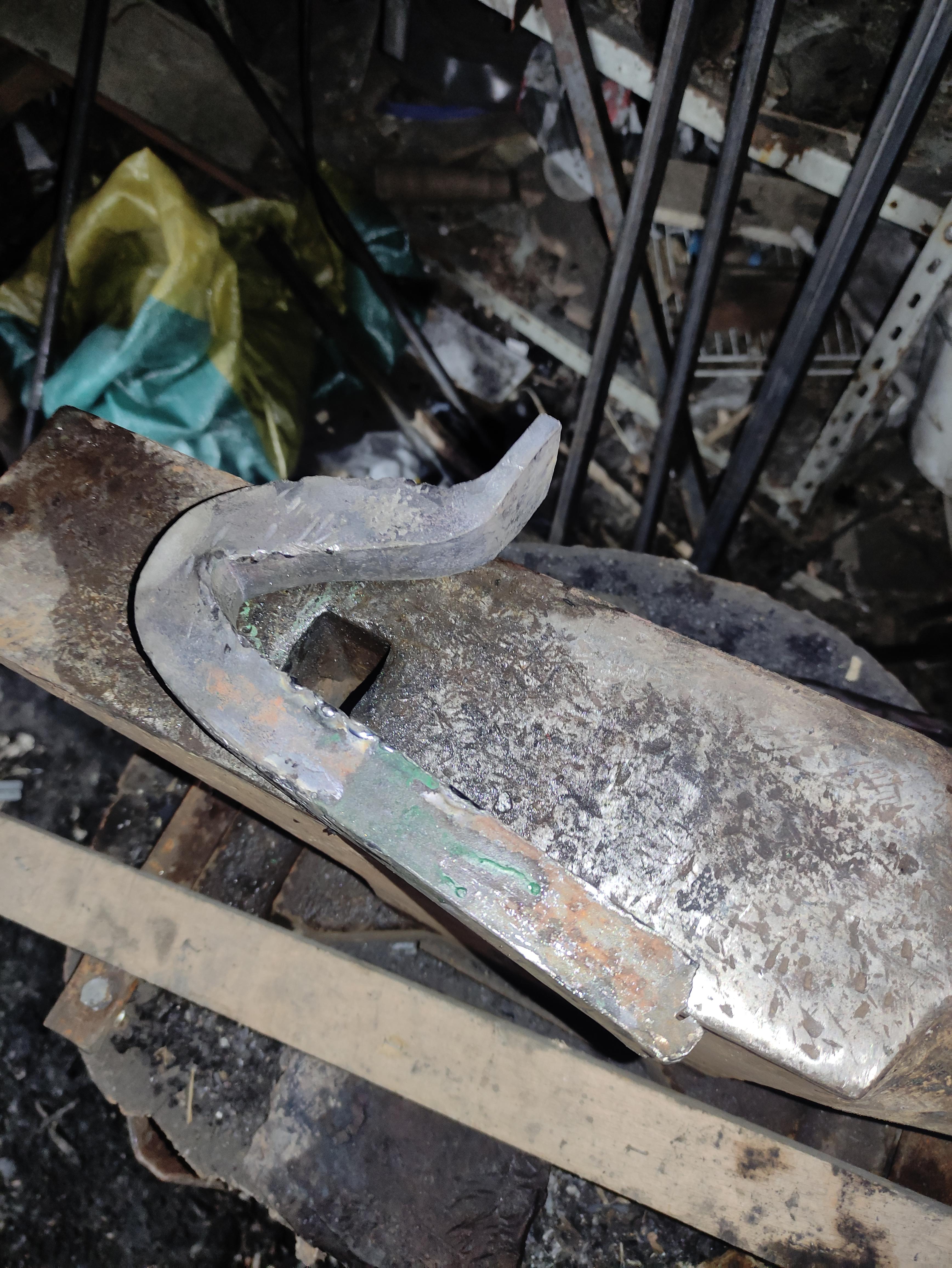

Branding Iron Posted January 29, 2023 Share Posted January 29, 2023 I’d be inclined to change the angle of the neck a few more times and play with it. Also, it appears your hardy hole has a Lot more depth than most of us, which could make it more difficult to catch the hardy shank off center. Ultimately you may have to end up drawing the neck out more to create some spring potential. That being said I can see functionality in that piece even without the ability to lock tightly. Curious to see other feedback and what ends up working. Quote Link to comment Share on other sites More sharing options...
JHCC Posted January 29, 2023 Share Posted January 29, 2023 That gooseneck looks much too thick. My guess is that your hold-down is too rigid, so you’re not getting the spring action you need for it to be effective. Remember that this kind of hold-down works by contacting the anvil at the top and bottom of the pritchel hole (or the hardy hole, as in this case) and at the point where it contacts the workpiece. Hammering down in the top pushes the shank farther down the hole and forces the gooseneck to be a little bit straighter. The gooseneck resists this force, so it pushes harder on the workpiece. At the same time, the shank pushes harder against the sides of the hole, increasing the friction that holds the shank down in the hole. Quote Link to comment Share on other sites More sharing options...
JHCC Posted January 29, 2023 Share Posted January 29, 2023 To release the hold-down, you don’t hit upwards on the bottom end of the shank, but horizontally on the back of the gooseneck. This breaks the contact between the shank and the hole. With no friction holding the shank in the hole, the pressure on the gooseneck pushes the shank up out of the hole, releasing the hold. If the gooseneck is too rigid, it can’t flex, and if it can’t flex, it can’t put push the shank against the sides of the hole. Quote Link to comment Share on other sites More sharing options...
natkova Posted January 29, 2023 Share Posted January 29, 2023 I noticed that grip worsened when I changed angle of tool , I had too long material and instead of cuting it I curved it back making more curve perhaps that's reason why it lost it grip? I tried fixing this by welding some beads around holdfast so it can be tightened, it's obvious that u didn't understood tool right . I will have to reforge it I guess. Quote Link to comment Share on other sites More sharing options...
Shainarue Posted January 30, 2023 Share Posted January 30, 2023 JHCC thank you for that explanation and sketches! Now that I understand better how it works, I'm thinking I'll remake mine from coil spring. It's currently made from rebar - and while it will hold most things down for a few hits, any big hits on the piece it's holding sends the hold skittering off. Now I see it's probably just too stiff. Quote Link to comment Share on other sites More sharing options...
natkova Posted January 30, 2023 Share Posted January 30, 2023 I tried with coil spring too thin for my hardy hole had to bend it twice and it get messy, and it twisted, after all that whacking i break it I think i accidently quenched cane part of it. where there is bend i mean tha part, maybe i forgot but it snapped, and it wanted to twist in hardy hole. myne hardy hole is 1" squere. Quote Link to comment Share on other sites More sharing options...
swedefiddle Posted January 30, 2023 Share Posted January 30, 2023 Good Morning Natkova, You have the right idea for a 'Hold Fast', but your material looks like it is too thick. It needs to have some spring in the top and it needs to contact the 2 opposite sides of the Hardy Hole, like John (JHCC) showed. We use an "L" shaped Wheel Wrench (from a car, used for changing wheels). In North America they were the Wheel Wrench that was supplied by the Auto Factory (up to about 1960). A front Sway Bar would also work (sometimes called an anti-sway bar. It is found in the Front Suspension, linked to both lower control arms). A Coil Spring would also work (It can't be too big, it 'HAS TO BE LOOSE' in the hardy Hole. Neil Quote Link to comment Share on other sites More sharing options...
