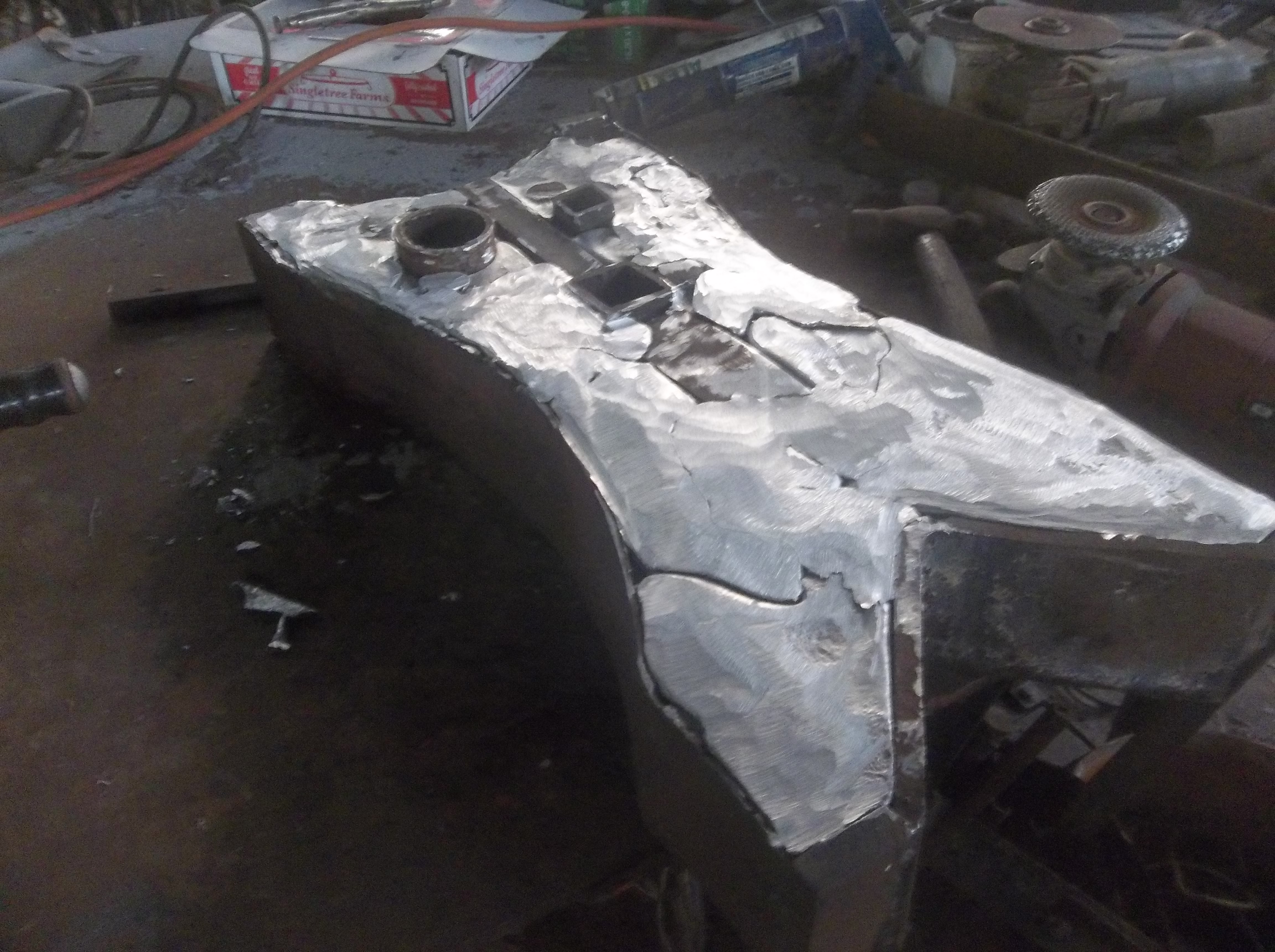

Fred Beagle Posted July 10, 2016 Share Posted July 10, 2016 Here's my latest project I thought I'd share with you. Me being poor as a church mouse but I was in dire need of a swage block that had punch out holes and so I took some scrap and piece one together but instead of welding up every nook and cranny to make it one solid piece like a regular swage, I instead smelted a bunch of aluminum to help reinforce the top plate. It has a lot of steel internal support but I just wanted to face plates to have some reinforcing too. So tell me what do you think? I may later try and build a steel cone and fill it with aluminum someday, but just gotta see how this hairbrain ideal pans out The picture was one I took yesterday I've now filled it plumb full of aluminum and it will have a top plate welded on. Link to comment Share on other sites More sharing options...

Fred Beagle Posted July 10, 2016 Author Share Posted July 10, 2016 That's pretty cool, It did cross my mind to make one and I recently picked up a nice thick plate almost 2" inches thick to do something like that. I guess another reason why I made my block the way I did was I wanted those radius to beat stuff around.. I have some wagon wheel type jigs for bending stock around but these will help tweak any flat areas I was thinking. I'll post pics as I progress on the project. Link to comment Share on other sites More sharing options...
Mark Ling Posted July 10, 2016 Share Posted July 10, 2016 I'd be interested to see a picture of the finished swage block if you don't mind. Thanks! Littleblacksmith Link to comment Share on other sites More sharing options...
Fred Beagle Posted July 11, 2016 Author Share Posted July 11, 2016 Yeah it will be a little while before it's done, Till then here's some update photos to show where I'm at and a few other things. Not pretty but as you can see I have a lot of surfacing grinding still to do,my little crucible can only heat up some much at a time and it took like 12 pots to fill it up. Some may think what a waste of aluminum but the way I see it have you seen what big swage blocks are selling for?!? Money I would of used on one can now go on something else.. Oh I'll still be wanting one but this will work till I can find one at the junk yard someday<~~~ yep I know I'm dreaming lol.. Here's a picture of the main working side I didn't show yet..He sort of looks like Saturday night live's Mr Bill "Oh No!" Here's a crazy ideal that failed to launch.. it kept binding lol.. hmm I think I see a couple of big Bowie knifes in that leaf spring. And here's a better picture of my little 100 pound Fisher anvil that my uncle who worked at a scrap yard gave to me,He told me that he was moving a scrap metal load with the big claw and this thing fell out of it. I do wish I had a before picture that would of showed the damage down to the anvil face it was like left outside in the weather and rust was really flaking it away. As DSW and other folks who know a lot more than me.. 7018 is not the way to go on high carbon steel being that it is too soft. Still I'm really happy so far with the repair I made and no dents so far in like 2 years since the repair but then again I don't beat the crap out of it with a sledge either. Link to comment Share on other sites More sharing options...

VaughnT Posted July 13, 2016 Share Posted July 13, 2016 What'd you use for the bowl depression in your swage? I've been looking for something around 6" in diameter, but haven't found anything... Link to comment Share on other sites More sharing options...
ThomasPowers Posted July 13, 2016 Share Posted July 13, 2016 Find a place that does hydrotesting of welding tanks, (not acetylene, but any of the others) and explain that you need the bases but not the rest of the tank. If you can make a connection they have a large range of size and depth and anything that takes 2000+ PSI will be fine to hammer hot metal into! Link to comment Share on other sites More sharing options...
DSW Posted July 13, 2016 Share Posted July 13, 2016 2 hours ago, ThomasPowers said: Find a place that does hydrotesting of welding tanks, (not acetylene, but any of the others) and explain that you need the bases but not the rest of the tank. If you can make a connection they have a large range of size and depth and anything that takes 2000+ PSI will be fine to hammer hot metal into! The hydro shop we used to use regularly, disliked selling failed cylinders. However if you explained why you needed them and were willing to take only half or drill holes in them so they were sure that they wouldn't get reused as pressure vessels, they were much more agreeable. I've been on the hunt for one with a good concave base for dishing. Problem is that the shop is about an hour west of me and I don't go that way very frequently. Last time I was in they had just gotten rid of all their "dead" cylinders. I did have to do a bit of explaining as to why I wanted one, but once they knew I'd be happy with only the bottom, or one cut in half, they were willing to see if any they had would suit my needs. Having a couple of bottle openers to give the shop guys doesn't hurt and they will be a lot more willing to keep their eyes open and call if they get something you can use. Link to comment Share on other sites More sharing options...
Fred Beagle Posted July 13, 2016 Author Share Posted July 13, 2016 Here in Texas we have a place called "Kings Supply" and what that is is a dome cap for 6" inch pipe. But it isn't the one I wanted to use seeing how it's not truly domed but flattens out a wee bit on the bottom. The kind I wanted to use wasn't available at the time. But there are other things I guess that could be used like a Oxygen bottle cap. it would be smaller but it's a good dome. One jig I'm gonna make I'll be hammering different size ball bearings into two solid blocks of 1" thick steel and these will eventually become ball swages for forming ball ends on tong handles. Just upset the steel handle ends to a certain size and then throw em in the ball swage. Link to comment Share on other sites More sharing options...
