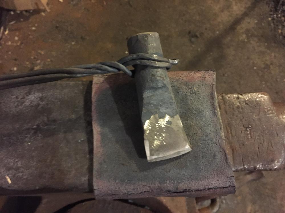

JHCC Posted August 6, 2016 Author Share Posted August 6, 2016 In the end, I made one from a piece of torsion bar: Quote Link to comment Share on other sites More sharing options...
VaughnT Posted August 6, 2016 Share Posted August 6, 2016 That was easy, wasn't it?! Good job, hoss. Quote Link to comment Share on other sites More sharing options...
JHCC Posted August 6, 2016 Author Share Posted August 6, 2016 Having a good spring swage makes all the difference! Quote Link to comment Share on other sites More sharing options...
