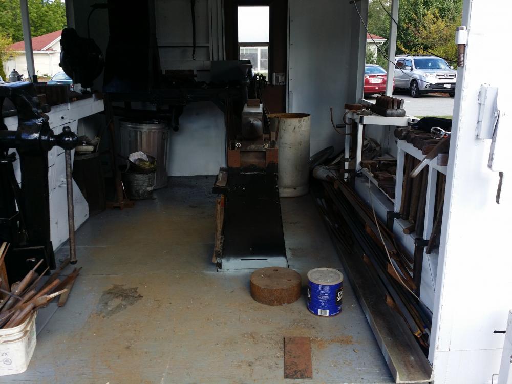

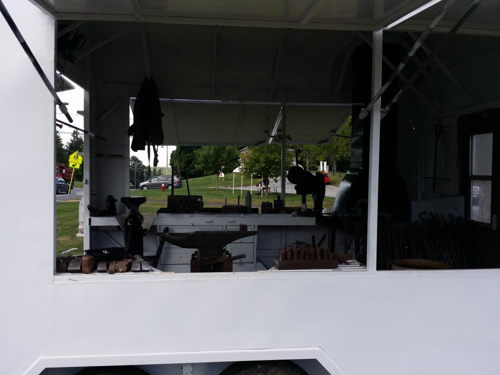

ironwolfforgeca Posted September 18, 2016 Share Posted September 18, 2016 WOW thats a start from scratch RE-do fab job on that trailer, looks like you replaced or reworked every piece of steel on it ! thats a lot of fab time Well Done !! just looking @ that much work tiered me out !!!!!!!!! Steve's Welding & Fab Link to comment Share on other sites More sharing options...
jlpservicesinc Posted September 18, 2016 Author Share Posted September 18, 2016 15 hours ago, matto said: Really is coming together nicely and we are all jealous of you!!! Thank you. This coming weekend will be the first real together demo.. Be super nice to have everything organized and where it belongs.. Then I can get started on the foot hammer.. 2 hours ago, IronWolf said: WOW thats a start from scratch RE-do fab job on that trailer, looks like you replaced or reworked every piece of steel on it ! thats a lot of fab time Well Done !! just looking @ that much work tiered me out !!!!!!!!! Steve's Welding & Fab Thanks.. I would have been better off with a completely new build.. For some reason I was fixated on using the rounded panels.. I swear this is the last trailer I will ever build but one never knows.. 4ft longer would be perfect.. Link to comment Share on other sites More sharing options...

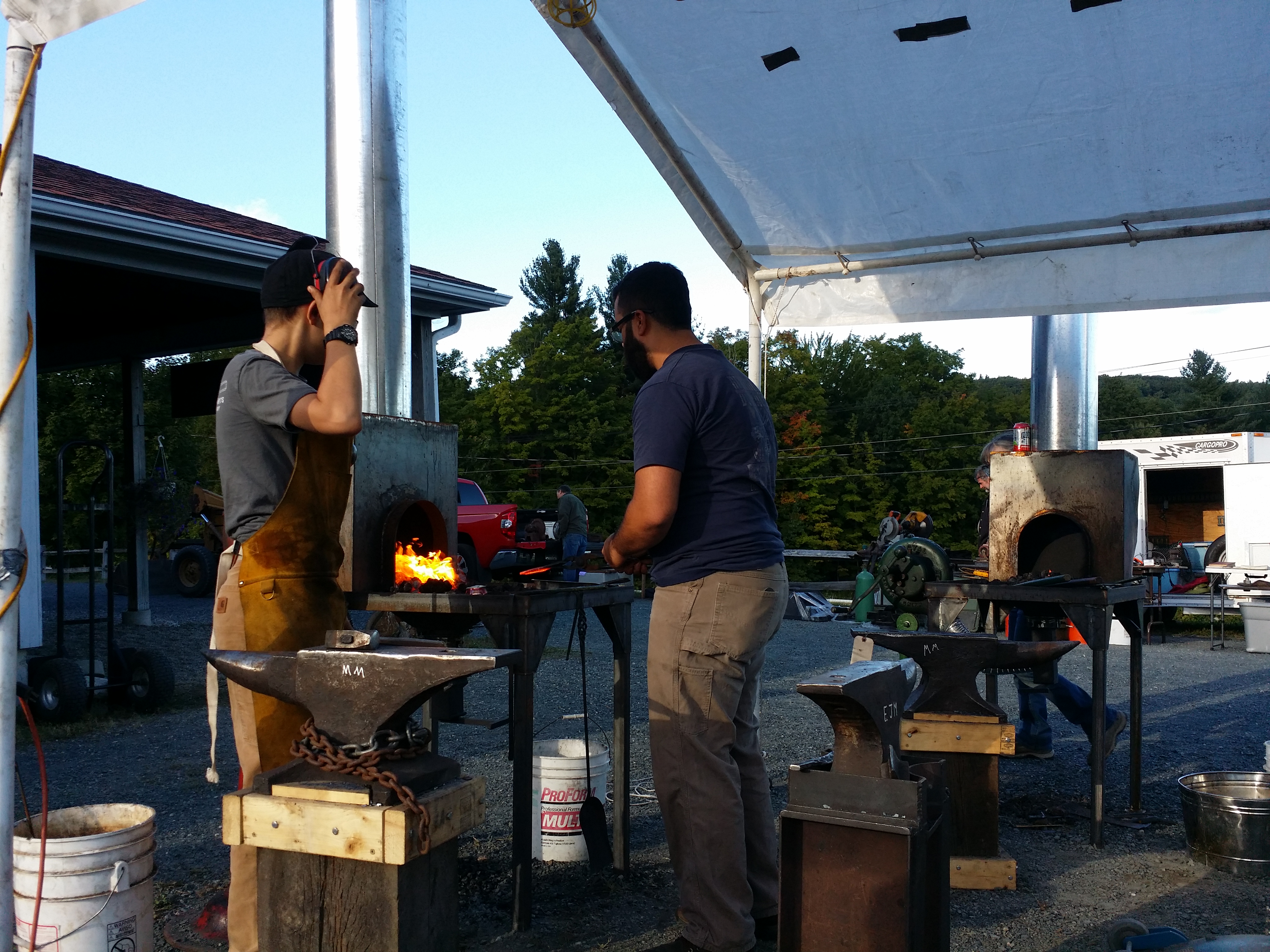

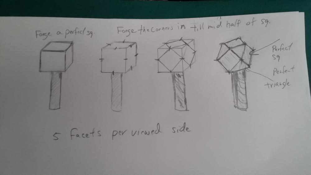

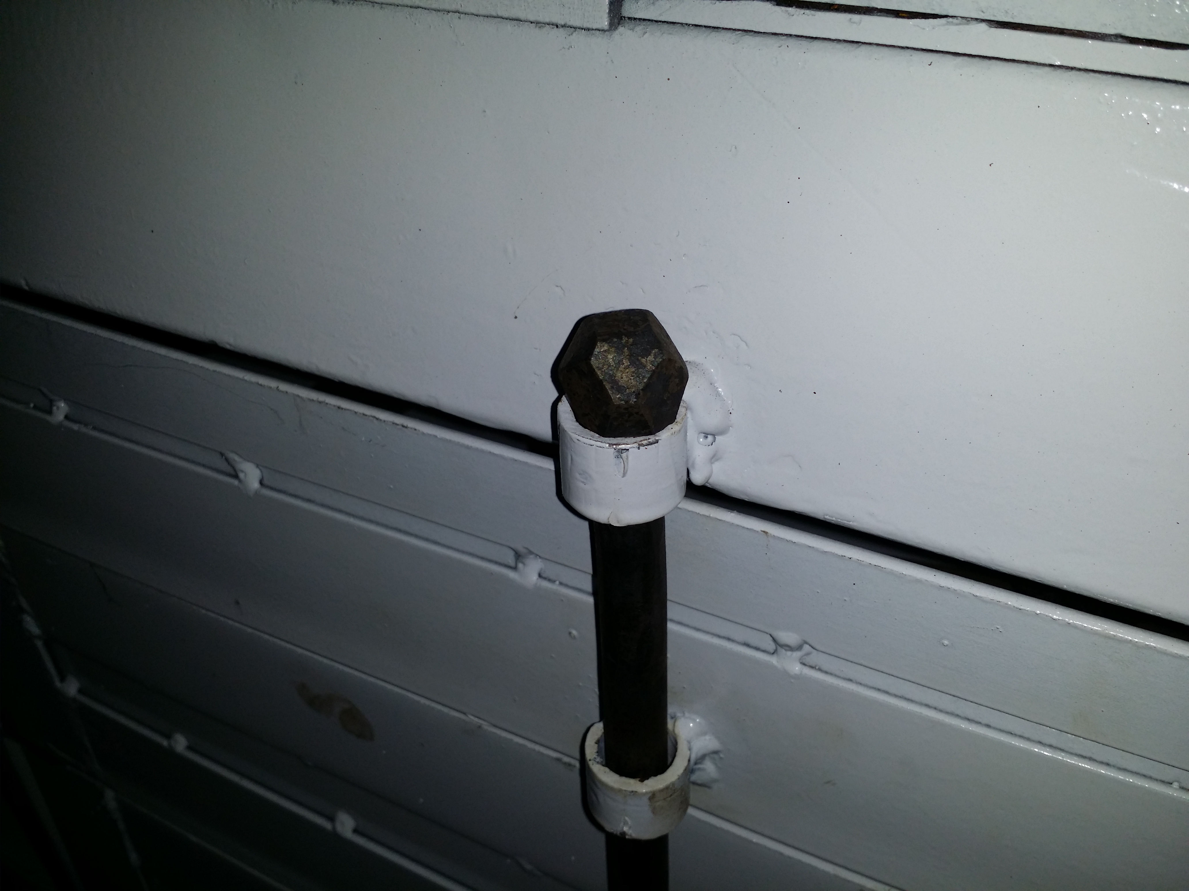

aessinus Posted September 27, 2016 Share Posted September 27, 2016 That trailer is absolutely beyond words. Single adjectives cannot describe it. I have a couple of questions; how is your flue pipe setup to telescope & precisely what is a blacksmith diamond? I think I see an 10-sided prism, with the tenth face being the joint to the base rod. If so, you just solved an issue I've been pondering for a bit. Link to comment Share on other sites More sharing options...
jlpservicesinc Posted September 28, 2016 Author Share Posted September 28, 2016 13 hours ago, aessinus said: That trailer is absolutely beyond words. Single adjectives cannot describe it. I have a couple of questions; how is your flue pipe setup to telescope & precisely what is a blacksmith diamond? I think I see an 10-sided prism, with the tenth face being the joint to the base rod. If so, you just solved an issue I've been pondering for a bit. Thanks. It's so nice to work in.. The stack gets lifted up onto a thimble which is mounted to the roof and a support structure under it.. This thimble acts as a water tight pass thru for the stack from the forge.. It has a tapered fit so once the stack is up, you wiggle it just a little bit and it locks onto the thimble. It takes 2 jacks on each side to raise it back up to lay it down for transport.. Here is a visual reference and lesson on the blacksmith diamond.. Ideally when finished all edges should be sharp and the square sections should all be square and the triangle sections should all be sharp triangles.. Certain finials were considered difficult to master and showed the level of mastery by the smith.. The blacksmith diamond is one such item.. While not that hard to make, to make them all perfect without a file is challenging.. Besides that its a fun item to make.. Link to comment Share on other sites More sharing options...
jlpservicesinc Posted September 28, 2016 Author Share Posted September 28, 2016 There are 3 video segments on my facebook page showing the steps to the diamond in these pictures.. More of a time lapse then a how to but it should give you the full picture of the process.. https://www.facebook.com/jlpsinc/ Link to comment Share on other sites More sharing options...
aessinus Posted September 28, 2016 Share Posted September 28, 2016 Doh, I didn't even consider laying the flue down. Overcomplicating designs is a bad habit... Thank you very much for taking the time to sketch the instructions & post pics. That's considerable metal to move by hand. I guess I now have a new exam to master. I will review the videos first. Square edges, no file, square edges, no file...... 15 hours ago, jlpservicesinc said: Ideally when finished all edges should be sharp and the square sections should all be square and the triangle sections should all be sharp triangles.. Certain finials were considered difficult to master and showed the level of mastery by the smith.. The blacksmith diamond is one such item.. While not that hard to make, to make them all perfect without a file is challenging.. Besides that its a fun item to make.. Link to comment Share on other sites More sharing options...

George Geist Posted September 28, 2016 Share Posted September 28, 2016 Nice job. Why the stack so high? Link to comment Share on other sites More sharing options...
jlpservicesinc Posted September 28, 2016 Author Share Posted September 28, 2016 1 hour ago, Anachronist58 said: Excellent thread, JLP. Inspiring. Robert Taylor Thanks.. 38 minutes ago, George Geist said: Nice job. Why the stack so high? Coal smoke is pretty heavy so this keeps the smoke moving along over peoples heads vs coming out a short stack and settling back down into the crowd.. Also a longer stack will offer an increase in cyclic negative pressure between full on and off.. I use a hand blower.. Link to comment Share on other sites More sharing options...
George Geist Posted September 28, 2016 Share Posted September 28, 2016 Ok, just asking as one who uses a trailer myself. Must you disassemble it when you go down the road then? Link to comment Share on other sites More sharing options...
Frosty Posted September 29, 2016 Share Posted September 29, 2016 JP: I've started to respond to what we were talking about regarding to our different demo styles but it'd be a poor digression in an otherwise outstanding thread. Once I get my head wrapped around what I've been up to maybe we can start another thread about demo styles. I'd be incredibly surprised if there aren't a lot (100s?) of folk with demo styles to learn from here. I love your trailer, the more I see the better it gets. Frosty The Lucky. Link to comment Share on other sites More sharing options...
jlpservicesinc Posted September 29, 2016 Author Share Posted September 29, 2016 4 hours ago, George Geist said: Ok, just asking as one who uses a trailer myself. Must you disassemble it when you go down the road then? Transport mode.. 11ft from ground to top of stack cap.. Link to comment Share on other sites More sharing options...
