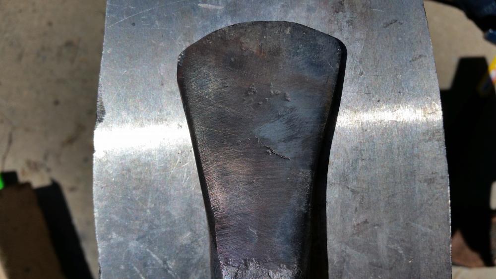

TheAngryScrapsmith Posted June 20, 2016 Share Posted June 20, 2016 I have built a brake drum coal forge and have started trying to work a piece of steel from an old barbell into a spoon chisel for wood carving. I know it's probably too complicated a job for a beginner, but I'm a "dive right in" kind of guy. The problem I have is that the steel doesn't seem to stay very hot and workable for very long. When I pull the steel out of the coal it is red hot, but not a glowing bright white or yellow that I seem to see when people are working mild steel, and it cools pretty rapidly making my work that much harder. Is there anyway I could tell if I was heating it too little or why it won't stay workably hot for very long? Any feedback or help is greatly appreciated! I'm eager to get into this and make some cool stuff! Quote Link to comment Share on other sites More sharing options...
Daswulf Posted June 20, 2016 Share Posted June 20, 2016 Sound like you are not getting it hot enough to start with. What diameter bar? Any idea on what type of steel? Have you done a spark test on it? Photos or details of your forge setup might help and what your using as a blower. Generally thicker steel needs more heat time. Red hot is not where you want to be forging it at and it will lose heat faster at that heat. If you have it in there a while and that's all your getting to then you may not have your forge working correctly or many other variables that we can't guess at. Quote Link to comment Share on other sites More sharing options...
JHCC Posted June 20, 2016 Share Posted June 20, 2016 Agreeing with Daswulf about thicker steel needing more heat. I'm working on a tool from a steel shaft about 1-1/4" diameter, and it takes a looooooong time to come up to forging temperature. Keep in mind that forging at too low a temperature can create internal cracking. You don't want your tool to blow apart while you're heat treating it or using it for carving. Quote Link to comment Share on other sites More sharing options...

JHCC Posted June 20, 2016 Share Posted June 20, 2016 Steel from a barbell is probably mild/medium carbon and probably won't harden enough to take an edge. Read the section on heat treatment. Also, if you're interested in making woodcarving tools, you absolutely MUST read "The Complete Modern Blacksmith" by Alexander Weygers. Extensive sections on making tools from scrap, although some of his heat-treating information is a bit out of date. Quote Link to comment Share on other sites More sharing options...

ThomasPowers Posted June 21, 2016 Share Posted June 21, 2016 Ahh very high carbon steels tend toward brittleness I would not think that a weightlifting bar would be made such that it would break if dropped. I would expect *tough* medium carbon steels for that purpose. Quote Link to comment Share on other sites More sharing options...
Chris john Posted June 21, 2016 Share Posted June 21, 2016 HI Angryscraps that steel is probably crome plated too not real good for you . Quote Link to comment Share on other sites More sharing options...
TheAngryScrapsmith Posted June 21, 2016 Author Share Posted June 21, 2016 Chrome plated = bad? Crap! Quote Link to comment Share on other sites More sharing options...
Charles R. Stevens Posted June 21, 2016 Share Posted June 21, 2016 Any heavy metal coating is bad. The old adige is "if it rusts" tho stainless is an exception, as is titanium. Side blast will be happy with coal as well, but as we have a bottom blast to deal with, let's see, what we can do, re shaping the bowl is a good idea, but the clay will vitrify and the clinker will stick to it like glue, sand and ash will help with that, think Adobe with ash added, again a 8" bowl is probably plenty wide , as we can only work about 6" by hand. If the bowl proves to deep consider a bullet grate (2" pipe cap with a 3/4" hole drilled in the center) a table is really convenient, especially for keeping hot coals from falling when you are moving stock in and out, so that 1/8" might be better used making a 24-30" table. That way you can better manage your fire, and coal needs to be herded like cats... Quote Link to comment Share on other sites More sharing options...
Chris john Posted June 21, 2016 Share Posted June 21, 2016 Not to good for you health wise try to skip plated material if you can any plated that is Quote Link to comment Share on other sites More sharing options...
SLAG Posted June 21, 2016 Share Posted June 21, 2016 Let us not mince words. Chrome and especially zinc are POISONOUS when heated. The fumes can injure your health and in some cases kill you. A friend of mine died burning the zinc off of galvanized metal 11 years ago. Read up, be cautious, and stay healthy. SLAG. Quote Link to comment Share on other sites More sharing options...
