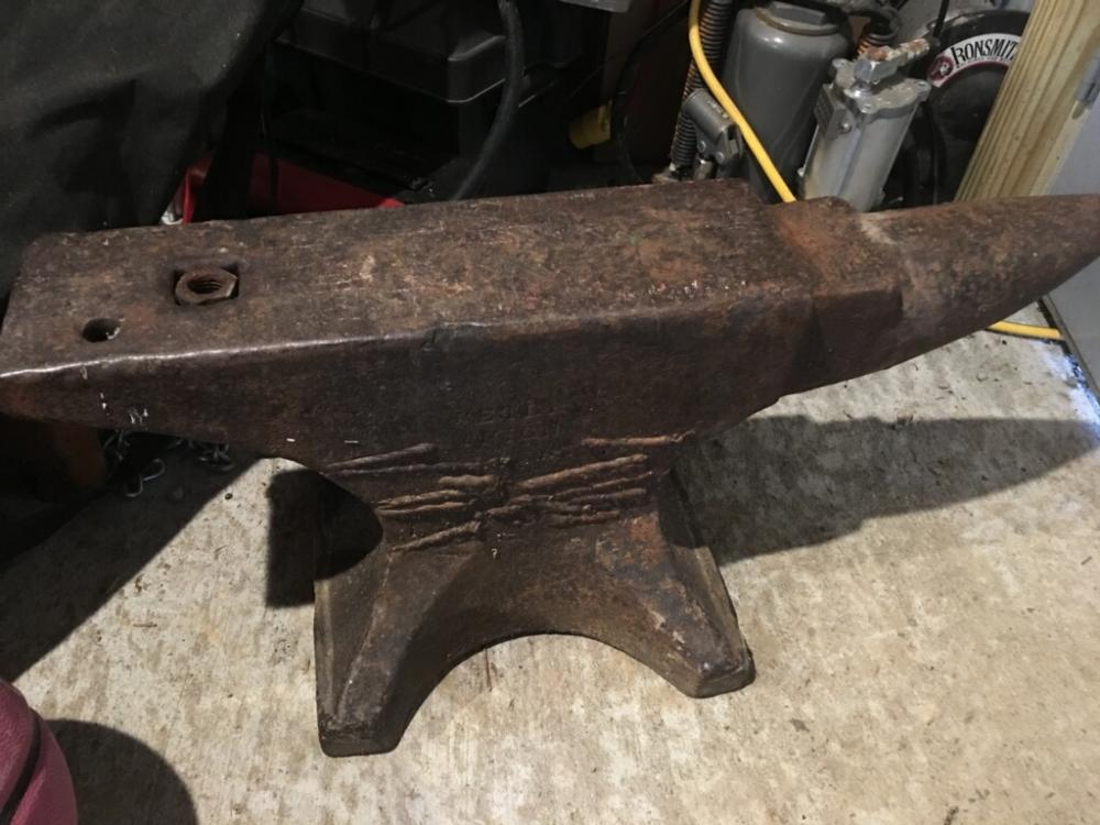

brianstucker Posted May 28, 2016 Share Posted May 28, 2016 I've had an add on Craigslist for a couple of weeks now. And I finally got a hit. It weighs 192lbs. 350$ is the minimum he will take for it. It was his grandfather's and his dad learned how to weld on it. Do you think it affected the hardness of it? Thanks in advance. Quote Link to comment Share on other sites More sharing options...
Foundryman Posted May 28, 2016 Share Posted May 28, 2016 If the welding is only on the side it won't have affected the hardness of the face of the anvil, however you can argue that the anvil is damaged and say it's reduced the value of the anvil even though the usability hasn't been affected. It looks like a good one from here, if you're in need of an anvil, I'd say go for it, though do the rebound test first just to check that the face is still good and hard! Quote Link to comment Share on other sites More sharing options...
John McPherson Posted May 28, 2016 Share Posted May 28, 2016 If it is actually 192 pounds, then it is a good deal for a face in that condition. Bring a scale with you, and be prepared to negotiate. Quote Link to comment Share on other sites More sharing options...
Crazy Ivan Posted May 28, 2016 Share Posted May 28, 2016 That is a fair price but with the welds on the sides and that bolt jammed in the hardy hole, I'd lean more in the $300 range. Make sure to check the rebound first though. Quote Link to comment Share on other sites More sharing options...

Frosty Posted May 29, 2016 Share Posted May 29, 2016 Making a counter offer is hardly "beating the bloke down on the price" In the real world it's just saying, "I'm not a sucker." And don't tell me about hard to find blacksmithing tools, around here that old beauty would've been sold before the ink dried on the craigslist add. Weld beads on the side don't mean a thing. The nut driven into the hardy might be an issue or are you good with a cutting torch? Even with one of my eyes wonky I could zip that out without warming the face. That's a good price but don't be bashful about making a counter offer in person and keep on smiling. Ever do a rebound test? A ball bearing or small ball pein hammer will tell a lot about it. I recently replaced the 3/8" ball bearing in my pocket for a 1/2" one I got in a bucket at a yard sale last summer. No need for a really big one I just find the larger ones easier to find when they take a wild bounce. Frosty The Lucky. Quote Link to comment Share on other sites More sharing options...

Frosty Posted May 30, 2016 Share Posted May 30, 2016 A rebound test is a measure of how live the anvil's face is. The harder / more live it is the more energy is returned to the work from inelastic rebound from the anvil. The shock wave from the hammer impact is conducted through the anvil till it comes to a boundary, a good weld isn't a boundary. In the case of a good solid anvil the bottom of the foot is the boundary where the sound wave reflects. There is frequency and Amplitude, the harder the face the more amplitude is retained. To test for rebound simply drop a ball bearing and estimate how far back it rebounds. You can use a scale if you like or till you develop an eye for it. 60% and up is okay, 70% is pretty decent, 80%+ is good and pushing 90% and up is excellent. We really should have the ball bearing rebound scores in a sticky, I wrote that scale from memory and I'm a TBI survivor. Using a small smooth faced hammer takes more skill to judge but it works as well and it's faster to use, you don't spend the time hunting for lost bearings. Besides rebound height you're listening and watching for dead spots / areas. An anvil with a wrought body and welded HC steel face may delaminate. Delaminated areas are not joined so it's a boundary and with say 1/2" - 3/4" of depth of rebound the bearing or hammer isn't going to bounce much and it says "thunk" rather than "tink". Do NOT get fooled by an anvil that has a nice "ring." Consistent is important but some anvils don't ring at all, a Fisher clanks at you and they're a top shelf joy. Others say a cast Swedish steel anvil will make your ears ring through muffs and plugs. I was looking at anvils in a local pawn shop, cheapo tool store and they sounded pretty darned good but flip the hammer over and give it a light rap with the ball pein and they dented. Cheap Chinese cast iron ASOs that had a ring that sounded pretty good. Frosty The Lucky. Quote Link to comment Share on other sites More sharing options...

Nobody Special Posted June 2, 2016 Share Posted June 2, 2016 192 for $350? In that shape? That's a heck of a good bargain. I'd check rebound and take him up on it. You could resell that for close to $600 here all day long, and a lot of them would be tickled pink at that price. Hate to lose it over $50. Quote Link to comment Share on other sites More sharing options...

brianstucker Posted June 7, 2016 Author Share Posted June 7, 2016 Well. I am now in possession of my first anvil. It seems to have good rebound. I ended up giving 350$ for it. It's definitely 192+ anvil. Quote Link to comment Share on other sites More sharing options...

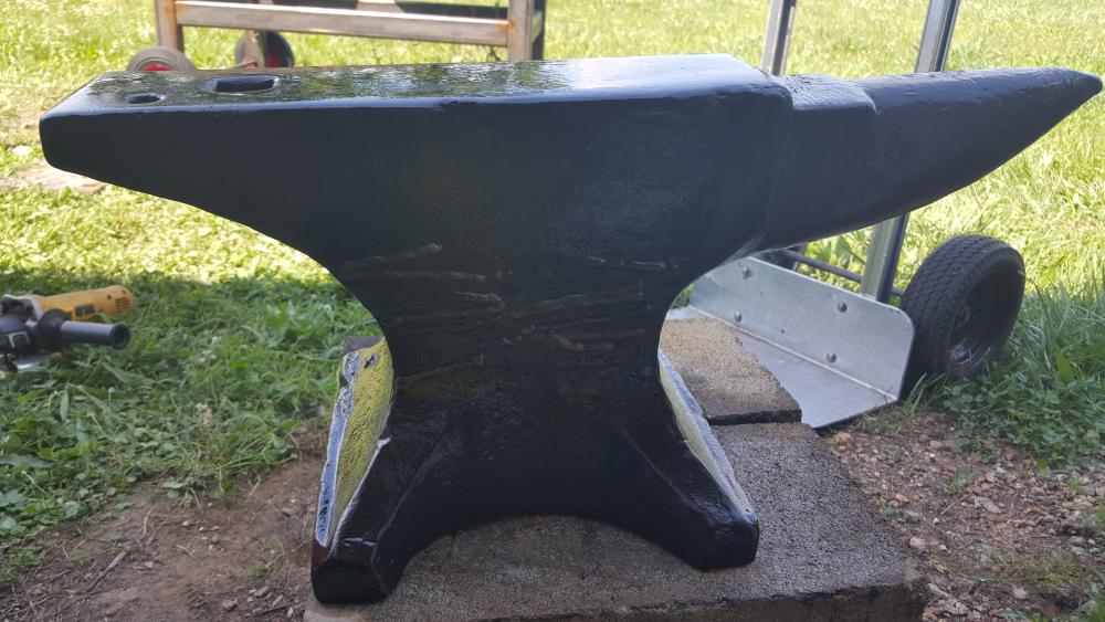

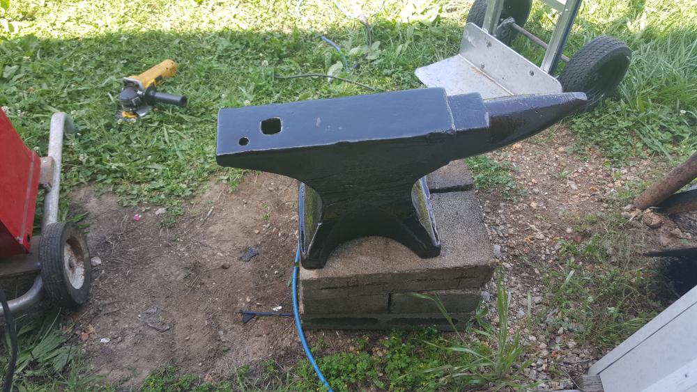

brianstucker Posted June 11, 2016 Author Share Posted June 11, 2016 Should I grind these welds off? Quote Link to comment Share on other sites More sharing options...
Charles R. Stevens Posted June 11, 2016 Share Posted June 11, 2016 They arnt hurting anything at this point, if some time in the future you need to use the waist of your anvil as a working serface I would address it then. Quote Link to comment Share on other sites More sharing options...
Mark Ling Posted June 11, 2016 Share Posted June 11, 2016 did you paint it? Littleblacksmith Quote Link to comment Share on other sites More sharing options...
