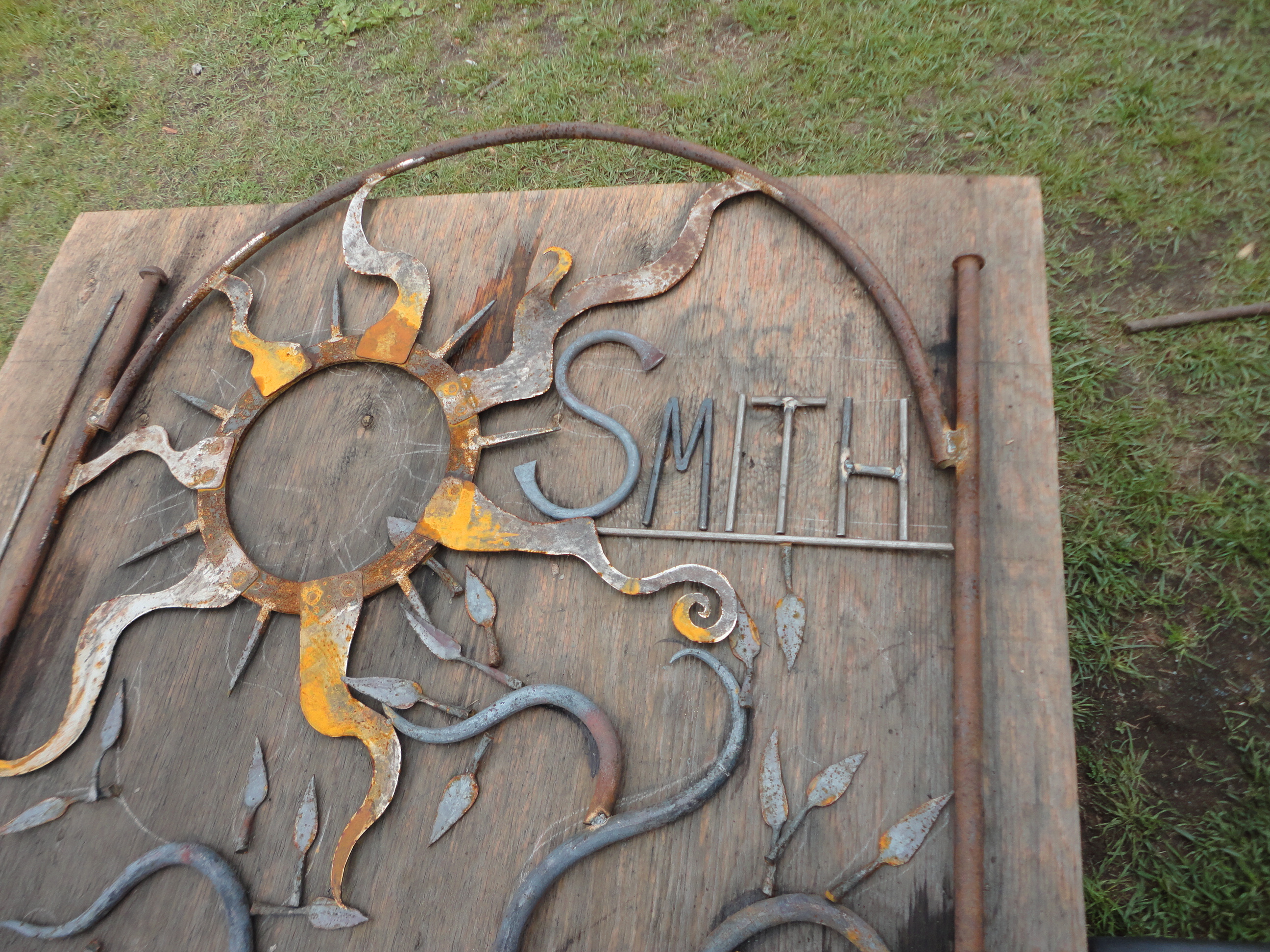

Slowly sneaking up on it.  Not sure that I will have it done by June 7th,  but we will see.  Was hoping to be a little further along but had company for the long weekend and all sorts of rain.  Need to check out the steel rack at work and see what there is for 1/8 x 1" strapping to simplify bullrush leaves.  Otherwise start flattening a bunch of 1/2 round.  Hmmm...  looking at the one picture I may have to spread the 'M' a little wider.

A sleepless night and a super hot day kind of robbed me of my mojo.  Managed to get all the leaves I had made on and more or less bent into place.  Forged another seven leaves to fill in a few spots that are short on foliage.  Just one big hole down in the lower left hand corner that needs a bunch of TLC.DSC02707.thumb.JPG.ad0a784e1b38b4af99926DSC02708.thumb.JPG.308ed09a884edede02d41DSC02709.thumb.JPG.c0dfb0df05ad342ba7e7c
Weld a few leaves on the tree, forge out another bullrush leaf or two, a dragonfly some sort of handle and sort out some hinges. Pretty happy with the bottom left hand corner so far.  Guess I better get back out there and keep moving forward.

Dragonfly nearly done, bulrushes all in place.  A few extra leaves added.  The 'H' is going to be cut out and redone right.  It's realy starting to bug me.  A few adjustments on the one basket twist to match the other and sort out how they are going to be attached then onto clean up and paint.

Was contemplating a snail or maybe a small bird and a rolled up copper wire birds nest.  I'll have to see. Wife figured stick an owl in someplace.  Was thinking of basket twist on each side for handles.  Might go with a push plate on the push side and a twist on the outside.  Spring loaded to close.   Not sure how ambitious I'm going to get with hinges.  I know I should do something a little fancier than just standard heavy hinges.   Anyways this is where it will be going .

Nice heavy pintle hinges but make the top one pin down so a bad guy can't just lift the gate off the hinges. A threaded or wedged through bolt makes servicing a not major chore. It'd be easy to fit it in with the gate's theme. Of course strap hinges could fit in easily and be pretty flashy. Say a dragon or butter fly perched on the post and it's hinged wings on the gate?
