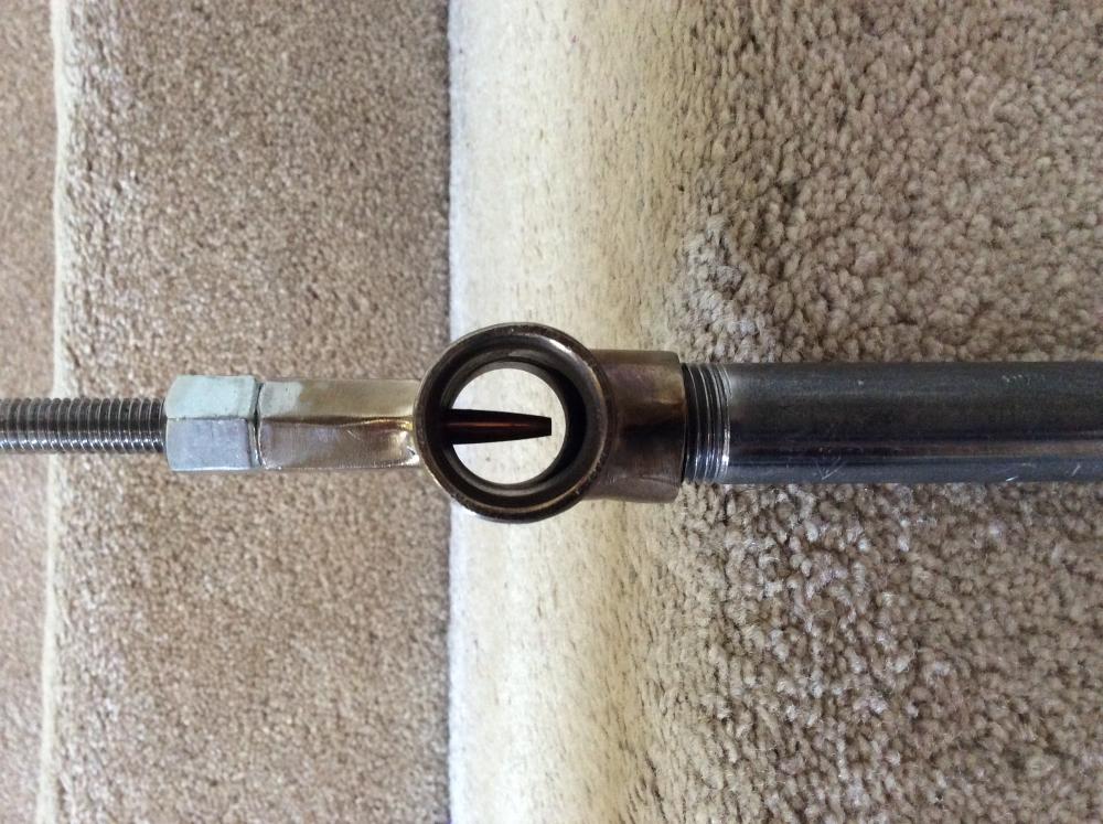

Frosty Posted June 2, 2016 Share Posted June 2, 2016 I agree with your thoughts about the thread protector's threads not interfering with the flow. In fact, back when I had my lathe hooked up and was tinkering with the things more I cleaned the threads out of a thread protector and it didn't work as well by quite a bit. Here's a couple brainstorm ideas: Cast refractory is good, we could make a dimpled core from rubber and inflatable. It would index into the outer mold at the jet end, using a high temp high alumina water setting refractory sifted free of aggregate as the cast. Once set and cured simply let the air out of the core and mold and strip them. Or here's another bit of brain storm, maybe brain squall. Braze ball bearings to a spring steel bic. Heat the burner tube in the forge and use a clapper on the outside while rotating it over the bic. Last and least fun brain storm. Buy a small dia, carbide or diamond spherical burr and grind dimples into the tube. Cutting threads in the tube would be an option worth experimenting with, depth and pitch would no doubt matter. Then there are different shape threads, "rope" threads for example. A person could also broach the tube for an interrupted screw. Picture rope thread and half round broach which may come close to being dimpled. Frosty The Lucky. Quote Link to comment Share on other sites More sharing options...
Charles R. Stevens Posted June 2, 2016 Share Posted June 2, 2016 Have you tried cutting out the threads in the "T", Jerry? Quote Link to comment Share on other sites More sharing options...
Frosty Posted June 2, 2016 Share Posted June 2, 2016 Yeah, easy greasy but about the same effect as moving up 25% dia. That's exactly how I went from using a 3/4" T and 0.030" mig tip jets. up to 3/4" x 1" T and 0.035" jet. I cut the threads out of a 3/4" T and built one, needed to increase the jet dia. to tune the flame. Then I took a pair of calipers to the Ts and tried the next one with a 3//4" x 1" and that's how I make them now. Frosty The Lucky. Quote Link to comment Share on other sites More sharing options...
Frozenforge Posted June 2, 2016 Share Posted June 2, 2016 I have a 1/2 Experimental T burner that I bored out the threads, cleaned and smooth it all out. I have the mig tip screwed into a threaded tube to enable easy adjustment. It has a nozzle comprised of 3/4" as the step to 1" pipe. Tried a .025 mig tip. Best way to describe is that it has too much velocity?? so it will only run between 3 and 5 psi. Anything above 5 blows the flame out unless I choke off over half the air. Moving the mig tip in or out seem to have a limited effect on the mixture. Sorry I don't have a picture of the flame but it is well centered and has a nice form at the lower pressures. Have not had much time to experiment with it much more lately. Quote Link to comment Share on other sites More sharing options...
Charles R. Stevens Posted June 2, 2016 Share Posted June 2, 2016 So then taking the treads out had the same effect as going up a 1/4" in pipe size, so no real gain or loss? Quote Link to comment Share on other sites More sharing options...
Frozenforge Posted June 2, 2016 Share Posted June 2, 2016 Hard to say, I wouls say yes on the air side anyway. I knew I was making too many changes at once but I figured what the heck? My thought was that if the propane velocity is high enough to really pull alot of air in with it then you could have a tighter forge and decrease the heat loss. Quote Link to comment Share on other sites More sharing options...
Frosty Posted June 2, 2016 Share Posted June 2, 2016 Yes, exactly Charles it may have been a little better but not appreciably and not worth the work. You're using too small a jet, use a 0.035" mig tip. and no need for the pointy ones, the blunt ones don't interfere with air intake as it's hitting it from the sides. The idea of making a LOT of heat in a forge is putting as much fuel air mix in the chamber as possible at the same time. This entails a couple things but mostly you want as large a jet as possible that will induce enough intake air for clean combustion at a velocity just high enough above the mixture's rate of propagation as possible. It needs to be enough faster to cool the nozzle and prevent it from getting hot enough to pre ignite the mix in the tube. You're reply just showed up. It's a good thought unfortunately NA burners are pretty susceptible to back pressure and while you can use smaller jets at higher pressure to offset it some it's still blowing the heat right through the forge. You MUST exhaust the combustion gasses and even a gun burner won't work all that well into a high pressure environment. I'm thinking of trying to use larger jets in mine see if I can slow the flame down. You've seen my shop forge haven't you? I've brought it to meetings until recently. It's shooting 6" of dragon's breath out the opening to make welding heat. Listening to Mike has me wanting to slow it down till it starts burning back then speed it up a touch. Frosty The Lucky. Quote Link to comment Share on other sites More sharing options...
