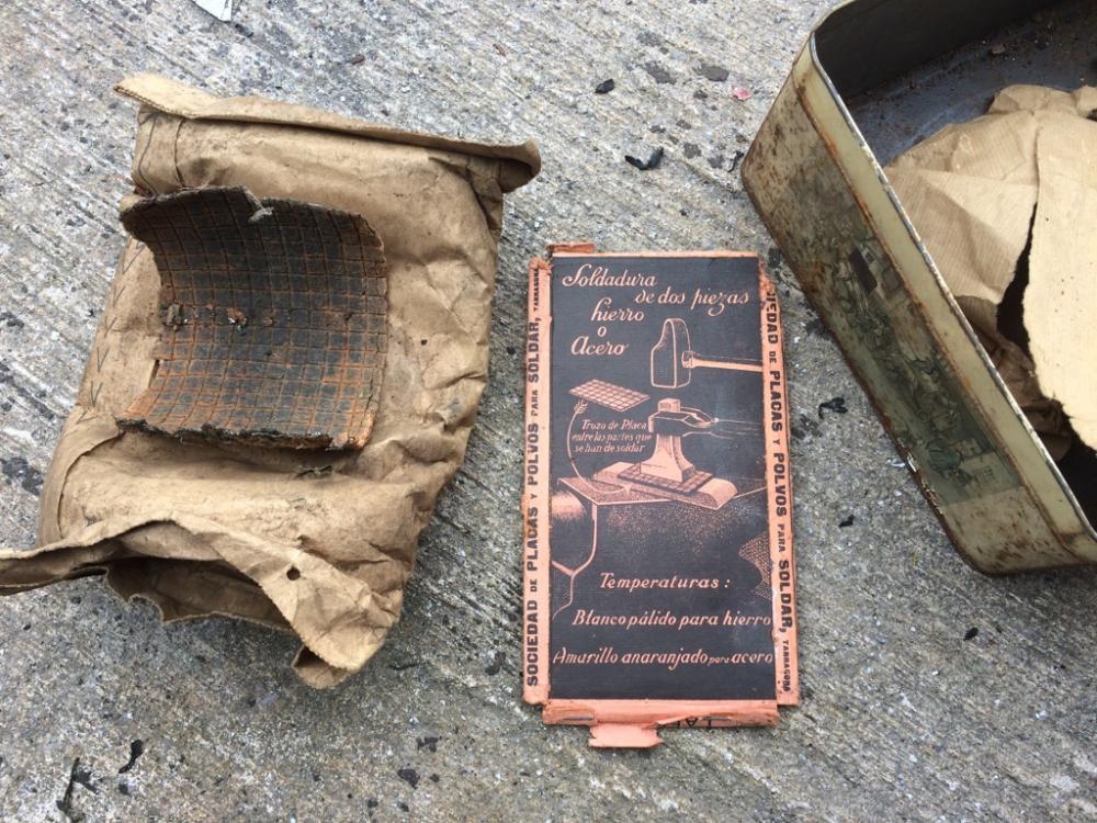

What is this?
As KRS states it was a form of flux, a propriatory brand that was popular up until the late fifties early sixties,(when wrought iron was still available) especially useful when putting working faces on to tools eg hammer faces, lathe, milling and other tools. It could be cut to shape to suit the application,
It was the "magic compound" of the day for forge welding steel to wrought iron, it would be interesting to see a chemical analysis of what you have there.
I've often heard it mentioned by the old time mentors, (with some cheaper alternatives also) but that is the first time I have seen that particular package.
Does it mention country of origin?
A great little nugget of the smithing history, I wonder how many more examples survive.?

Sheets of flux compound would actually be pretty handy.  Everything I use straight borax, or see someone doing it, there's a ton of waste as it's spooned onto the steel.  Of course, as cheap as borax is, waste really isn't an issue.
Thanks for the info all. If you want to swing by you can have a sheet John.

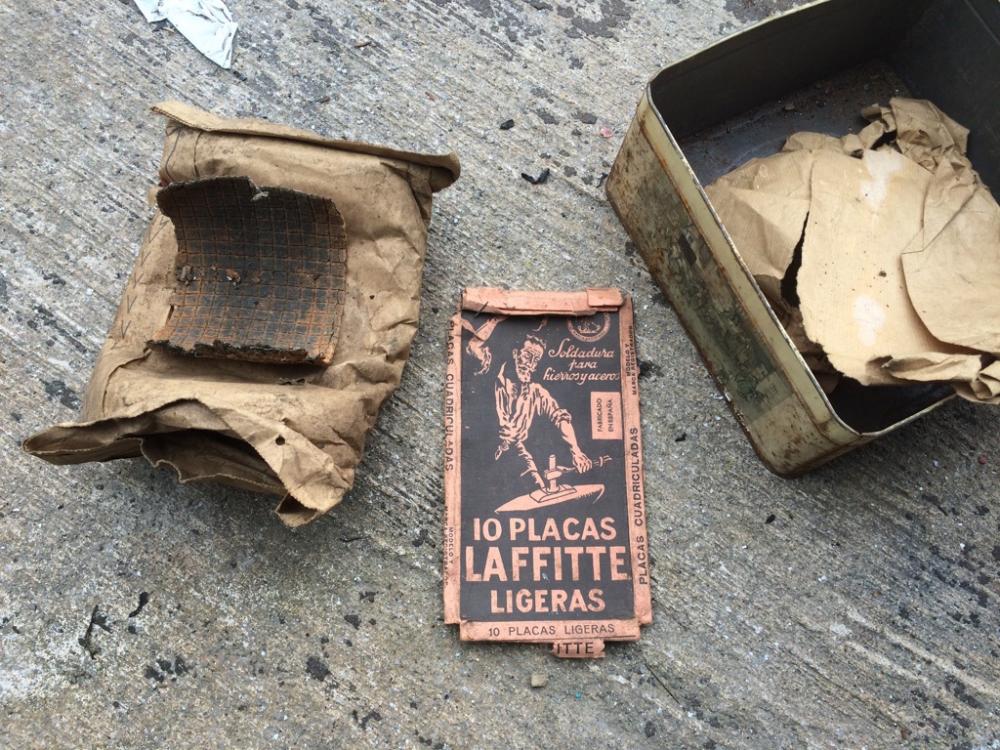

Since I'm a native Spanish speaker, I'll do my best here:
-Front (lower photo, with the blacksmith):
Welding iron and steels.
Made in Spain (in the little white box)
10 light sheets/plates "Laffitte" (the brand) (The same is repeated in the lower edge)
-Sides:
Gridded sheets. Registered brand and model.
-Back (the first photo, with the anvil):
Welding 2 pieces of Iron or Steel
A piece of sheet between the parts to be welded
Temperatures:
Pale white for Iron
Orange-yellow for steel
-Sides:
Society of welding powders and sheets, Tarragona (a city in Spain, also the name of this particular company)
(PS: Is it "gridded" when something is marked/divided in squares?)
That looks familiar.
Alan Knight, the blacksmith I trained with, used to have some of those "gridded" pre-scored sheets in a not dissimilar biscuit tin. The tin beside it contained silver sand. He used the sheets for specials like leaf and flower welding.
I wonder if the RIB / CoSiRA flower expert Zanni promoted its use when training smiths in the finer points?
Alan
  • 6 months later...
I did my master course with the late Freddy Haberman out in Italy and he had some of this Lafitte plate.  I was allowed a few pieces to play with. it was easy to cut off squares with a pair of shears. i used it for welding shut a flat ring. a piece was popped between the two overlapping scarfed ends and brought to a mild welding heat. worked a charm. dont remember what i did with the other bit but i had a good look at it. pinkish colour, hardish material (bent slightly) molded into flattened square impressed slab encapsulating the pure iron mesh. my feeling is indeed that the pure iron mesh is the key ingredient. I do wish someone could make it again.
