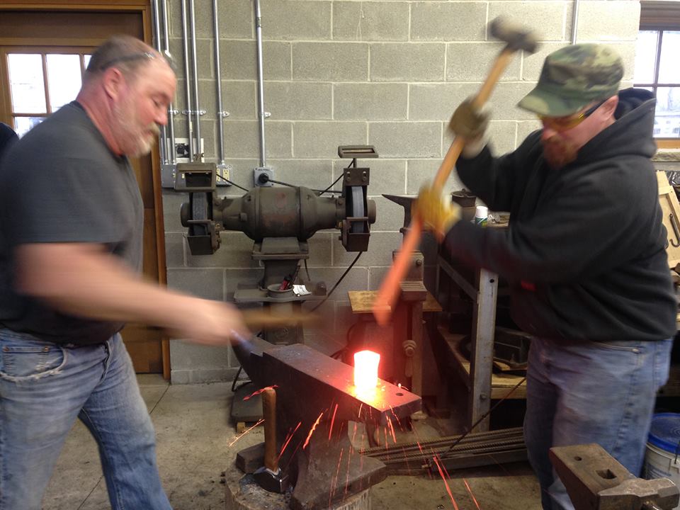

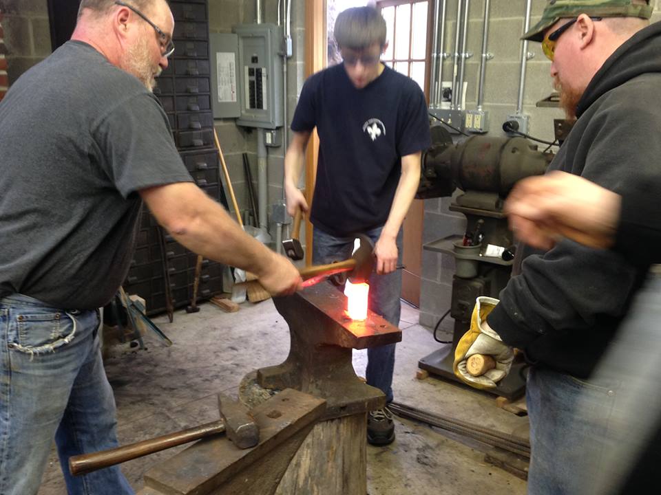

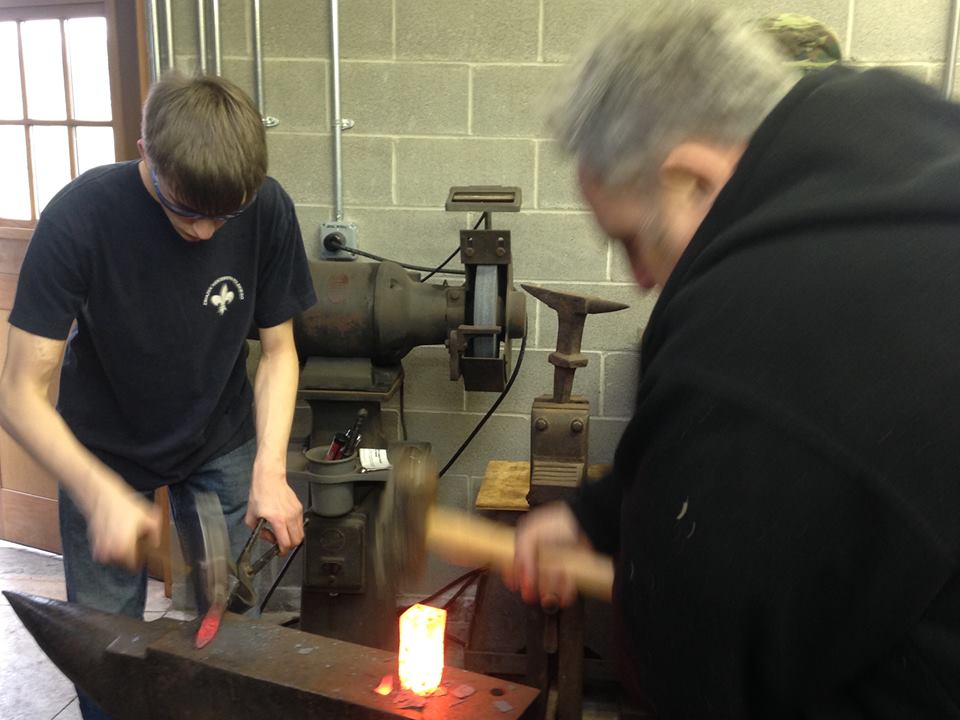

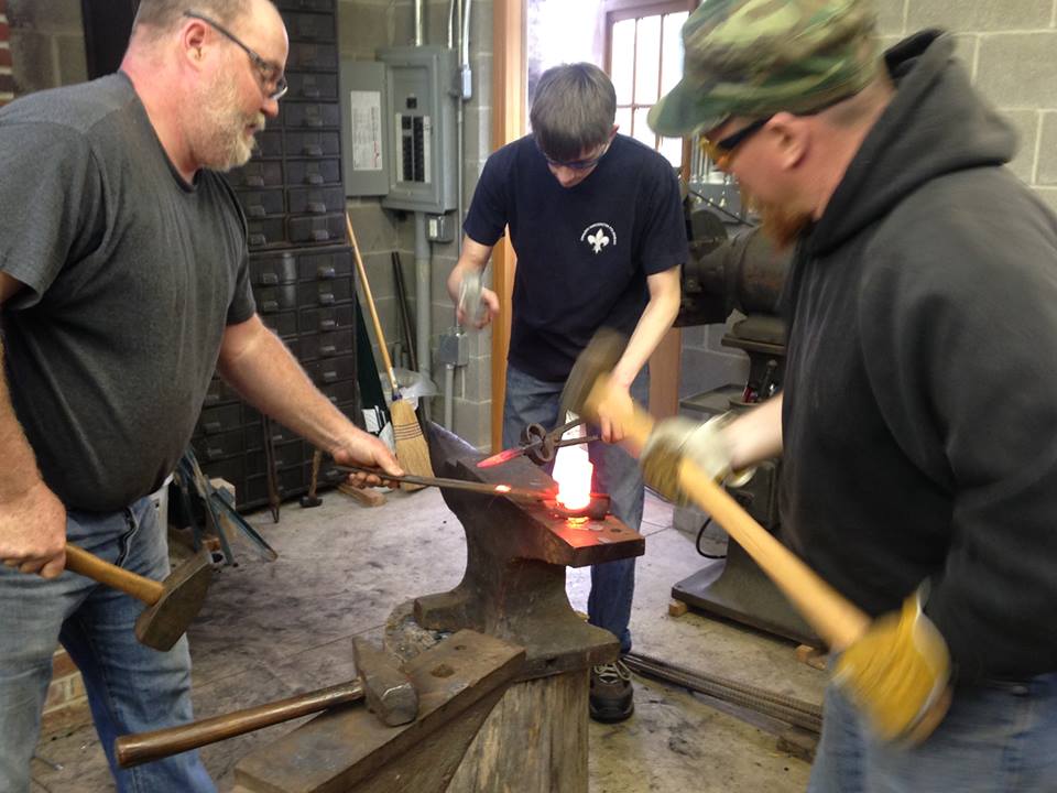

We had a meeting yesterday of the Philadelphia Blacksmiths Guild, in which I showed people how to forge hardies.  The meeting took place at the shop o hwned by Lincoln Wolfe at his Hay Budden Museum.  The anvil we used was a 330 pound Hay Budden, sporting a 1 3/8" hardy hole.  All five anvils in my shop have 1 3/8"  hardy holes, because I HATE making excess tools for five different hardy hole sizes.  The Guild member needed a hardy to fit his identical 1 3/8 hardy on his own personal anvil.
With the hot shank dropped into the hardy hole at a yellow heat, using a humongous axle shaft as stock, we upset the shoulder using ten pound sledges.  The INSTANT the tool cooled down to orange heat, we removed it from the hardy hole to reheat.  Why?????  Because it is catastrophic to get the shank stuck in the hot hardy hole, so it gets removed from the BOTTOM OF THE HARDY HOLE to be reheated, using a punch from UNDERNEATH.  If you do not remove the shank thusly, you risk busting the heel off your anvil.  Reheat, and upset again, until you have a pronounced shoulder on your tool!pbg3-16action2.jpg.f483028a8ccde17c18325pbg3-16action3.jpg.07813adf4a11b2f8ca7bdpbg3-16action4.jpg.3369d99ebfaf58211f44bpbg3-16action5.jpg.b4eddd1da1b558837a3b4

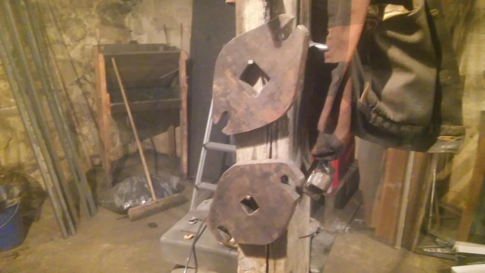

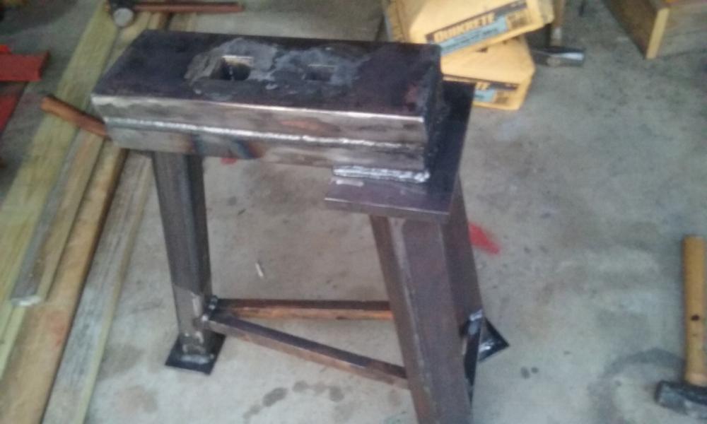

I like my striking anvil for upsetting hardies. It's two layers of forklift tine welded together 4140 steel. Does a wonderful job and has two size hardy holes to choose from . I welded in tubes in this case because I didn't have anybody to waterjet the holes for a good price.
that's a first, Ive never seen one with two hardy hole sizes. very smart, especially if you have two different anvils with two different sized hardy holes.
                                                                                                   Littleblacksmith
  • 2 weeks later...
Lots of good ideas here to avoid breaking the heel off of your anvil. I will be making one of these soon. I have a 2' piece of 2" sch 160 pipe with a 1500 ansi flange welded on the end used it already to upset the face of a flatter out of 1 1/2" pump shaft should be able to mount a hardie hole plate on top of that. Like the forklift fork idea. You could probably blow a hole in that with a torch, would ruin the temper but still be a lot tougher than mild steel, is that what you did forgeman32 to fit  the square tubing through? If I can find a fork that is.
