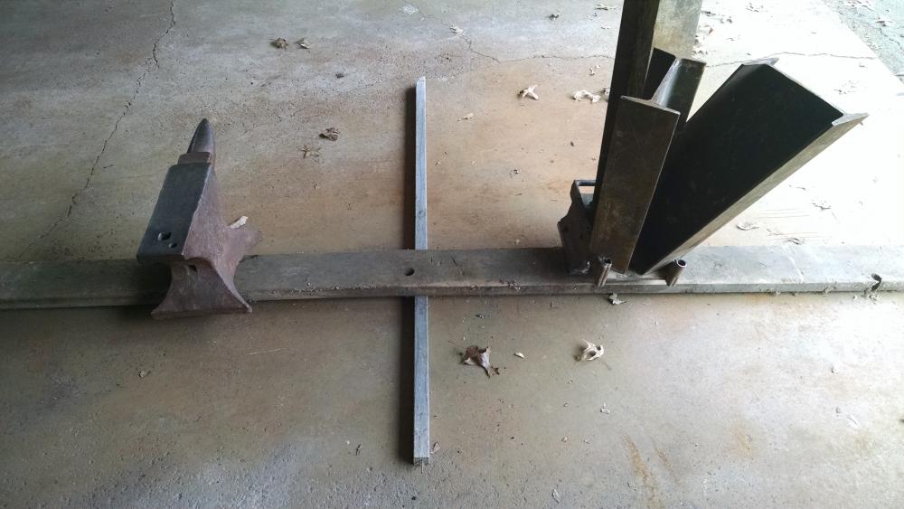

Glenn Posted March 6, 2016 Share Posted March 6, 2016 Let us say you are thinking about buying an anvil but do not know the weight. Put the anvil on a board (say 2x6 for strength) and place a fulcrum (piece of pipe) under the board. Measure center of the anvil to the center of the fulcrum which is say 3 feet. You know the weight of a blacksmith to be 150 pounds. (ok, he has missed a couple of meals for sure). The blacksmith has to stand 6 feet sway from the fulcrum for the teeter-totter to balance. That means 150 pounds times 6 feet equals 900. Move the anvil side distance to the blacksmith side of the equation and divide it into the 900, or 900 divided by 3, which should be a 300 pound anvil. No wonder you could not lift the thing by yourself (grin) Quote Link to comment Share on other sites More sharing options...
Frosty Posted March 7, 2016 Share Posted March 7, 2016 It's easier to calculate than that Glenn, simply divide or invert and multiply. Say the balance point is 2' from the fulcrum and the smith is 4'. 2/4=1/2, the smith weighs half as much as the anvil 300lbs. OR invert and multiply smith = 150 x 2 = 300. It's the same way you figure gear ratios and is in fact exactly the same, a gear being a lever that goes all the way around. Frosty The Lucky. Quote Link to comment Share on other sites More sharing options...

ThomasPowers Posted March 8, 2016 Share Posted March 8, 2016 Must be a typo Steel is zero pounds per sq foot as a square foot is 0 in thickness; and so 12x12x0 x density per CUBIC inch is of course zero. I would just do a simple ratio using a simple fulcrum say 1' between anvil and fulcrum and then you find how far out you have to stand to balance it; Not being 150 lbs I figure a 6' piece of 2x12 would handle *anything* I was likely to run into and a piece of angle iron with the legs down would make a decent fulcrum. Quote Link to comment Share on other sites More sharing options...

JHCC Posted March 23, 2016 Share Posted March 23, 2016 Well, the fulcrum method tells me that the new anvil stand weighs about the same as the anvil itself, which is marked 1*1*8 for 148 lbs. Thanks for the tip! Quote Link to comment Share on other sites More sharing options...
