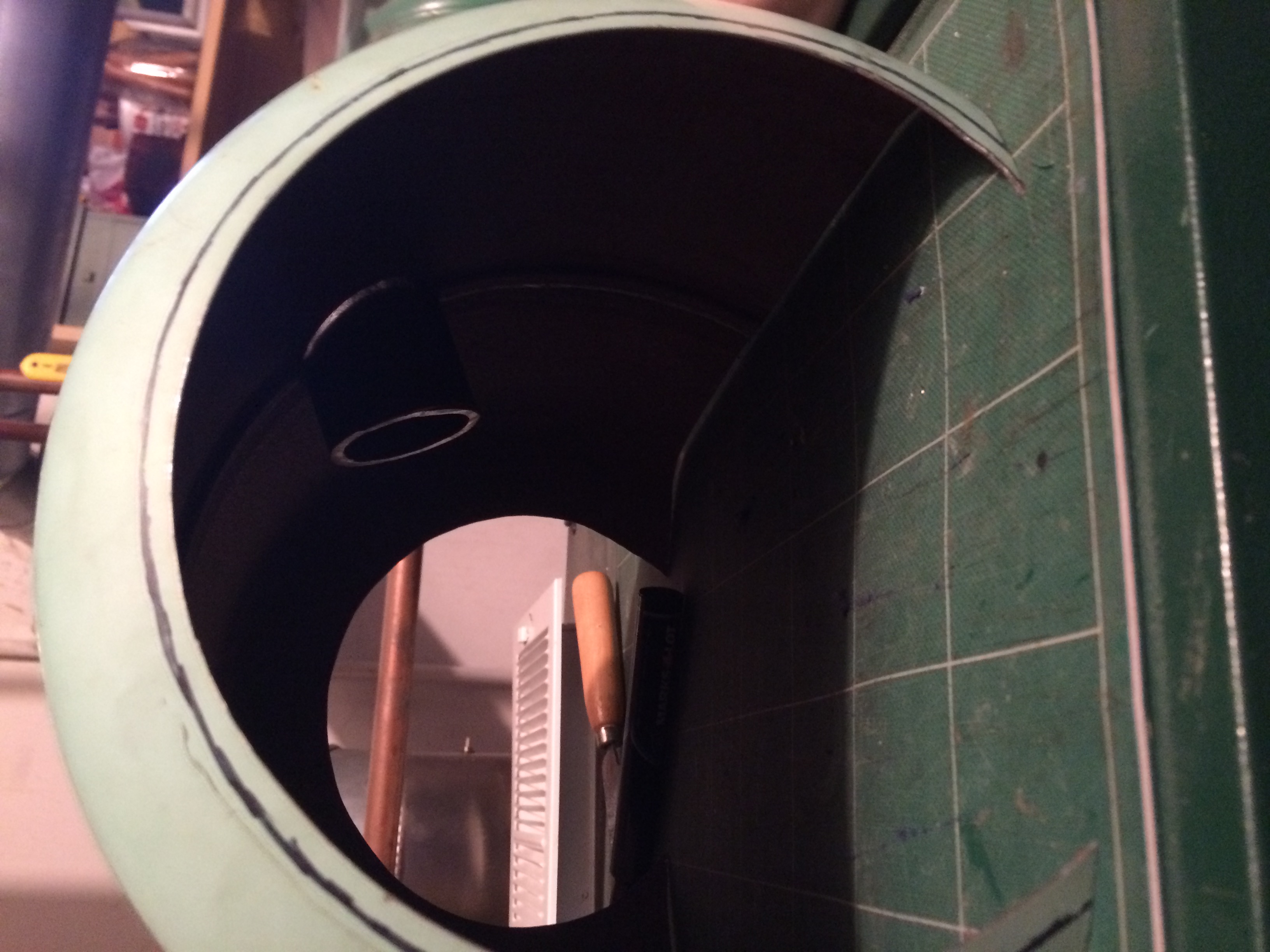

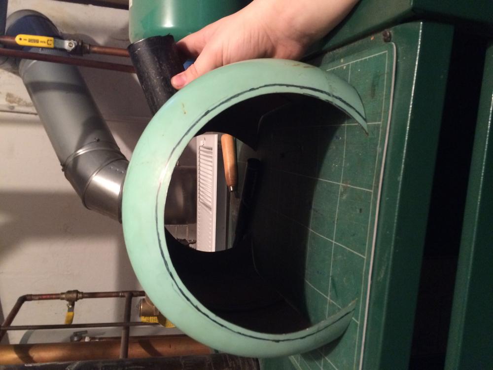

Forging Carver Posted February 27, 2016 Share Posted February 27, 2016 Well I finally started! This forge is going to be built from Wayne Coes plans. So I basically cut the d shape doors and cut the tank in half. You put it back together with door hinges so that it makes casting easier, and gives you the ability to pop out the pins of the hinges and then prop up the top of the forge with firebricks if more space is needed. The lines I cut weren't too straight since I was using a a handheld jig saw. We did draw out lines though. It also must have bent a little so it didn't line up properly, but I rebent it back and there's just a little gap. All that really matters though is that I get the casting level. So now what I need to do is cut the hole for the burner, which I am still debating which method to do. Then I got to get a handle, the hinges, and the burner mount welded to it. After that I need to line it and then make a stand. I will post pictures of that too. I am hoping to get this done before my spring break which is March 26, so that I can have a whole week of just forging. Tell me what you think! Quote Link to comment Share on other sites More sharing options...
WayneCoeArtistBlacksmith Posted February 28, 2016 Share Posted February 28, 2016 Matt, I think that your horizontal cuts are just fine. You are well on your way. Quote Link to comment Share on other sites More sharing options...
Everything Mac Posted February 28, 2016 Share Posted February 28, 2016 I'm sat there thinking "Freon" that's interesting. Looking good mate. Best of luck with the build. Andy Quote Link to comment Share on other sites More sharing options...
Frosty Posted February 28, 2016 Share Posted February 28, 2016 So far so good. Keep us posted please. We love pics you know. Frosty The Lucky. Quote Link to comment Share on other sites More sharing options...
Forging Carver Posted February 28, 2016 Author Share Posted February 28, 2016 Alright thank you! Frosty so you know how I was asking how I should cut the hole to make my burner at an angle. Well it turns out that Wayne told me that I just need to cut a regular hole, and since freon tanks are thin, I can just bend the mount to the angle I want. I will probobly cut that hole today. Thank you all very the help. Quote Link to comment Share on other sites More sharing options...
Frosty Posted February 28, 2016 Share Posted February 28, 2016 Ayup, freon tanks are thin they don't have to hold as much pressure as propane tanks. I didn't think of that, I've never messed with a freon tank but the logic is pretty straight forward. The info is in the book now. Frosty The Lucky. Quote Link to comment Share on other sites More sharing options...

Forging Carver Posted March 6, 2016 Author Share Posted March 6, 2016 Ok, I am getting my forge welded tommorow. Just wanted to make sure that how my burner mount will be welded is correct. My concerns are that it is at the wrong angle and that it enters the forge too much. Please let me know. Thanks The pictures uploaded crooked, but if you click the image it should show it straight Quote Link to comment Share on other sites More sharing options...
Forging Carver Posted March 7, 2016 Author Share Posted March 7, 2016 For some reason I am thinking that the burner tube should patrude little if at all into the forge. I think after school today I am going to cut about a third of the pipe off and then drill and tap some screw holes. To me, I guess the angle isnt too bad, but maybe should be a little bit more angled. Quote Link to comment Share on other sites More sharing options...
Buzzkill Posted March 7, 2016 Share Posted March 7, 2016 Just remember you are going to have 2 inches of blanket plus some coating between the shell and the inside of your forge. I believe the common recommendation is to keep the end of the burner tube back about an inch from the inside of the forge. It's still going to get glowing hot at the tip and eventually have to be replaced, but it's protected somewhat by the blanket and hot face material if you set it back a bit. The angle is mostly a personal preference thing. You'll see everything from the flames pointing straight down at the floor to tangential burner orientation for maximum swirl effect. Frankly I don't know if there's a huge difference in efficiency although it seems a lot of people suggest the swirl is better. If you want a small hot spot then the flame aimed at your piece will provide that, but direct flame contact with your steel can produce excess scaling, especially if you have an oxidizing flame running. If you are referring instead to the burner mounting tube then that should be welded to the outside and does not need to extend into the shell at all. Quote Link to comment Share on other sites More sharing options...
