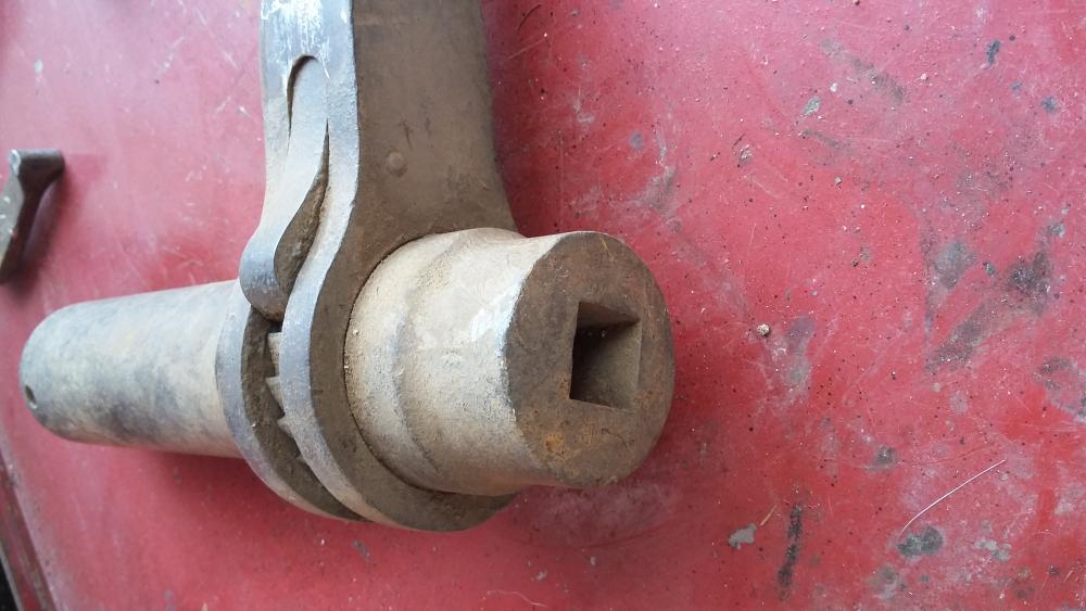

Ironman916 Posted February 9, 2016 Share Posted February 9, 2016 I picked up this tool, along with some pipe threading tools, not sure what it is... Quote Link to comment Share on other sites More sharing options...

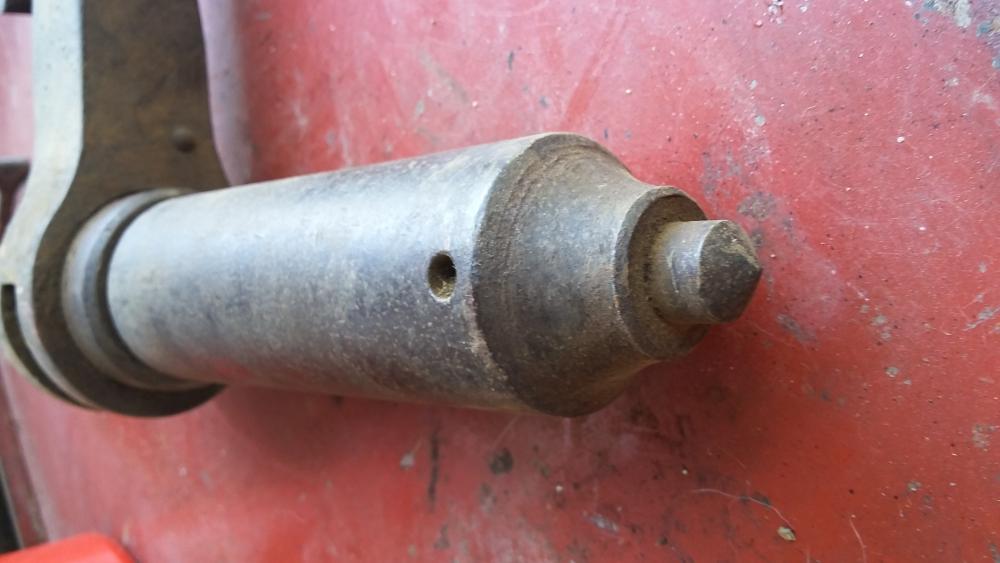

Daswulf Posted February 9, 2016 Share Posted February 9, 2016 It's a ratchet of some sort. Might help if you get pictures of the parts on the top, like if there is an opening on the shorter part at the ratcheting part. Is it threaded inside? Quote Link to comment Share on other sites More sharing options...

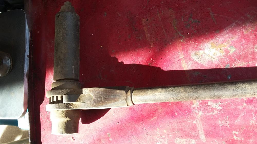

Dave Budd Posted February 9, 2016 Share Posted February 9, 2016 I think it's a drill Think a bit and brace combined with a beam drill. Quote Link to comment Share on other sites More sharing options...
Smoggy Posted February 9, 2016 Share Posted February 9, 2016 It is what I've come to know as a blacksmiths drill, but I could see it being used to good effect by a boilermaker needing rivet holes in plates or a joiner on timber. Google "Keystone reversible racket" It would have been used with a clamp of some description. Quote Link to comment Share on other sites More sharing options...
Kozzy Posted February 9, 2016 Share Posted February 9, 2016 "ratchet drill" Those holes in the extension should be for a pin to turn the "feed screw" portion which should extend.Might be long jammed but a good soaking will probably allow it to move again. Quote Link to comment Share on other sites More sharing options...

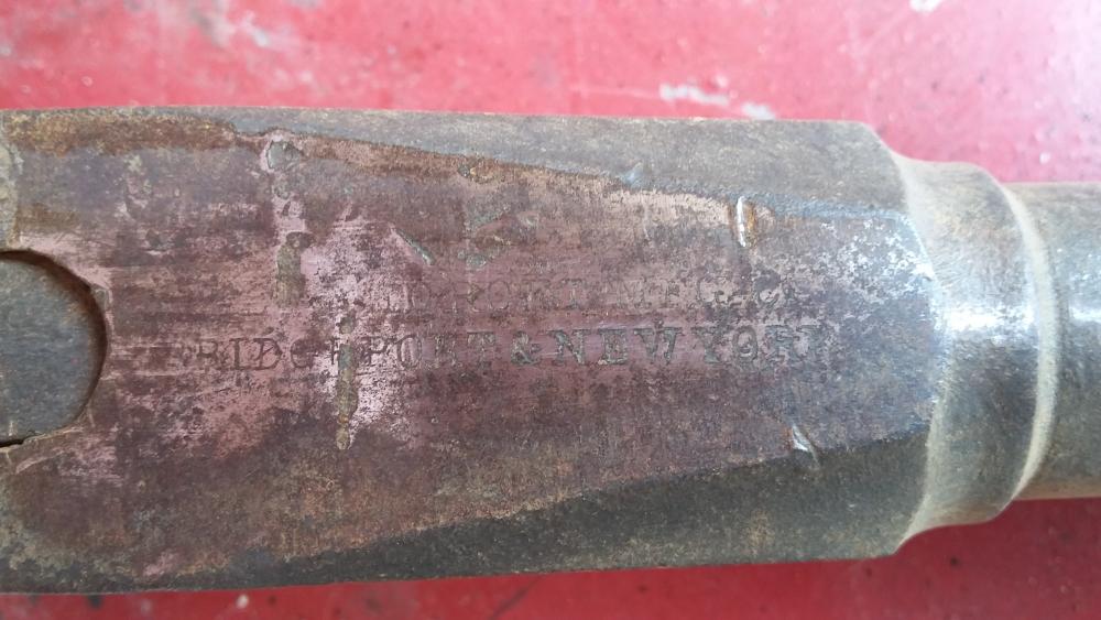

Ironman916 Posted February 9, 2016 Author Share Posted February 9, 2016 Thank you so much! Learn something new every day. It appears to be made by ASHCROFT MFG CO. Bridgeport, CT & New York Quote Link to comment Share on other sites More sharing options...

John B Posted February 9, 2016 Share Posted February 9, 2016 Also used to drill between joists or ribs and other confined spaces. Quote Link to comment Share on other sites More sharing options...
Ironman916 Posted February 9, 2016 Author Share Posted February 9, 2016 52 minutes ago, Kozzy said: "ratchet drill" Those holes in the extension should be for a pin to turn the "feed screw" portion which should extend.Might be long jammed but a good soaking will probably allow it to move again. It loosened right up, still had a little grease inside. Thanks for the info! Quote Link to comment Share on other sites More sharing options...

LawnJockey Posted February 10, 2016 Share Posted February 10, 2016 That tool looks perfect for drilling through joists overhead for piping. It would sure beat getting wacked in the side of the head with a hole hawg. If I understand the feed mechanism correctly it would put pressure against the next joist and thus eliminate the need for force being applied by the operator. In regards to the square taper Lee Valley Tool sells some taper adaptors that might be able to be used. I have a couple I got from them that I use in my brace and bits. Also you could get a chuck set up for a Morse Taper, take it apart and forge it to the apporpriate square taper. If you want to try that I have such a Morse Taper chuck from a mini lathe that was stolen I would be happy to send you. Quote Link to comment Share on other sites More sharing options...
