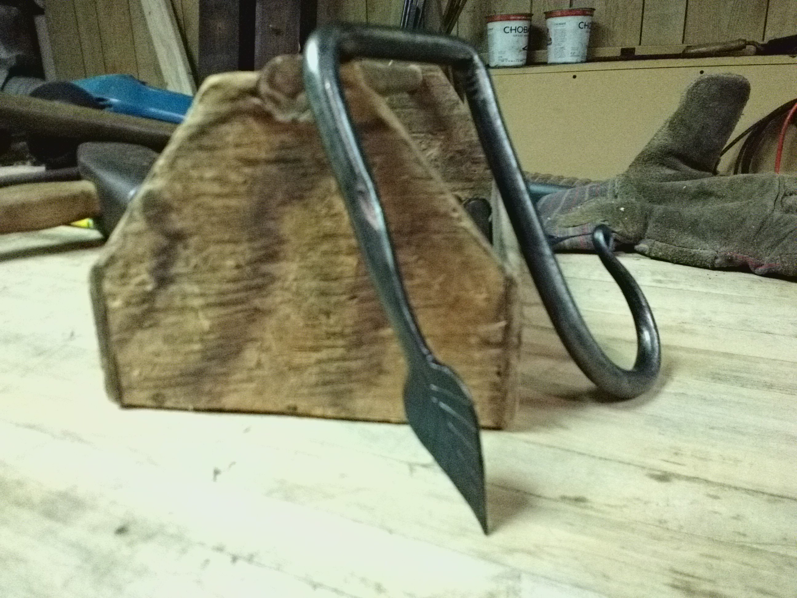

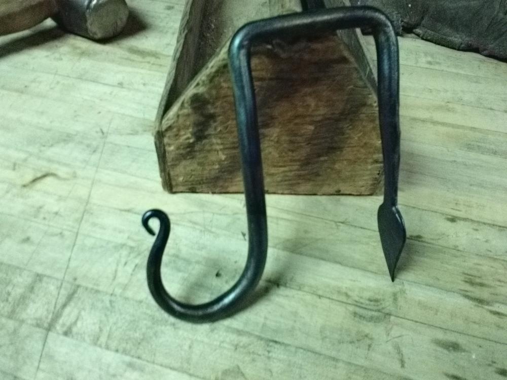

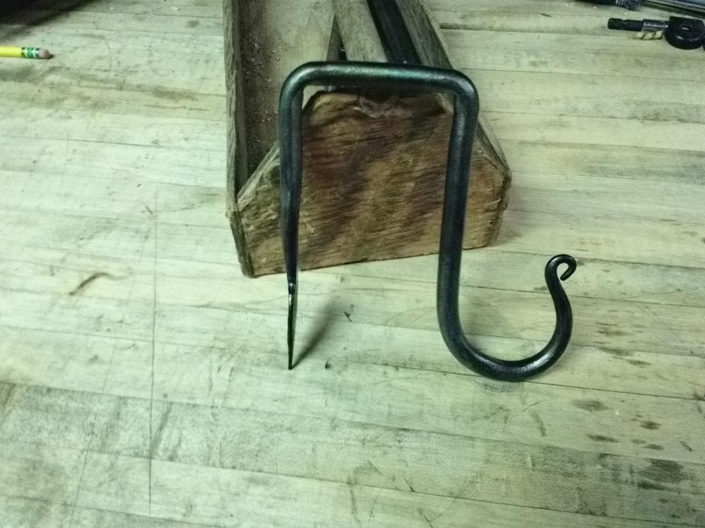

BryanL Posted March 22, 2016 Share Posted March 22, 2016 At my work some people have these plastic coat hooks that hang on the cube wall and look all dinky. My cube mate needed a coat hook so I measured the wall thickness and made this to hang over the wall. Pretty happy with how it came out. The leaf decoration will be presented towards the hall where everyone can get jealous. Quote Link to comment Share on other sites More sharing options...
Mark Ling Posted March 22, 2016 Share Posted March 22, 2016 53 minutes ago, joe elliott said: Thanks guys the money is about right ... I can make about 10 an hour and they can with stand the retail mark-up (x2). I really don't do much of this kind of production work but when I do I enjoy. Some of the whimsical of the steer head comes when fullering down the horns as it turns the brows downward.. a concerned look. I use the swage die for tapering and isolating the mass were needed so there is zero flashing (hate grinding).... other dies are for double dople with center punches marked, ramp for scroll end and forming fig with a hook placed in it so you can see how i use the back plate for straightening. did you make the dies? if so would you mind sharing? thanks! 7 minutes ago, BryanL said: The leaf decoration will be presented towards the hall where everyone can get jealous you might be getting some orders in from other co-workers! good job showing them that blacksmithing is still alive and that we don't only shoe horses! Littleblacksmith Quote Link to comment Share on other sites More sharing options...
beammeupscotty Posted March 22, 2016 Share Posted March 22, 2016 3 hours ago, BryanL said: At my work some people have these plastic coat hooks that hang on the cube wall and look all dinky. My cube mate needed a coat hook so I measured the wall thickness and made this to hang over the wall. Pretty happy with how it came out. The leaf decoration will be presented towards the hall where everyone can get jealous. I think that could be a salable concept in an urban market. I'm in the S.F. Bay Area and with all the tech workers around here, something like this might appeal to them. I think I will borrow your idea and make up a few samples to offer for sale. Hope you don't mind. Quote Link to comment Share on other sites More sharing options...
BryanL Posted March 23, 2016 Share Posted March 23, 2016 not at all. all my projects until this have been taught to me or I copied them. Flattered to have this borrowed Quote Link to comment Share on other sites More sharing options...
